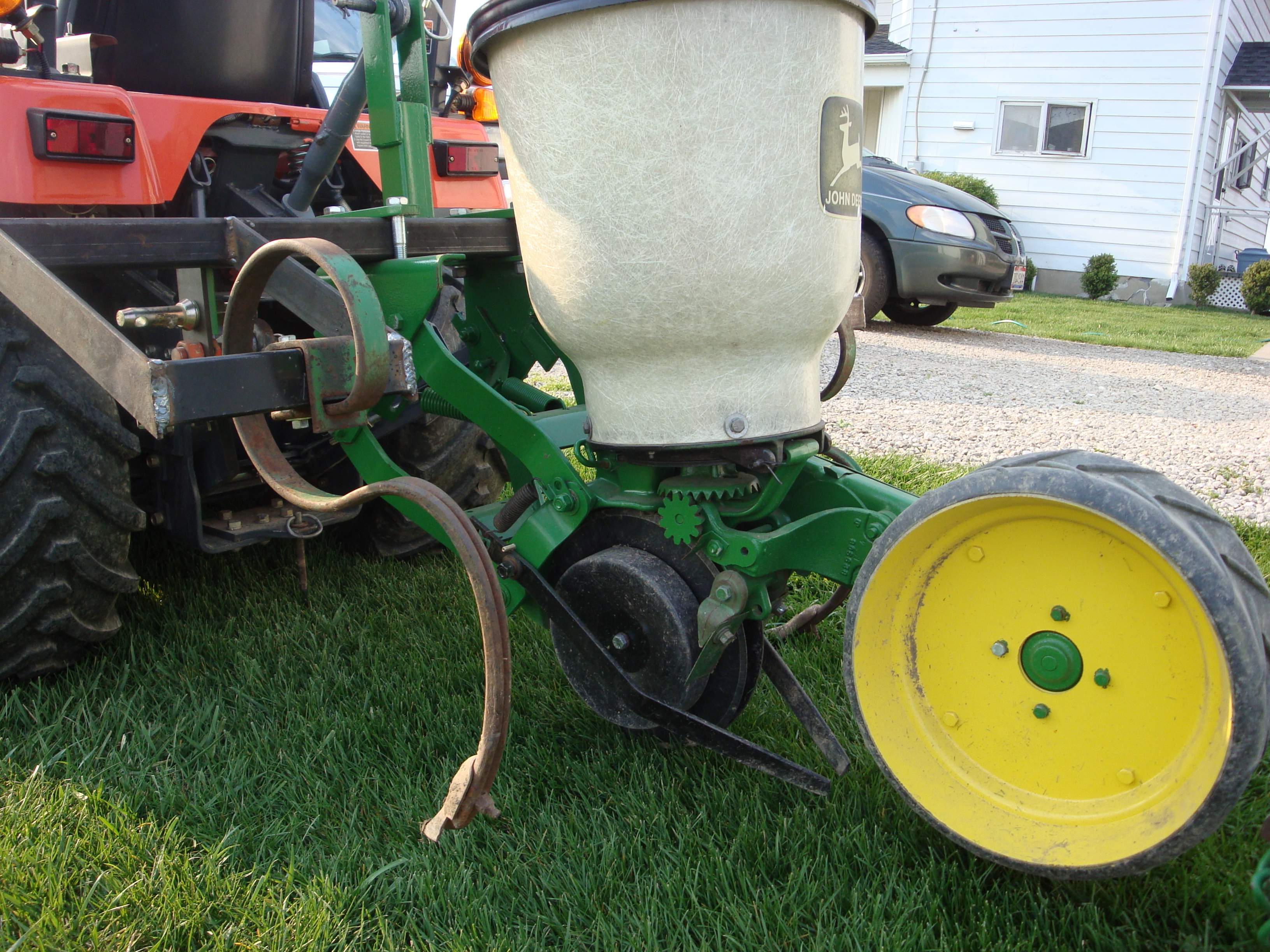

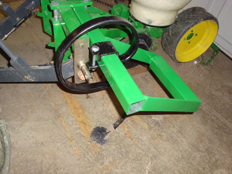

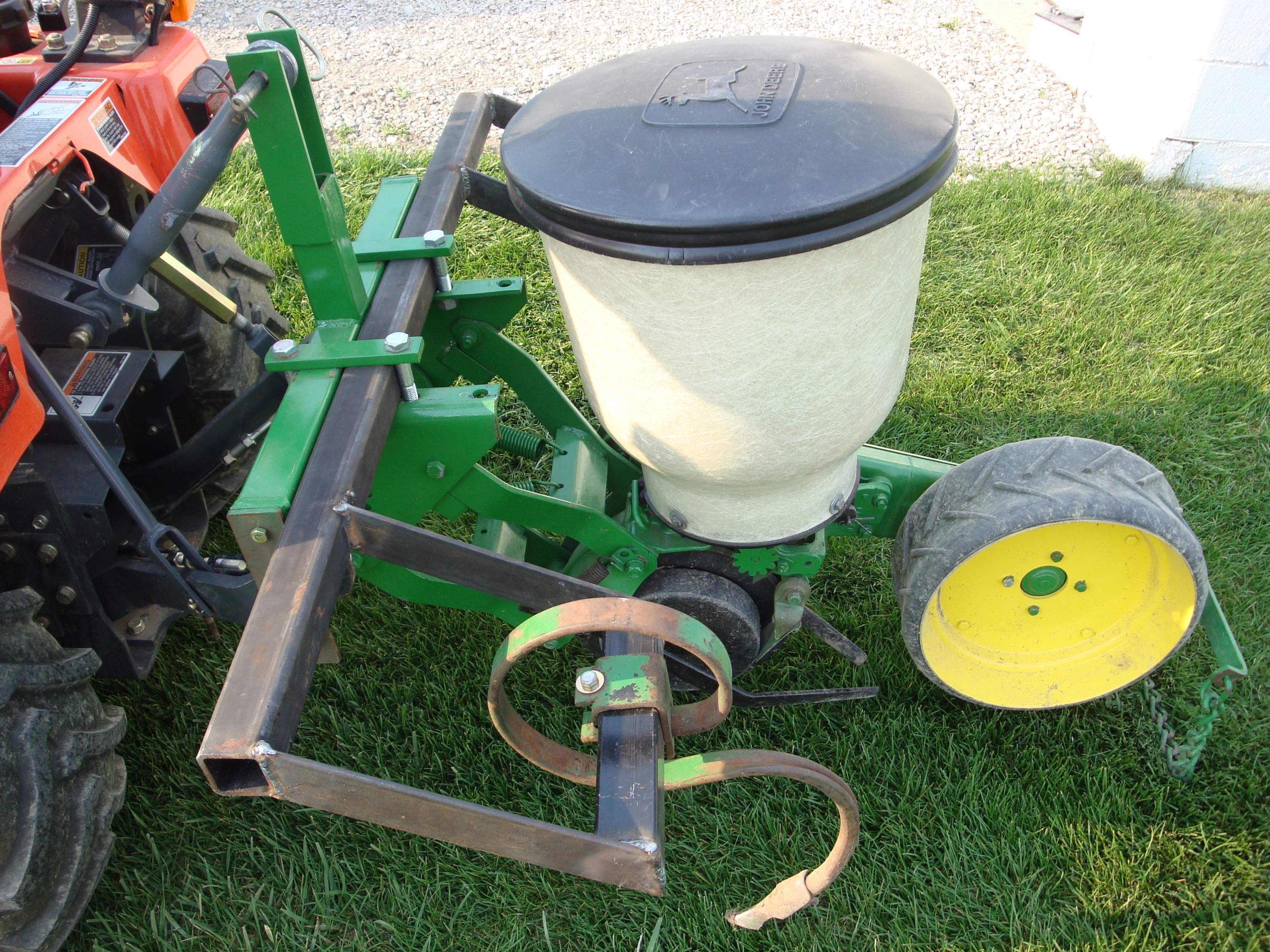

Here are my tire track eliminators for a 1 row John Deere Flex 71 planter behind a Kubota BX2200.
They have the added bonus, of creating a furrow that I can run my front tire into, to keep my rows all spaced evenly. By lining up either edge of the front tire or the center of the tire, with the furrow I can get 26", 30" and 34" row spacing without adjusting anything on the toolbar.

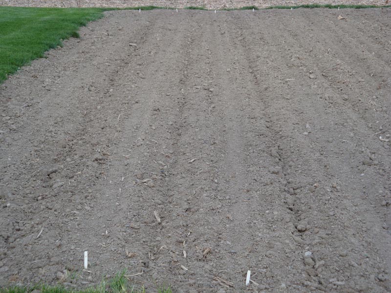

I just put in 6 rows of sweet corn earlier this evening with it, and it works great.

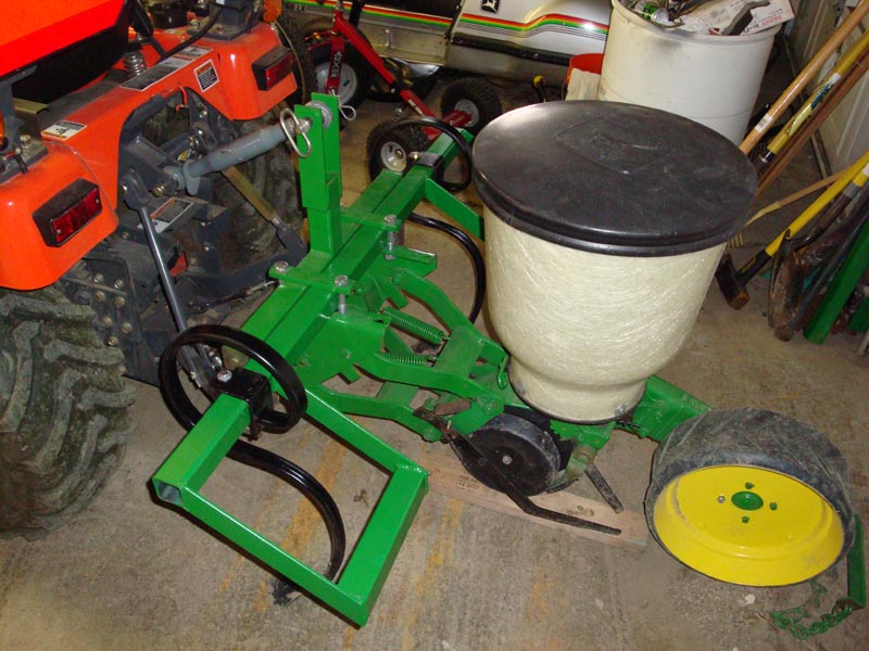

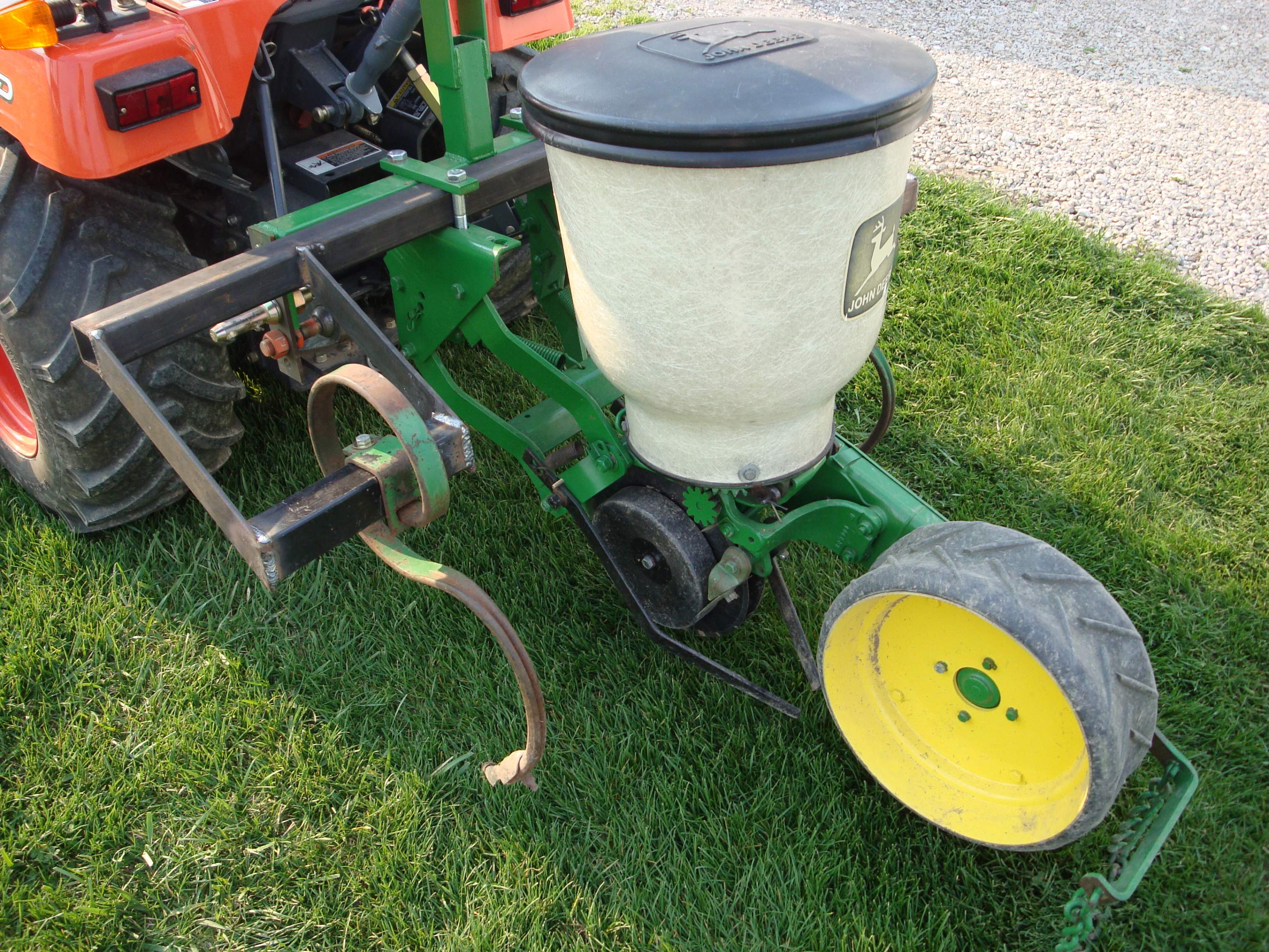

Here's an updated photo with the toolbar painted JD green and some newer shanks and shovels. Also included photo after using it to plant 6 rows of sweet corn last week.

What is the purpose of the wheels mounted on the sides of the openers? I've never seen them before. bjr
   / Track eliminators for J.D. Flex 71 planter #5
To control the depth.
