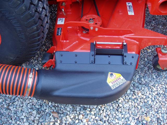

I bought an Agri-Fab boot from TSC when I converted my Easy-Rake to the 60" MMM on my B3030. About $65. It is a complete custom fit project. The boot comes with the intake area closed. I had to cut it out and reinforce it on the bottom to make it fit my deck. It turned out pretty good. I spent about two hours on it. The other option is to buy a boot for your deck from Kubota.

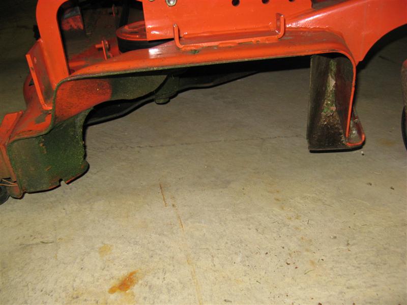

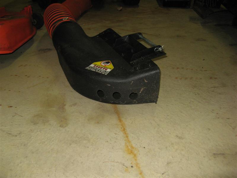

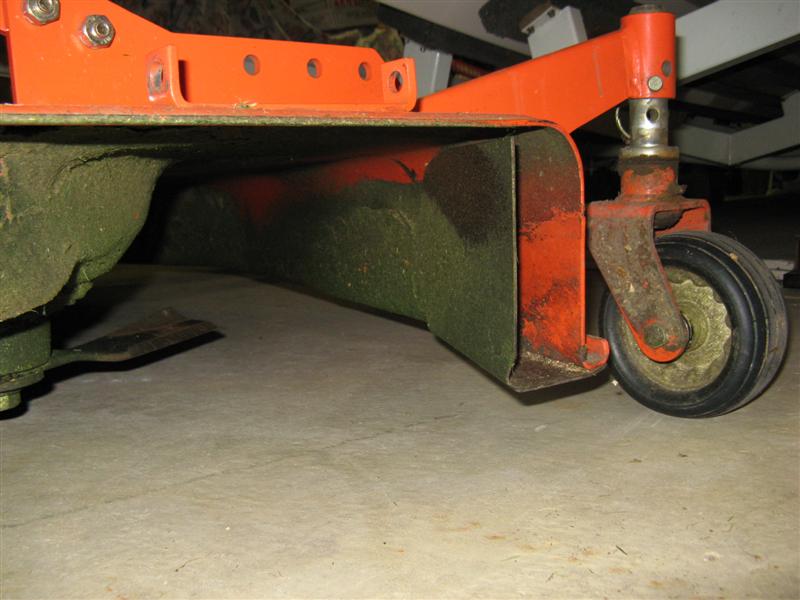

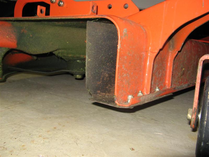

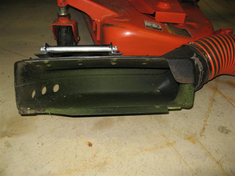

The bottom will need some sort of reinforcement to keep it straight as it is nothing more than thin plastic. I used an old metal tent stake on the bottom of mine. The tent stake is bent in a slight vee so it is strong yet still fairly lightweight. I put the pointed end towards the front. I also have a piece of 1"x3/16" aluminum on the bottom sandwiching the plastic in between. The metal on the top is 14ga. sheet metal. There is a peice on the underside as well as the top. The angle iron mounting bracket attaches it to the deck with a piece of 1/2" rod. I had to take the deflector off to mount it the way I do. That is OK with me as I just leave it off when I mow now. It does a better job of dispersing the cuttings when not using the vacuum. My lawn is "rock free" so I don't worry about shooting missles at the neighbors.
Another thing I found out I needed was to make a diverter plate inside the deck to direct the clippings rearward. There seems to be a "dead air" space in the front part of the collector that fill up with grass and then clumps fall out on the ground. I also cut some holes in the front part of the chute to get some more airflow in that area. I got the idea for that by looking at the factory Kubota chute. It has louvers in the front for the same reason.
I think you can buy a diverter plate for the Kubota decks. I found a piece of metal that looked like it might work so I just started cutting and grinding until I got it right.
It took me a couple of seasons to figure this thing out so I would get the results I wanted. It does a good job now. It still misses a few leaves and a little grass now and then but it is about 95% perfect. I'm satisfied with that.

Again, bringing up the old thread... Many thanks to the contributions above, the information is still valuable and helpful. I have a Kubota B2630 with a 60" mid mount mower. I recently attached my DR Leaf Vac with a 6" hose to the Kubota, using the parts and illustrations from this thread. The Agri-Fab 43830 chute is an excellent part for this applications (I purchased the chute for $36.99 via Amazon Prime) - I made the baffles inside and on the mower deck, attached with a couple of rubber straps, then vacuumed three acres in a couple of days. Glad I found this thread, the kubota works much better than the craftsman ever did with the DR Vac.
