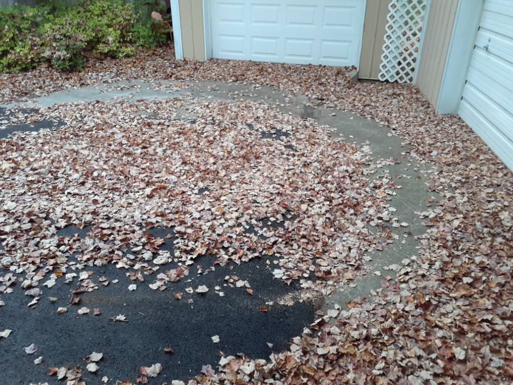

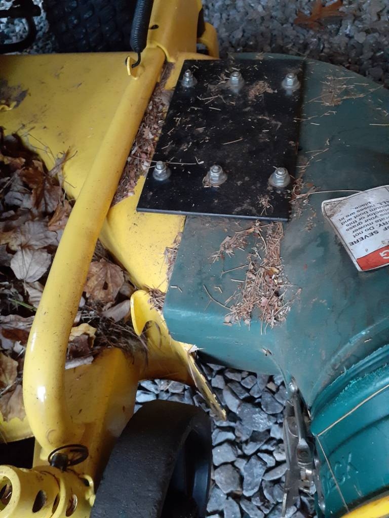

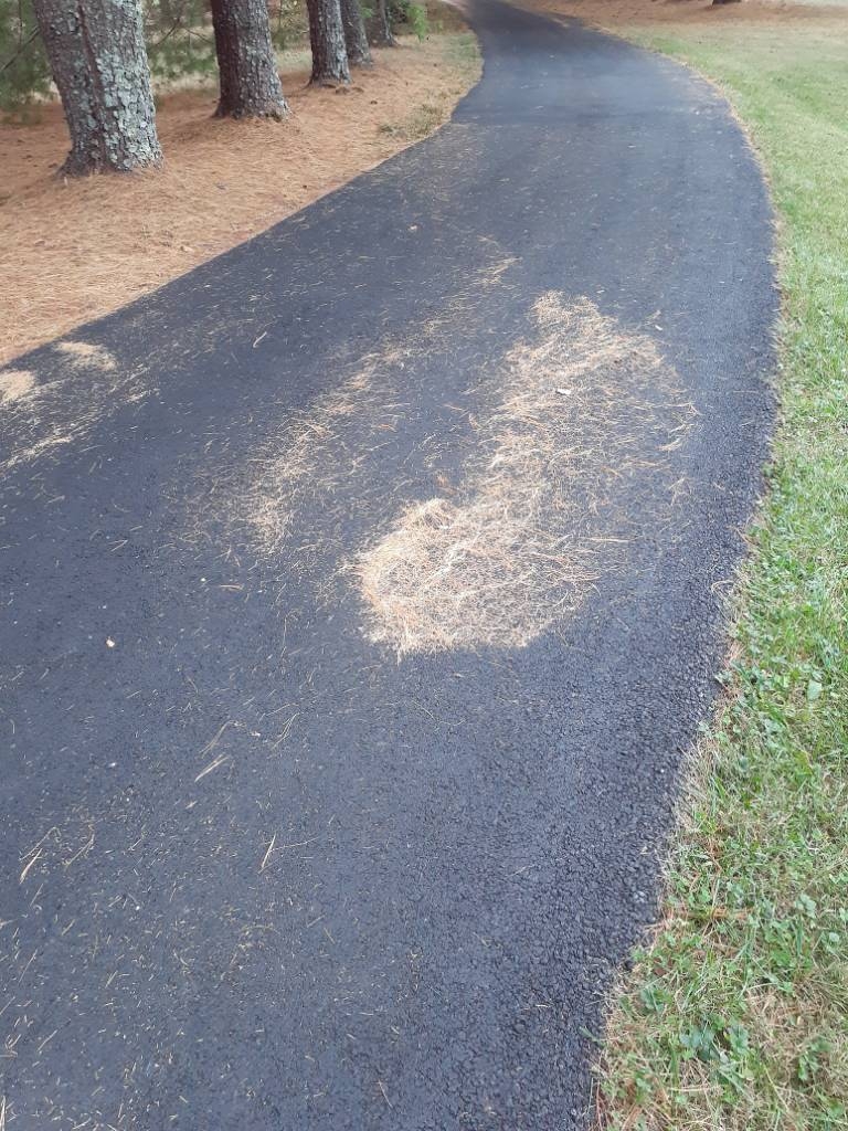

I have a Trac Vac 880, a Cyclone rake and an Agri Fab sweeper. Of the three the simple brush sweeper does best job getting up leaves.

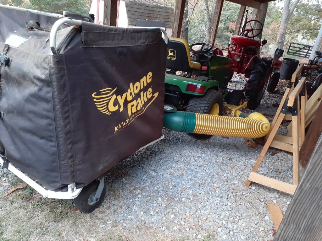

The Cyclone is on a Deere 455 and chute adapter I worked on some today making a tighter seal, but neither that or Trac Vac do that well. Both have lots of suction, and both I've used with just a long hose getting up leaves...works great but not on different mowers. The circle I made on driveway shows it and I tried deck low as it goes.
Driveway it skips places just like yard and leaves are bone dry.
Does anyone make a simple attachment like a vacuum cleaner, wide opening...say 4ft x 1ft? The problem seems to me running mower then trying suck up leaves.
Has anyone fabricated something?

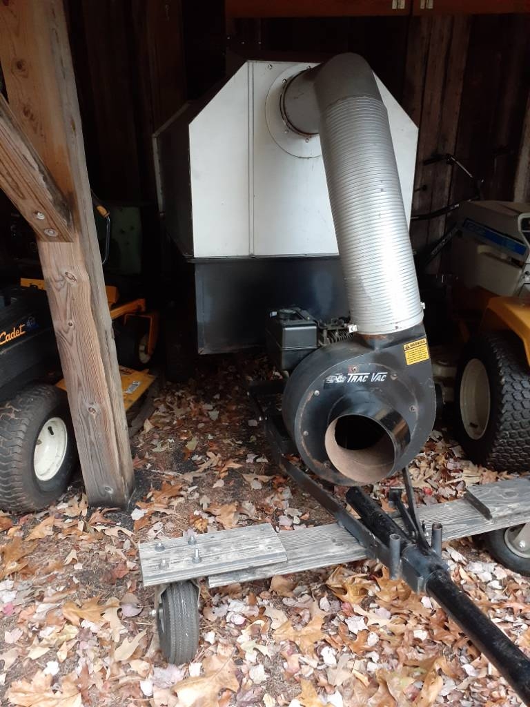

The Trac Vac I made a front dolly, the motor is so heavy.
Any ideas...thanks so much.

Sounds like you got a mower deck problem. Your not using mulching blades are you. Also are the exhaust vents on the vac units open and flowing air.
I have a Cyclone rake and that thing does a super good job of sucking up leave and grass clipping plus walnuts and hickory nuts that go thru the mower.

Your picture looks a lot like when the chute on my Cub Cadet deck, or boot attached to the chute gets partially plugged by a twig. I just shut it down and remove the hose from the boot, pull clog out and go again. Always keep a 5/16" nut driver in my pocket to remove hose.

I think I understand your issue, but I'm not sure how to solve it. I have a Cyclone Rake and it will pick up every single leaf when I run it over grass. However, on concrete (any hard surface) it will pick up a lot of the leaves but blow some out the front and sides. I used to just go over and over the driveway until I got most of them. My approach now is to use my backpack blower to blow the leaves off the driveway and onto the grass, then pick them up with the CR.

On hard surfaces after first pass to get the majority of the leaves make a second pass with the mower deck shut off. The spinning blades cause the leaves to blow out the side on hard pavement.

Sometimes Deere will offer under-deck baffles when the person wants it to mulch. It should be set up to fully side chute with no mulching plates installed. Your connection to the deck looks pretty good so I don't see an issue there. My agri-fab unit will stop sucking if the exhaust vent plugs up. It plugs quicker if I suck just leaves instead of a grass/leaves mixture. When I dump the load, I hit the top screen with a rake to clear the exhaust. Mine will also leave more debris on pavement than in the lawn where it cleans quite good.

Im with Kenny, get the debris off the driveway and on to grass to improve the seal around the deck. Even with a vacuum you will get a ton of blowout on a hard surface.

DJ54, thanks for the idea. I tried letting the tractor idle to slow the mower deck, while I ran the Cyclone Rake blower at full throttle. It did a much better job of picking up the leaves from the concrete drive. Looks like it's going to save me a lot of time.

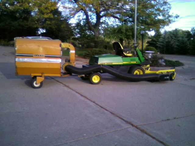

I have a unit that used to be a Woods Vac. I had to convert it to a RHS discharge for my Deere 48" & 72" decks. Couple of things I altered:
8" hose, chute, and 'blower' input.
6.5 hp Higher power Honda motor: no throttle, just 'On' or 'Off'.
More exhaust ports on the trailer. The air flow must get out as quickly as it get in. Otherwise the airstream chokes.
Deck height increased because the masses of leaves, branches, walnuts, dog poop, and dog toys has to be able to get under the deck. There's plenty of suction.
On a side note, I once accidently ran over some glowing ashes from a former burn pile. Entire load caught the sparks and it turned into a leaf combustor as well as a leaf storage box. Fortunately, its all metal. Looked like a steam locomotive climbing a hill out West ! I probably should add a rear view mirror...

For mods to my trac-vac
- replaced 6" hose with 7" hose and new flange on blower increased the airflow a lot
- replaced the 1/4" mesh on top of cart with a 1/2" expanded flattened metal mesh that allows more airflow and less clogging up with leaves
- Modified an agrifab plastic boot for better airflow and mounting
When I get it out this weekend I take some pics

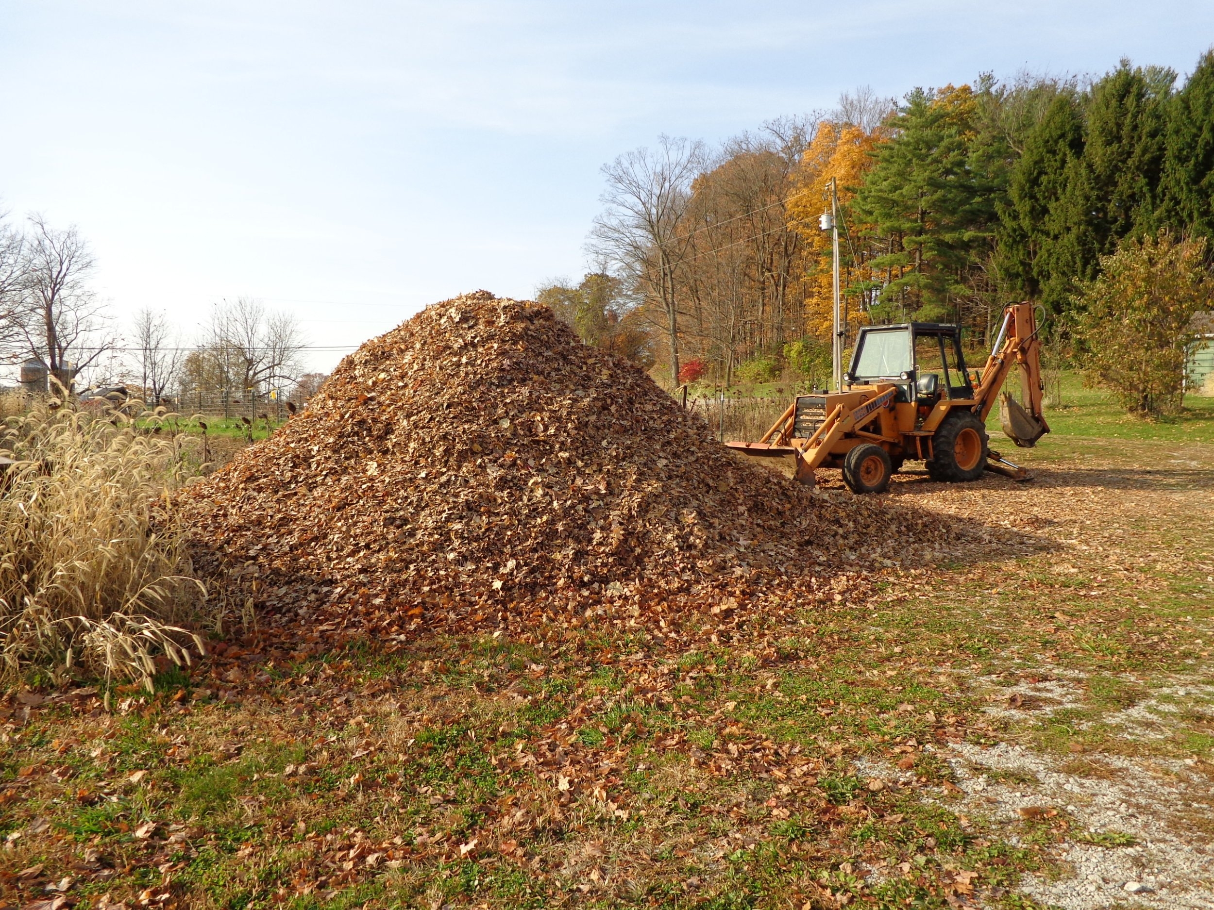

I've got quite a pile going on here. I use them to mulch around set plants in the garden to suppress weeds. Works very well..!! Between a buddy of mine working temporarily for a lawn service picking up leaves and gathering from 2 neighbors I've got quite a stockpile for next year. The pile has grown about 1/3 more in size since this picture was taken, and more coming in today. One man's trash, is another man's treasure...
