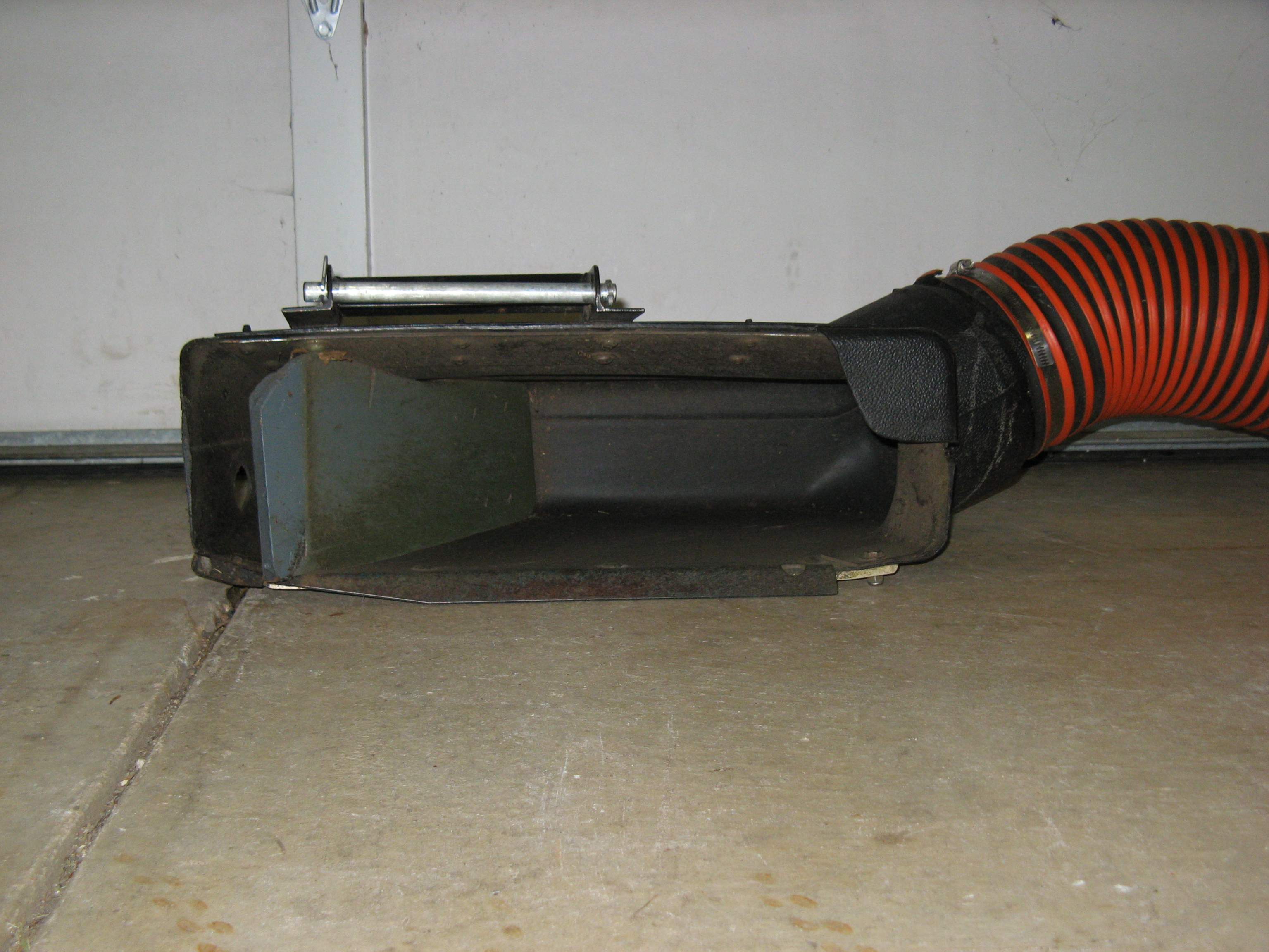

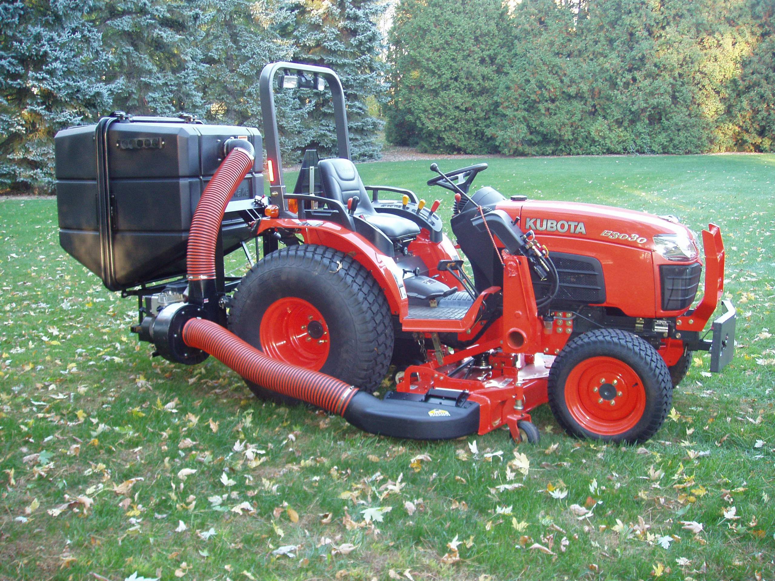

I think you are on to something. The long length of hose from the chute to the vaccum is the problem. I had a similiar setup. I pulled a 5hp Easy Rake with 6" hoses behind my JD318 with a 50" mower. It had problems with the hose clogging on wet leaves. When I got my B3030 I converted the Easy Rake to 3PTH. I wasn't sure how well it would work behind a 60"MMM, but I gave it a try. The resulting setup reduced the length of the hose by half. The shorter hose makes such a difference that even with the 60" MMM on the Kubota it works better than it ever did pulling it behind a 50" MMM. I think the larger 8" hose should help. It is worth a try, at least.
I also have an Agri Fab plastic boot on my Kubota MMM. The steel one from the old setup was way too small. I made a few mods to the deck and the chute to keep the air moving through the boot as smoothly as possible. The boot causes a big dead air space where the grass and leaves coming out of the deck slow down before being sucked into the hose on the way to the impeller. I made baffles that make the opening of the deck and the interior of the boot smaller. That helped a lot. I can now mow grass at normal ground speed. I slow down in leaves depending on how thick and/or wet they are. Wet leaves are not a problem. The only time the boot or hose clogs now is if a stick get sideways in the hose. Good luck.

Keyman; I took my Easy Rake pull type vacuum and converted it to 3PTH. It does work a lot better than when it was a pull type. A company called Bluebird now makes something similiar to the Easy Rake.
LHoyer; The baffle narrows down the opening on the deck and lines up with a narrow wooden board that I made fit into the boot. The board is held in place with small screws. It helps keep the debris coming out of the deck moving in the right direction towards the vacuum hose on the boot. It also allows the deck to work together with the vacuum. Before, the deck would blow the debris into the oversized boot where it would lose some momentum before being sucked into the hose. Just a little change like that made a huge difference.
The metal strips on the leading edge of the deck are there to help keep the wind created under the deck from blowing leaves away from the deck before they get a chance to be picked up by the blades and blown out the chute. I just cut and drilled some 2" X 1/8" metal and bolted it to the bottom of the deck. The holes in the deck were already there. I think the deck is setup for these as a factory option. They help a great deal even for just mowing grass.
