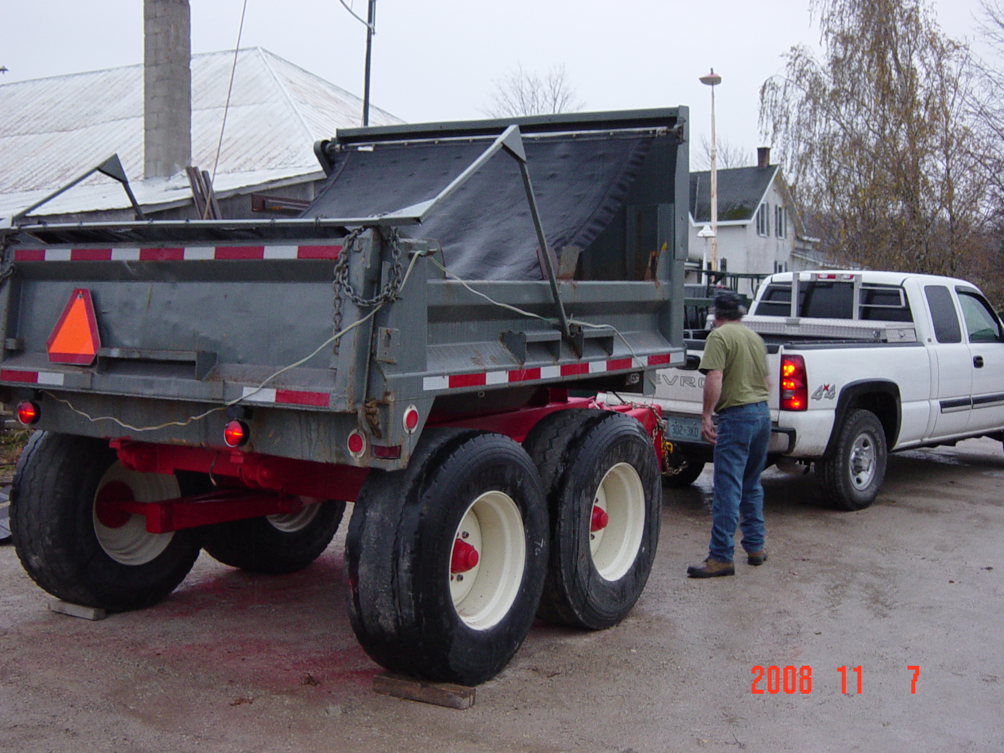

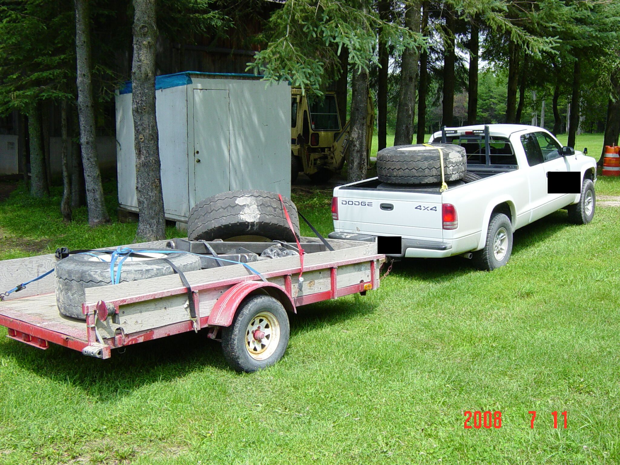

Are you talking about a long wagon frame? I had a friend tow this horst 12 ton running gear made into a trailer with his half ton as I drove a Dakota!
