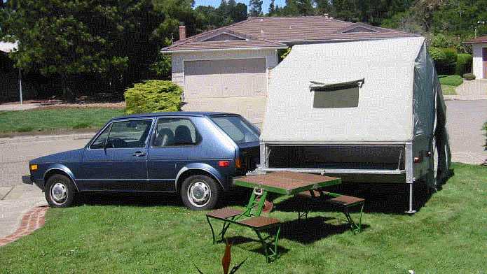

My Sears Heilite Tent Trailer always gets strange looks... it is single wheel with two 1" trailer hitch balls...

Pictures!
Here you go...
Heilite Trailers were built of aircraft quality aluminum by the Heilite Manufacturing company founded in 1953 in Lodi California. They have doors for access to the storage area under the sleeping area.
The entire canvas is water proofed and folds into the top of the trailer and if need be could be removed and the trailer used as a utility trailer.
The two small trailer hitches that mount to 1 inch trailer balls. The data plate makes no mention of Weight or Load Capacity.
Here's a link to the a view of the undercarriage.
http://www.singlewheel.com/Auto/Heilite/HeilSamba/1650253.jpg
