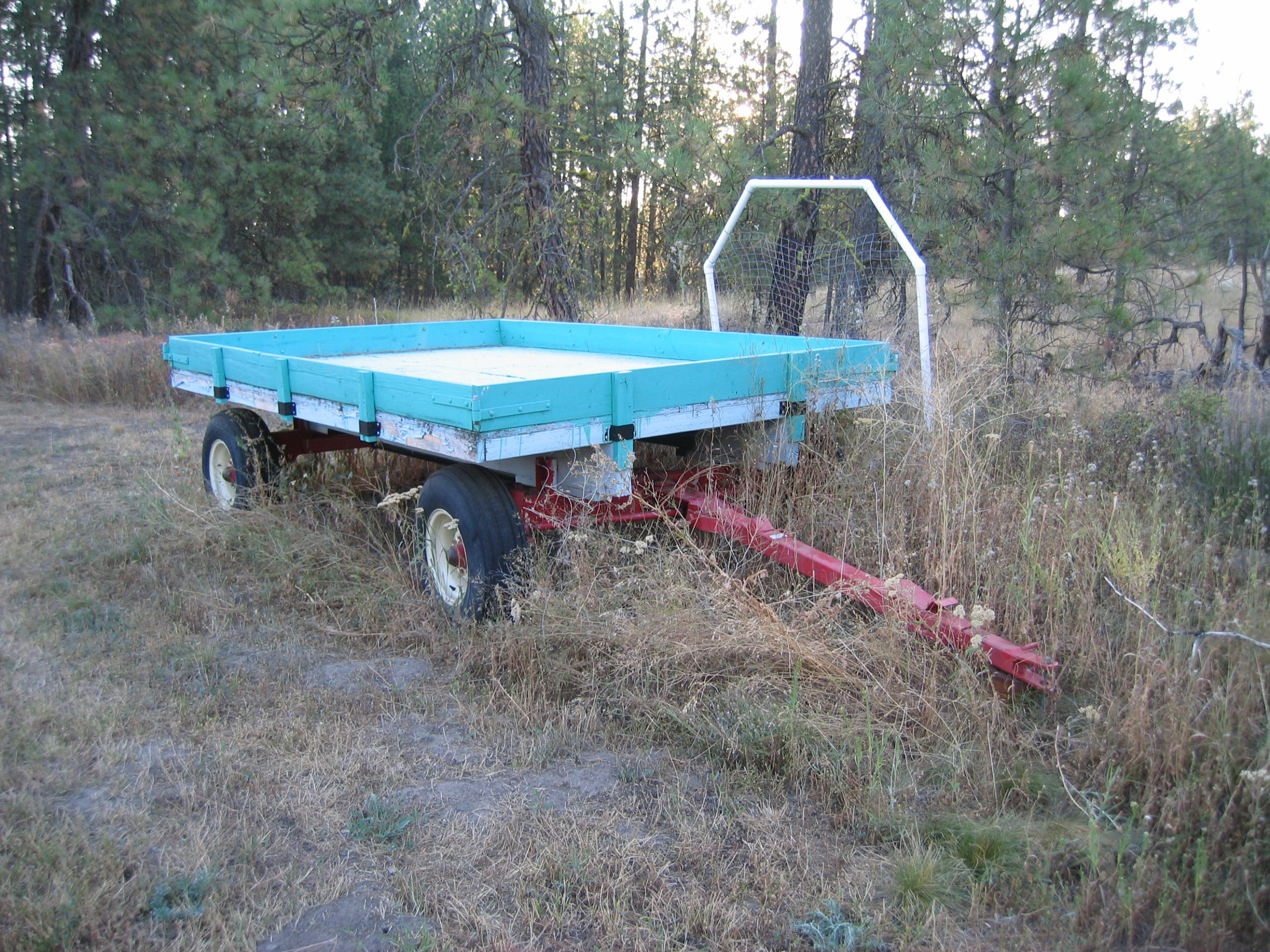

I built a farm wagon from new Horst running gear. It's rated at 20,000 pounds. My Kubota M6040 weighs 10,050# and is rated to tow - 11,000#. I have - log weight charts & rock weight charts. I know, for a fact, that I've had 15,000# to 16,500# on my farm wagon and pulled it, easily, with the Kubota.
BELIEVE WHAT WE ARE TELLING YOU HERE!!! It's not towing the load that's the concern. It will be stopping the load. If slope or grade is involved in this move - you will be surprised how much that load can push you around.
