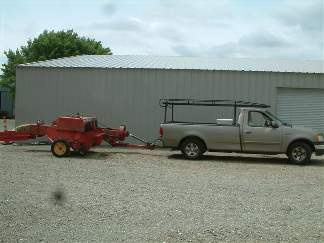

I towed my MF124 baler (two-twine, small squares) about 25 miles from the seller's place to mine. Used the F150, back roads, 25 mph max.

Many years ago (20?), I towed an IH-46 baler behind my CJ7 60+ miles. I remember doing 45 max and stopping at several pull-overs to check the heat coming off the bearings. There wasn't much, but it was probably too fast and too far. I wouldn't have the nerve to do it today. I think I was just lucky.
Most of the trip was on a two lane state highway, with lots of hills and only a couple of passing zones. I picked the baler up at first light on a Sunday morning and didn't have much traffic. I didn't encounter any police officers, but I doubt they would have stopped me. Indiana is still a farm state and equipment on the road is a normal event.
I don't think I'd want to do more than 20 miles and I wouldn't go over 25MPH.
