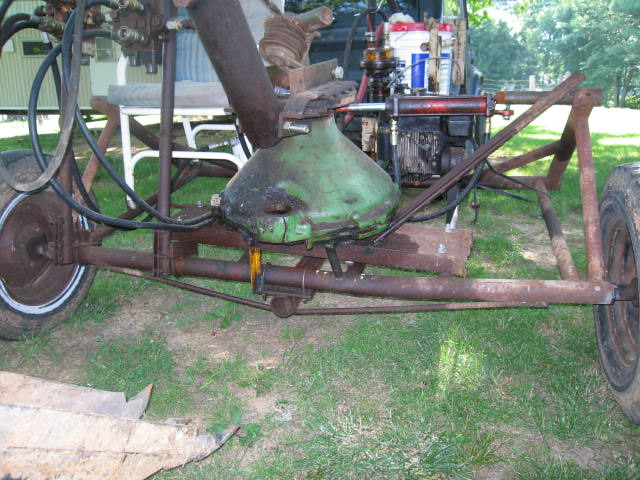

valves and operators seat- the valves are just in series so I can only move one cylinder at a time. The back iron pipe fitting you see is on the return end of the valves, so it will never see over 20 psi of pressure at max.
