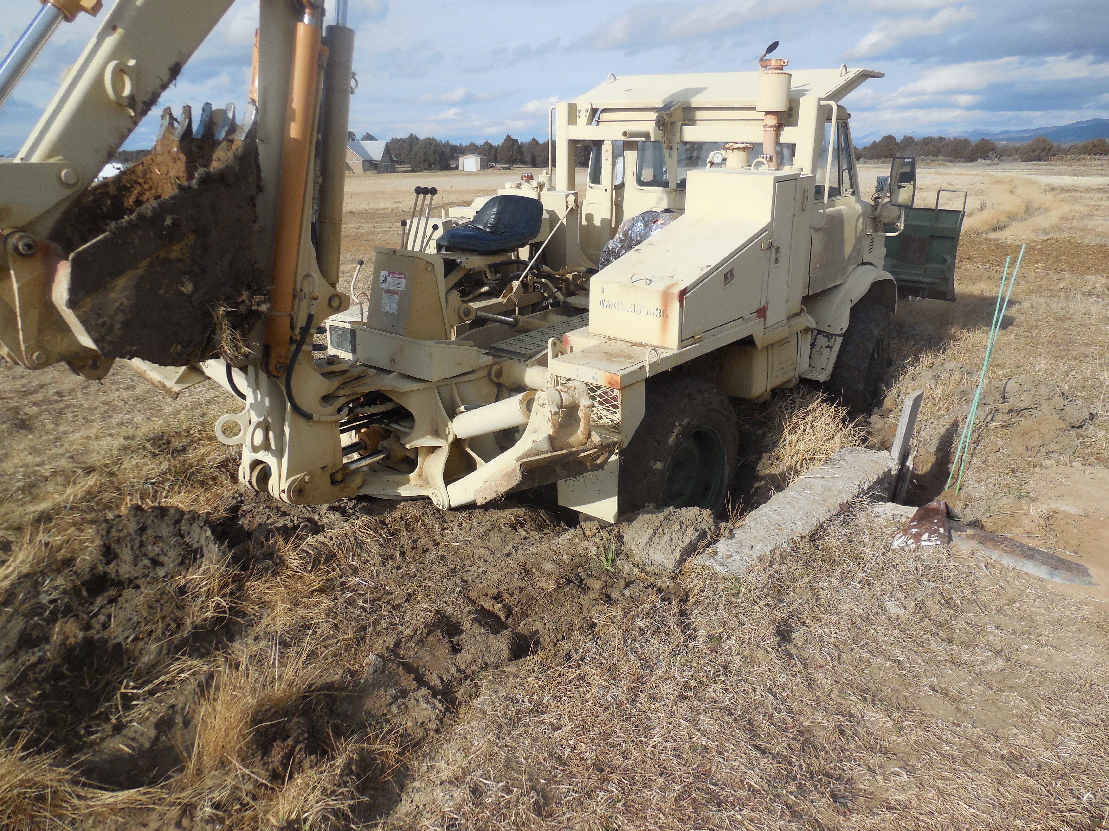

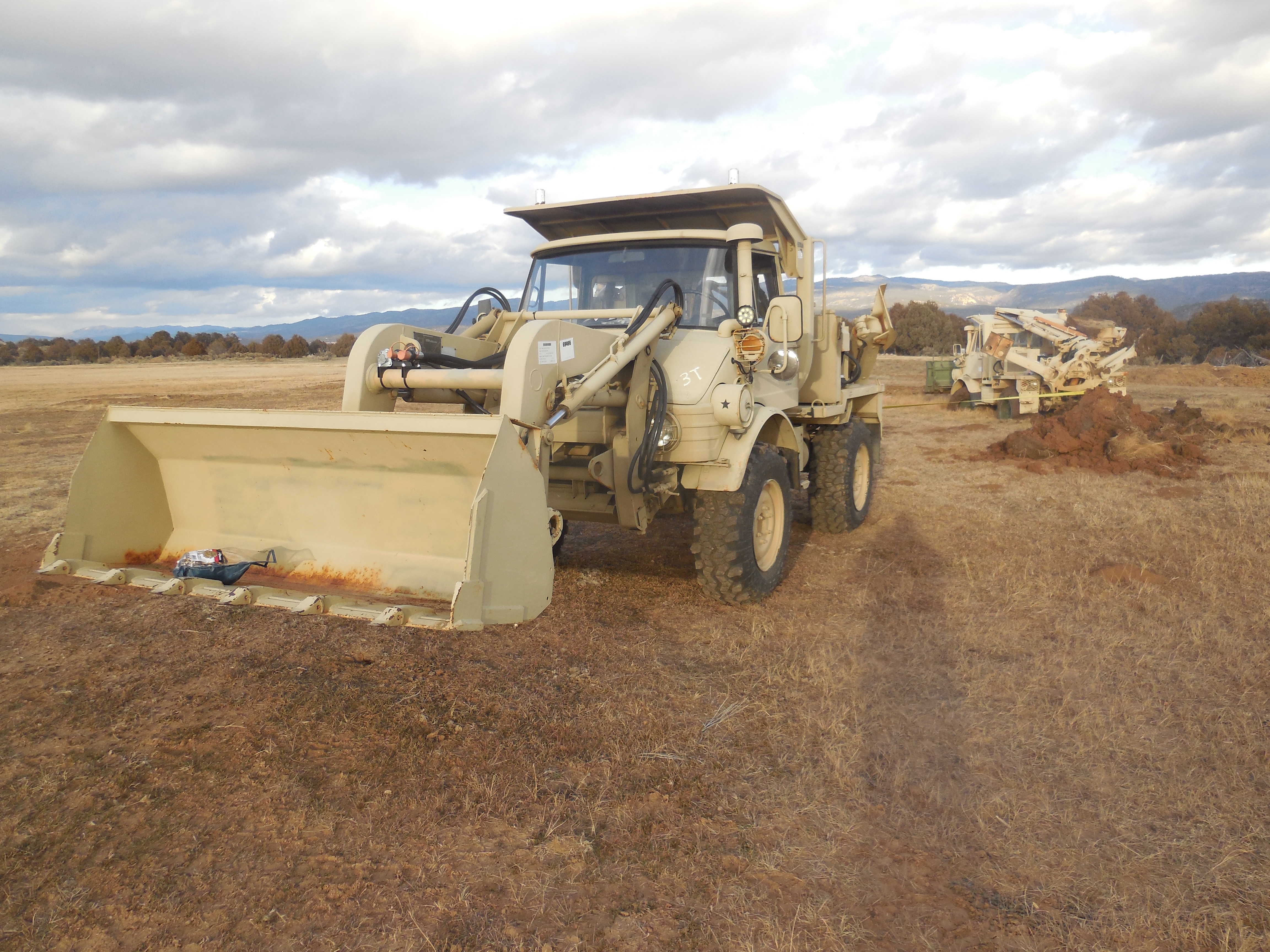

I have plenty of 1/2" chain, which could've been attached pintle hook to pintle hook, but used a strap instead since it's just kinder to the vehicles involved. And maybe because I learned a lesson from the incident described above.
With one 16,000 lb. Unimog somewhat firmly planted, another one was used to free it. Couldn't really extract the stuck one by itself since there was a dozer blade instead of the normal bucket on the front. That's a 40" tire that's barely above the surface, by the way.
It's situations like this that prompted me to install an 18,000 lb. winch on the stuck one. With a wireless remote it's relatively easy to get things unstuck, even while operating whatever is stuck. Usually the skid steer.
And if that doesn't work, the more recently acquired M936 should be able to get most anything unstuck. Thankfully haven't needed that one yet.

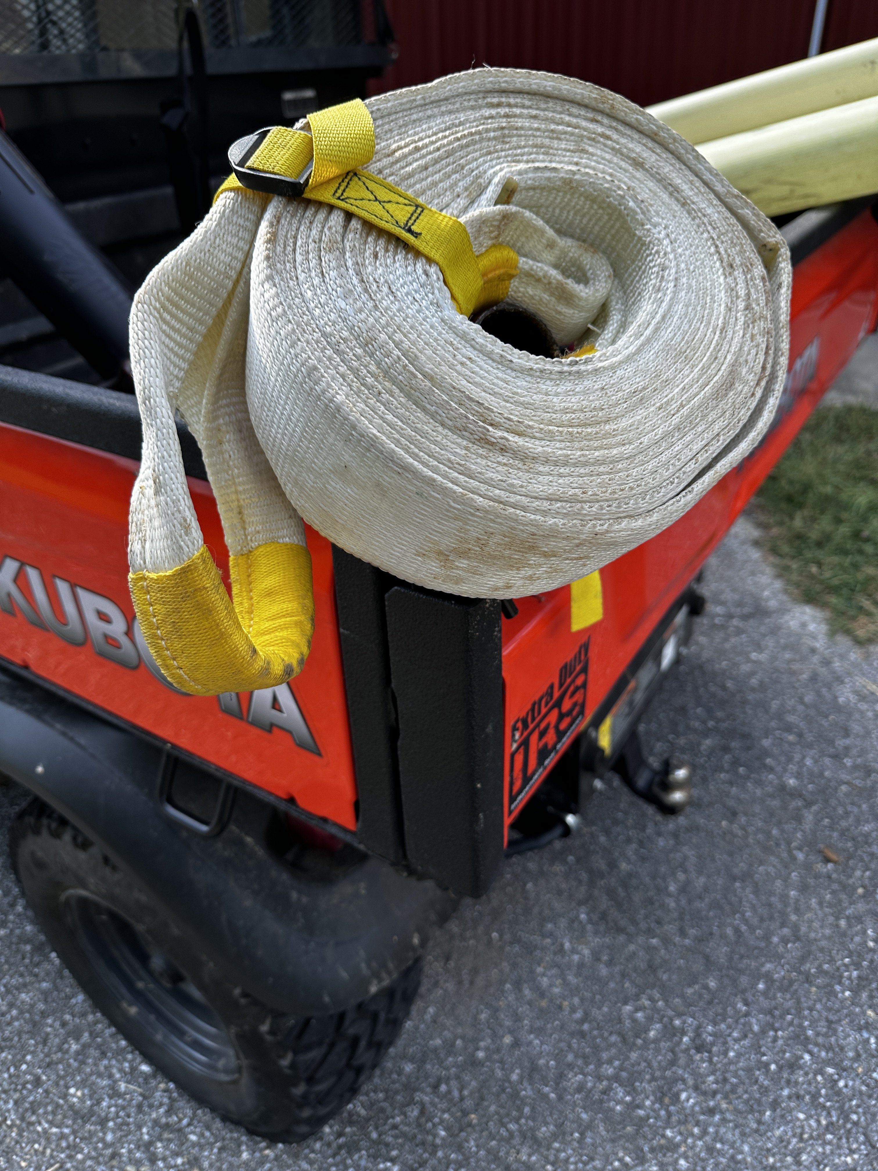

When it is a difficult stuck vehicle I will use this tow strap. It absorbs the energy and stretches and snaps back and multiples the towing force and jerks the stuck vehicle back a little. Sometimes have to do it a few times but it allows a smaller vehicle to perform beyond its weight class

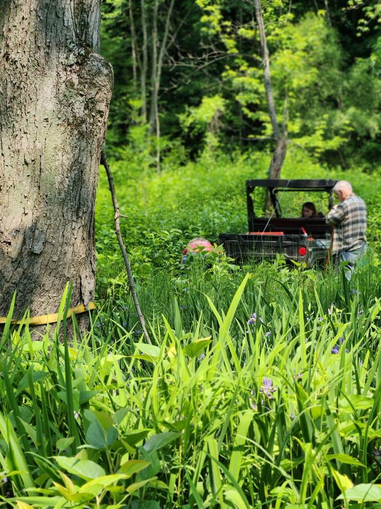

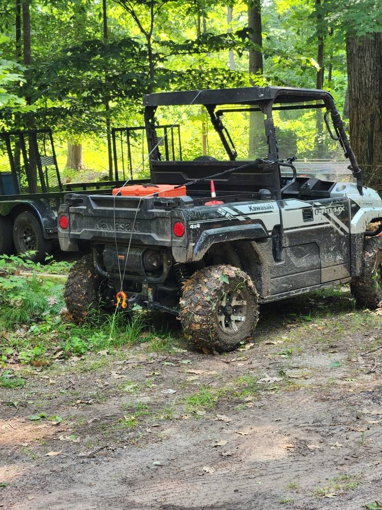

Soft shackles are all I use, I do have steel ones also but hardly use them.
I do have a HD jerkstrap but also mainly use a kinetic rope. Seems to be easier on the vehicles vs the sudden jerk.
I also have a hitch that is basically a shackle you put in the receiver. Good anchor point and if it rips your receiver off, your very stuck
Even self recovery is easy if you have a good anchor point
