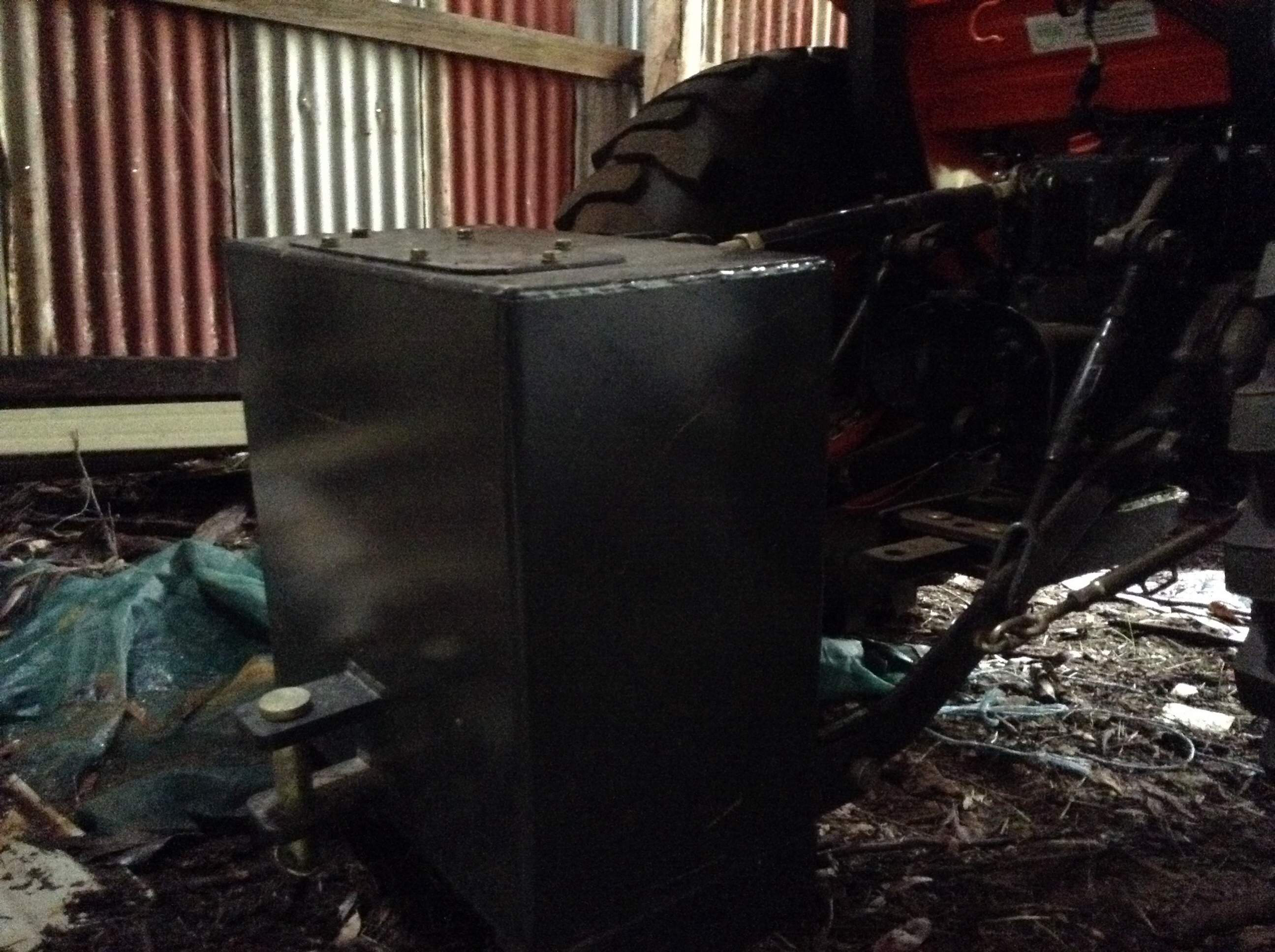

Here is what I'm using: 5000 lb. Step Bumper Receiver
I tried to attach a picture of my ballast box with the hitch on it, but my tablet browser is not being cooperative.
Thomas
PS: This is what I mean...
You have to look really close at the bottom center of the BB.
That is the same sorta thing I used on my boxblade. Mine was an old Reese bumper mount hitch.
Between loading tongue heavy and the 680# box blade, I've never had to chain it down even with about 8000# behind me coming off the big hill... I did chain it the first few times, but it quickly proved unnecessary.

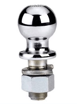

Same topic but another question. I've got a new trailer and on the trailer coupling it has a bolt with a thread that seems to be adjustment for the ball?. If it's done up the coupling/ trailer won't hitch to the ball. If it's too loose the nut seems to just about work its way off the thread. I've been loosening it to get it on the ball and then doing it up with a bit of slack but the nut always works loose. My other trailer didn't have this setup so I don't know what the go is.. I thought about drilling a hole at the top of the thread and put a split pin in it so I can't loose the nut and then maybe some locktite to keep it there. Any advice on the adjustment etc would be appreciated as I'm worried if it's not right the trailer will come off. It's a 2" tow ball hitch. Thanks
   / Tow hitch off the 3 point linkage counter weight #27
Some pictures would be great, can't really visualize what you're talking about.
If there is an adjustment on the ball socket, I'd get it adjusted so it goes on and off fine with the latch raised, and won't come off with it latched, then double-nut it to hold it rather than a pin. Being on a trailer I would probably even use one of the locknuts with the nylon insert as the doubled nut. Once adjusted and a lock nut tightened against the other nut, it will not move...

K.J.,
Do you mean under the latch that you flip down to lock the trailer coupling?
If that's what you're talking about, then Sysop is absolutley right about adjusting it so it works in bother direction and then using a locknut to hold your setting...
If not, then he is right that you ought to post some pictures, in order to get a meaningful answer.
