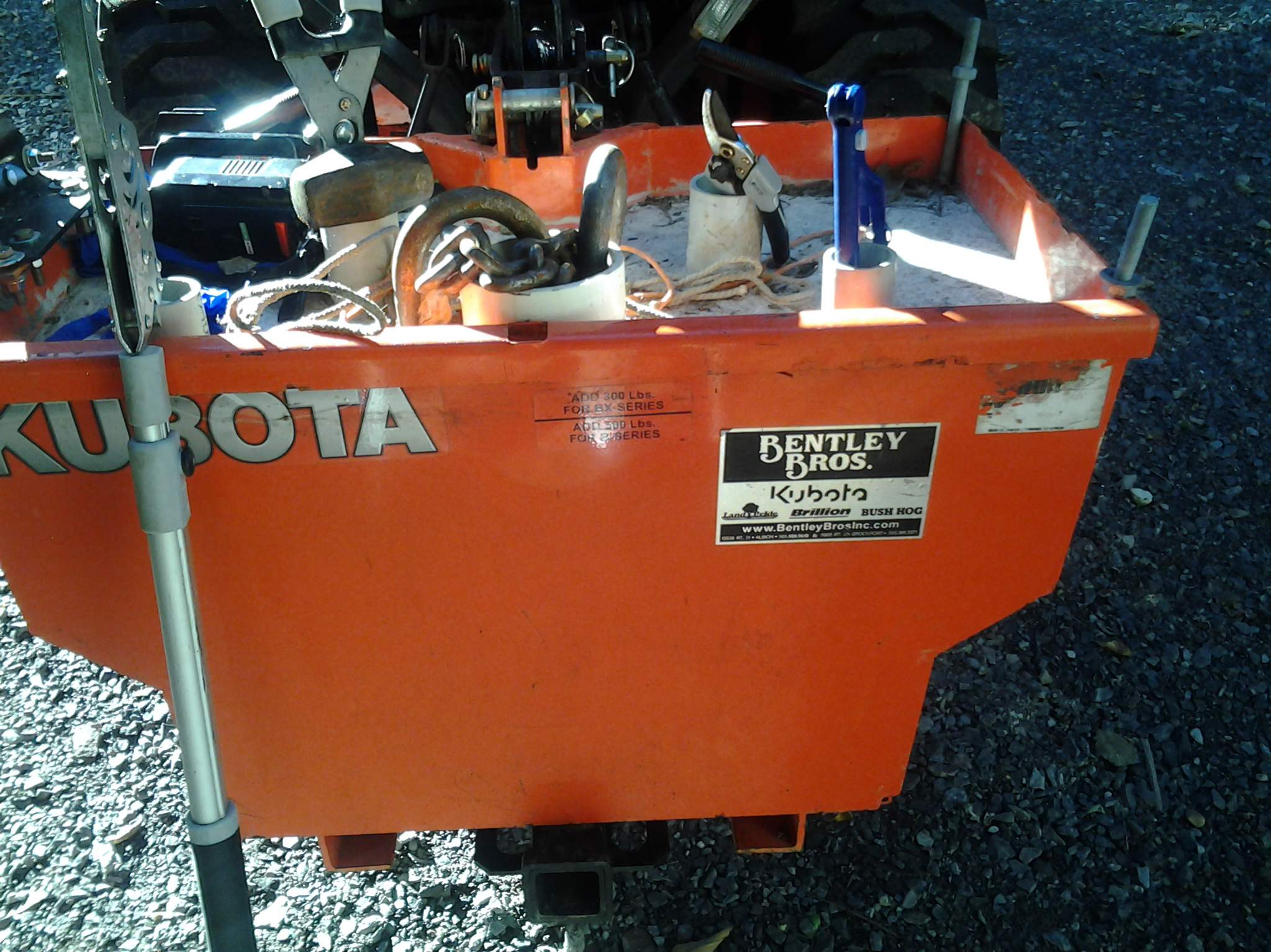

Here is what I'm using: 5000 lb. Step Bumper Receiver
I tried to attach a picture of my ballast box with the hitch on it, but my tablet browser is not being cooperative.
Thomas
PS: This is what I mean...
You have to look really close at the bottom center of the BB.
That is the same sorta thing I used on my boxblade. Mine was an old Reese bumper mount hitch.
Between loading tongue heavy and the 680# box blade, I've never had to chain it down even with about 8000# behind me coming off the big hill... I did chain it the first few times, but it quickly proved unnecessary.
