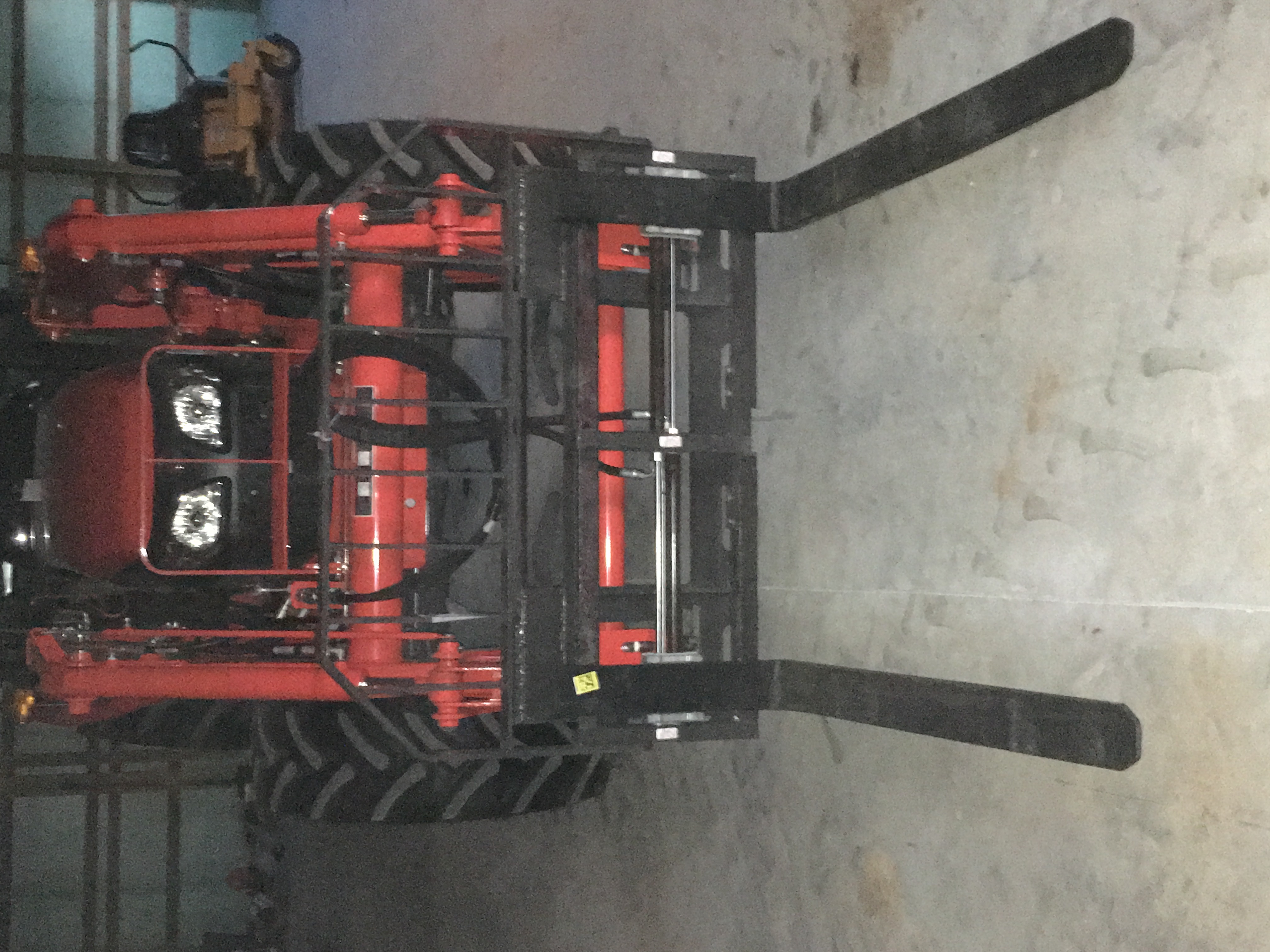

   / Tough to move pallet forks #28
I added a hydraulic fork positioner to my tractor works great.
   / Tough to move pallet forks #29
Looks like you did a nice job on them. Where did you get hydraulic cylinders from and what size are they?
   / Tough to move pallet forks #30
Thanks however I just used a kit. I am in the forklift (related) business and this is a fork positioner mechanism from the forklift industry.
Works great for fork positioning but its not a clamp (load bearing) moves forks like a rocket ship.
