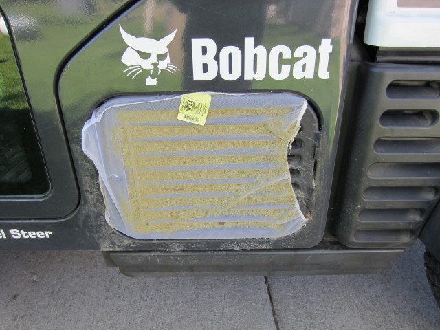

I had a bunch of 5gal pail paint strainer bags and found out they work great protecting the AC condenser from dust. Open the side door and slip it right over, then close the door. It can be removed and shook out out in the field too.
