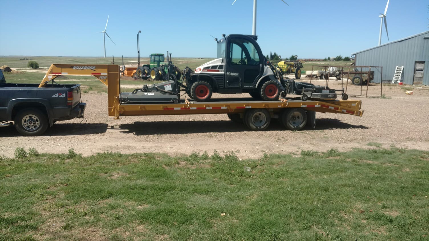

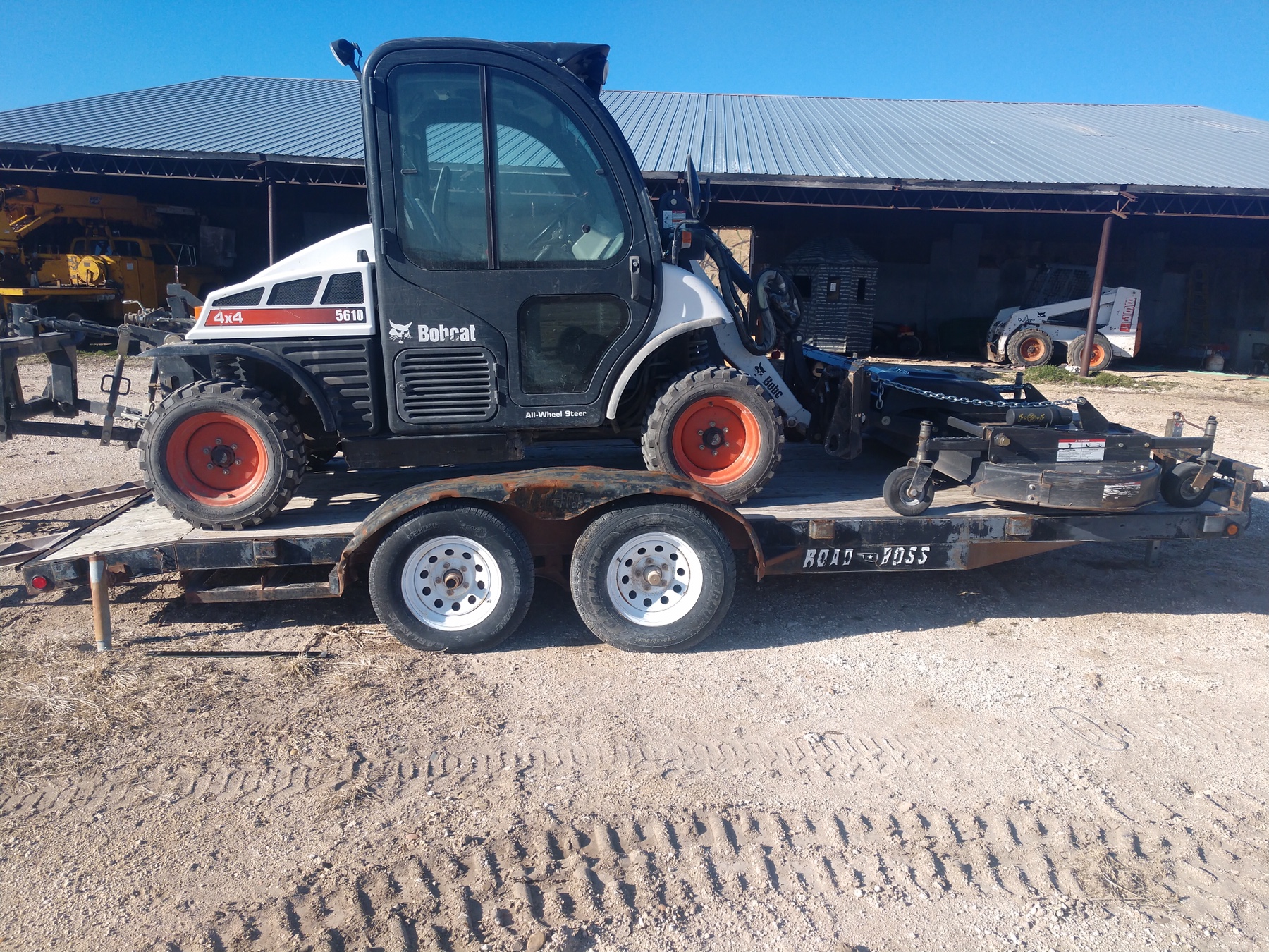

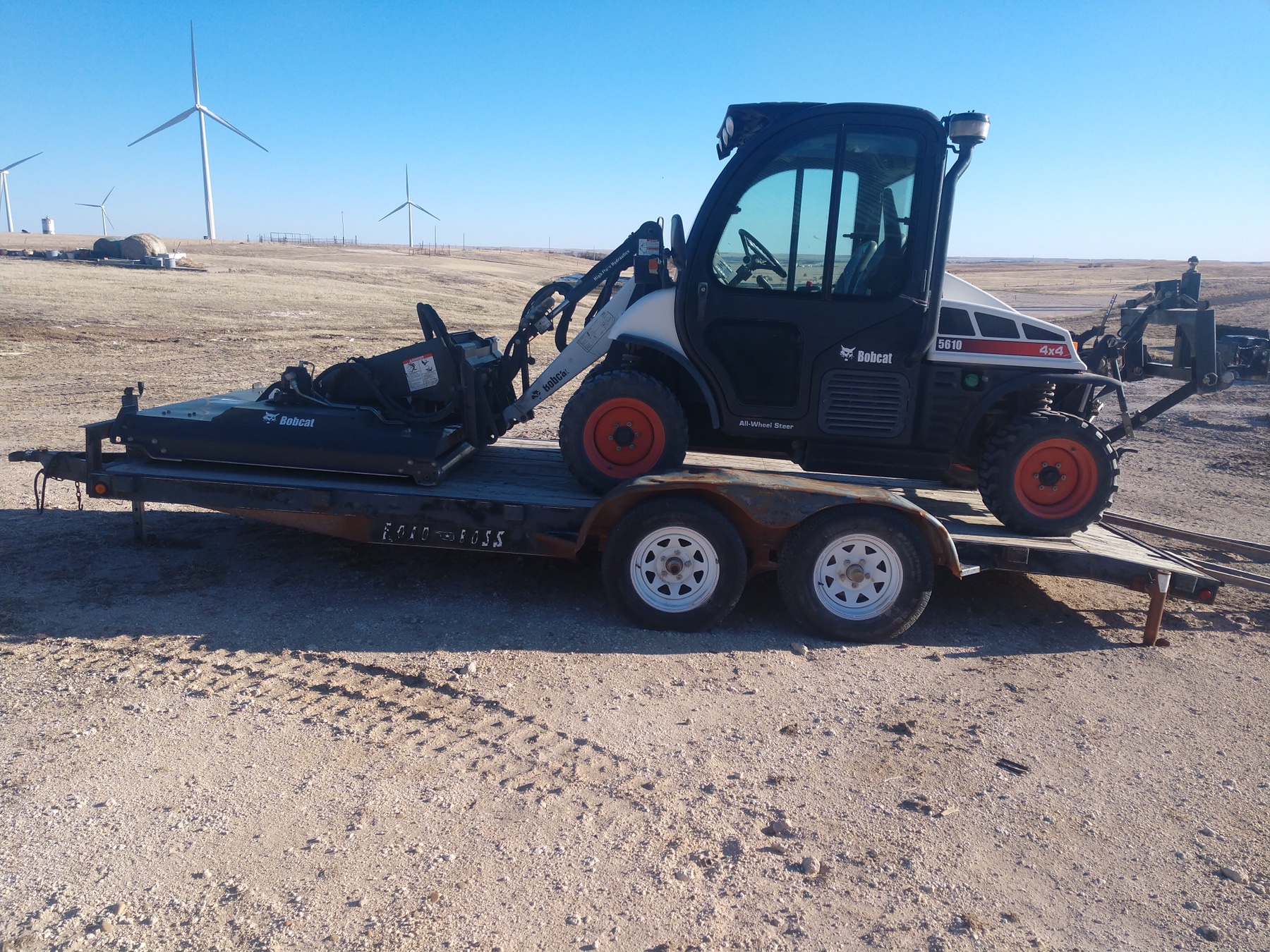

Finish mower and Brushcat 17.5ft, call it 20ft to end of receiver hitch on back, think it was another 3 ft to end of 3 point arms. Back tires are just few inches short of 16 ft. Pics on car trailer is 16ft deck and 18 ft with tail. Pic with both mowers on my gooseneck has 25ft deck and 5 ft tail. If you buy a Brushcat, I recommend getting front rollers.

Nice pics.....thanks.
