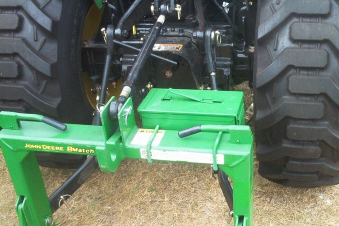

Sorry it took so long to respond. I had camera problems. Please excuse me. This is the first posting with pics.
   / Touch up paint for new jd and equipment

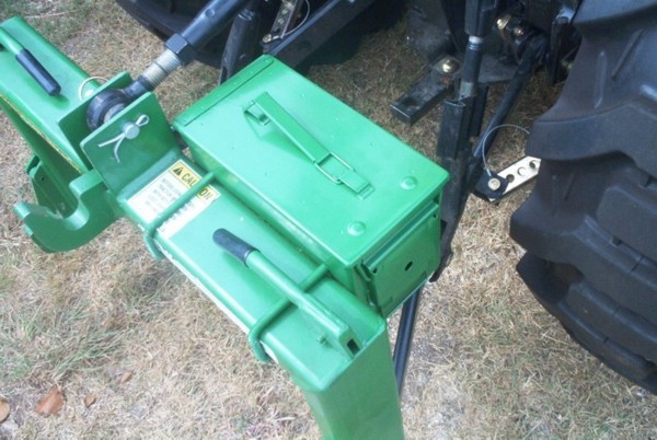

here's another
i am planning to attach something on the left side like a greese gun holder. my quick hitch is used for all my attachments (except the phd) both 3 pt and others.

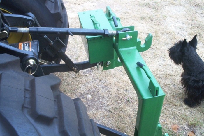

last pic.

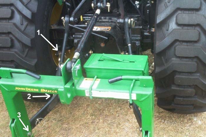

Noted your intended useage, and just wanted to pass on a suggestion of changing out some of the clips and hitch pins at three locations to bolts and lock nuts. I learned early on that the hitch pins can catch on sticks and things, get pulled out, and then the 3pt arms are loose to possibly cause damage (have heard as serious as broken castings, and less serious, bending of components). I posted your pic with three of the locations marked that I have switched over to bolts (I seldom if ever remove those clips at those locations anyway, except the times I remove the iMatch). ¼" bolts with locknuts is what I use and then don't worry about losing them.
   / Touch up paint for new jd and equipment #10
There are a couple other points I changed out too, that is at the rocker arm and the lower 3pt arms. Total of 5 on each side. I guess the hitch pins and clips look 'cool' over bolts, but the bolts will stay put.
