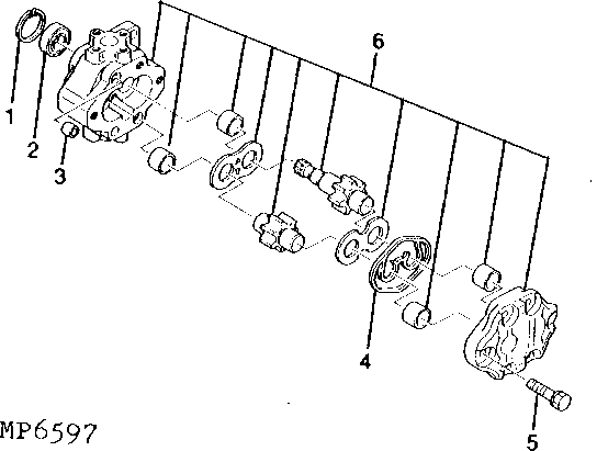

The oil level was good and using JD HYGRADE. I was mowing and stopped to pick up a load of fallen tree branches that did not weight much when I tried to put it in gear it stayed in reverse then would not steer or lift bucket. Do you know any way to test shaft that runs the two pumps without taking the whole front end off the tractor.

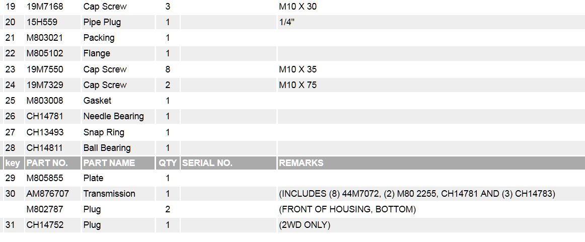

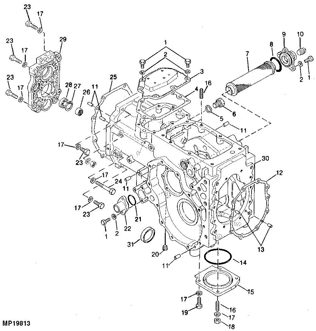

How long since hyd filter was changed and sump screen cleaned?

Pulled screen and it was clean. Putting new filter on. Tractor only has 390 hours on it. I doubt it was clogged filter as it was so sudden a disruption. Running fine put in reverse backed up a few feet then tried to put in 2 jd and it stayed in reverse with no steering or bucket hydraulics. I'm just at a loss. I pulled two pumps and they seem fine but haven't attempted to pull front end so I can get to pump. Drive shaft. That looks like a big job. Thanks for diagram that helps. Dave s
