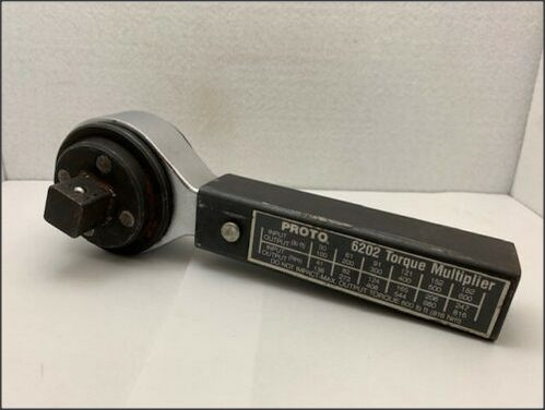

My Proto 6202A goes to just 750,3/4 drive on the output 1/2 drive on the input 227 in 750 out, but these multipliers can be dangerous if the bar that slips in the multiplier to hold it in place slips, it can break a leg or an arm.
Yeah.... But is it calibrated for tightening a nut/bolt..... Multiplier and torque wrench is more accurate than numbers printed in "poop" sheet that comes with impact tool.....
Don't understand your comment about "bar that slips in the multiplier", because mine has a pin lock to keep bar from detaching from gear head... And only place in this whole discussion it make sense to use pipe extension if bar is to short for a positive rotational stop of gear head....

Does anyone have a reasonable source for a torque multiplier with a 750 ft. lb. rating?
Thanks, Robert
I bought mine from Auto Zone, it is a 3:1 multiplier with a 3/4" drive input and 1" drive output. I believe it is rated for a little more than 2000 ft-lb torque output. It was also not made in China. I got it and use it to tighten fasteners on my rotary cutter as the manual specifically said to do it that way, and it does indeed work well.
