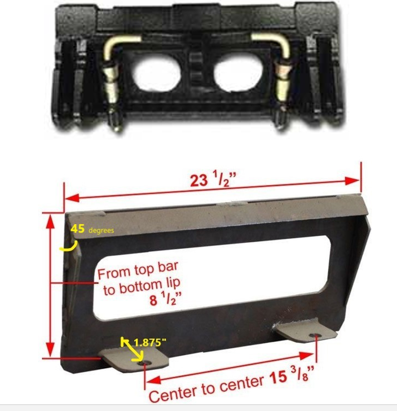

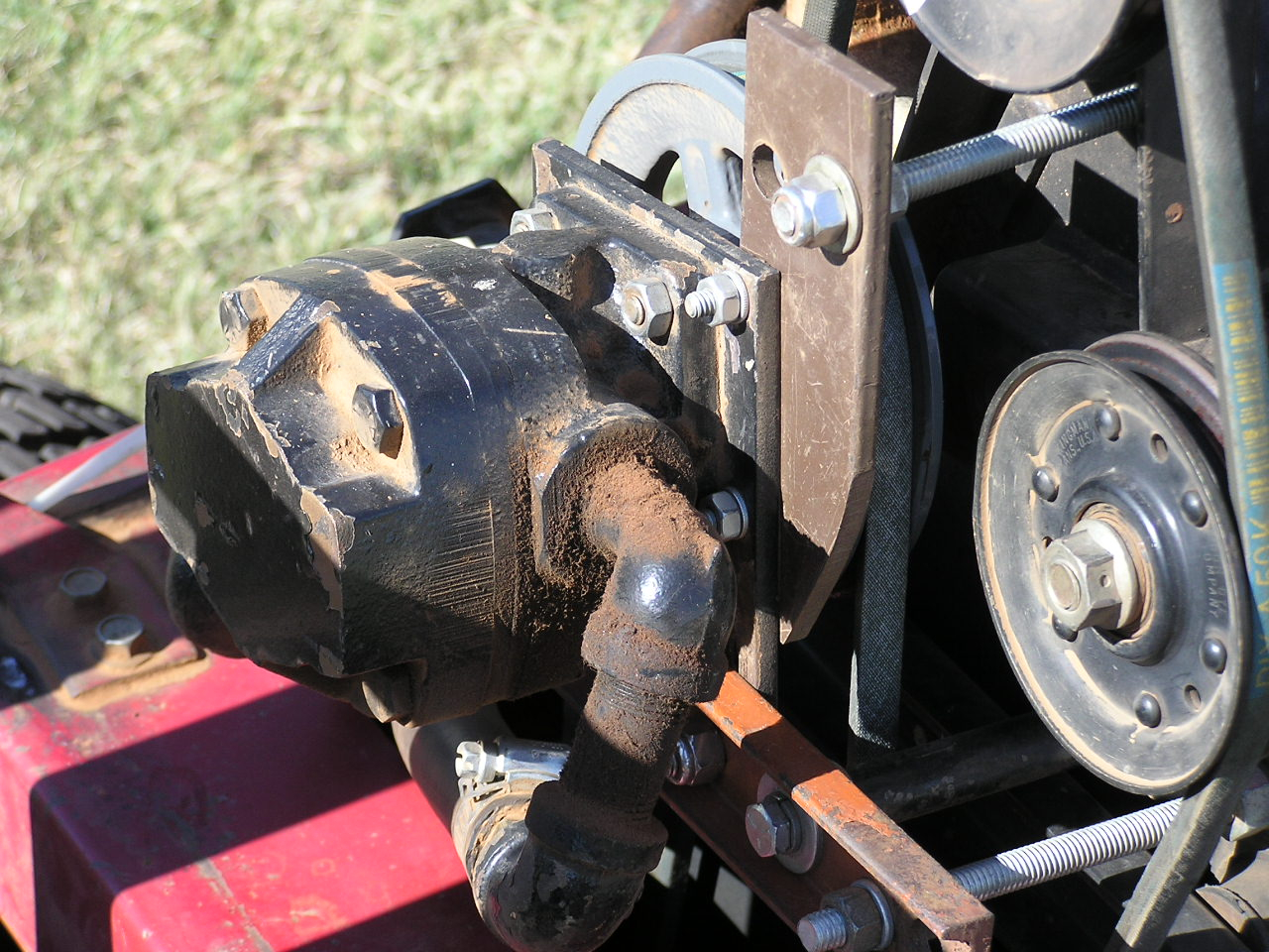

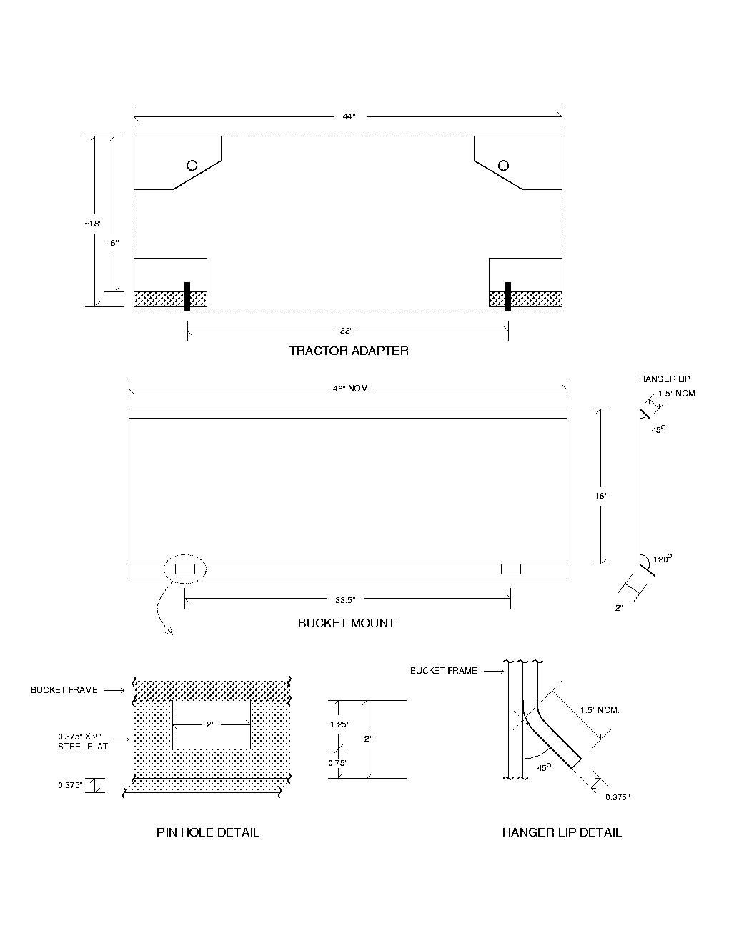

Can't help with the hydraulics since the deck was powered with a PTO shaft and I used a separate hydraulic pump on my smaller TORO:
I recommend a Skid Steer Quick Attach:
Or a Mini QA:

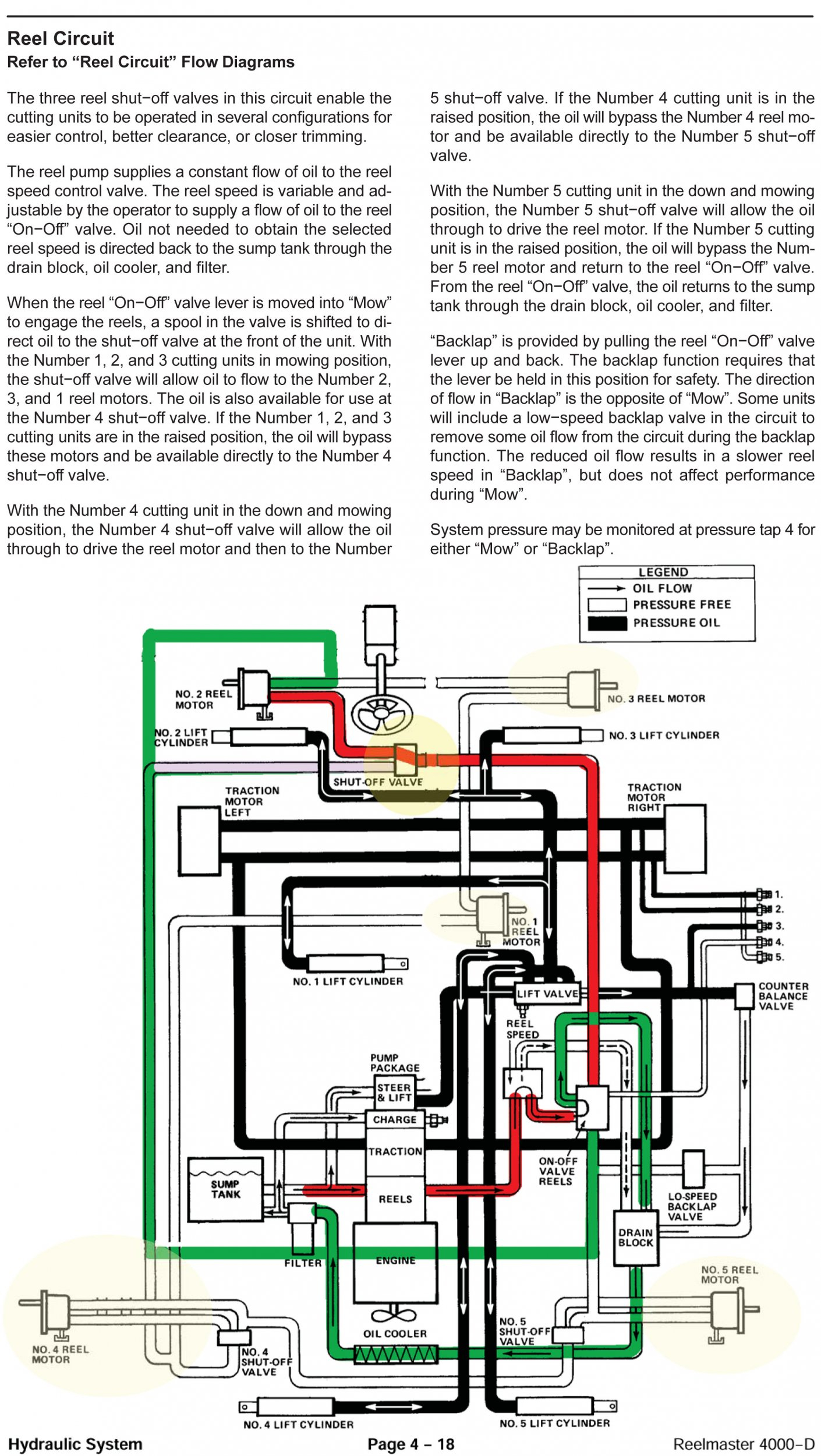

My thoughts on the "aux" hydraulic connection on the loader are marked up. Does anyone see any issues? Thanks in advance.
/ Toro 4000D Mower to Multipurpose #5
I was hoping that someone with more hydraulic experience would answer.
I think the basic plan looks good.

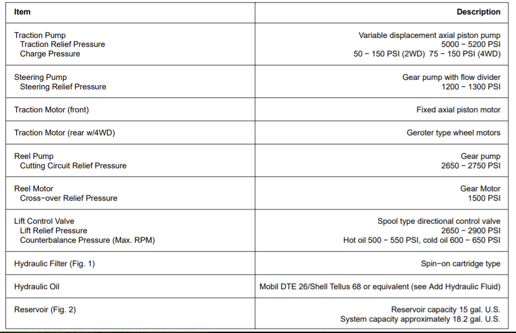

Do you have the pressure and flow ratings for the reel pump?
You may need to use a flow divider for the loader.
I think I'm going to try putting the loader on the Steer/Lift pump first and see how it works, don't have any specs on that pump - yet. The reel pump is 15 gal/min. at 2700PSI.

/ Toro 4000D Mower to Multipurpose #8
Don't know about the 4000D, But on the 300 series the steering has priority over deck lift.
That means the loader will stop moving up or down when you turn the steering wheel.
But I guess you could get used to it.

You are right on the steering circuit having priority but really want full flow on the aux circuit, it is on the low end of skid steer standard aux hydraulics. Planning to document the conversion with pictures. Currently too many projects, Ida hit us and have to replace fencing - wish it was done to help clearing trees and limbs.
