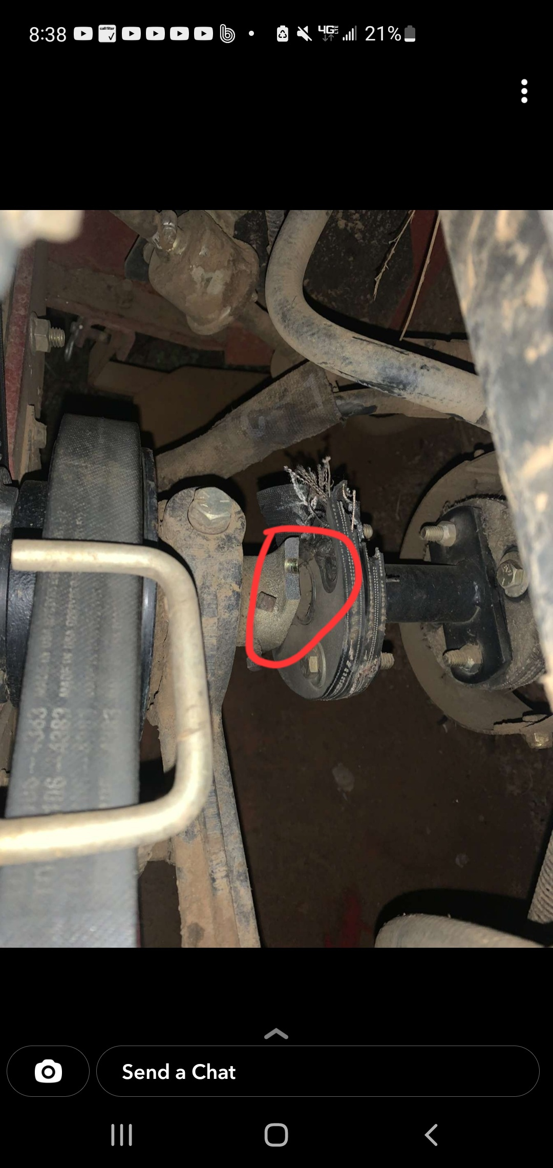

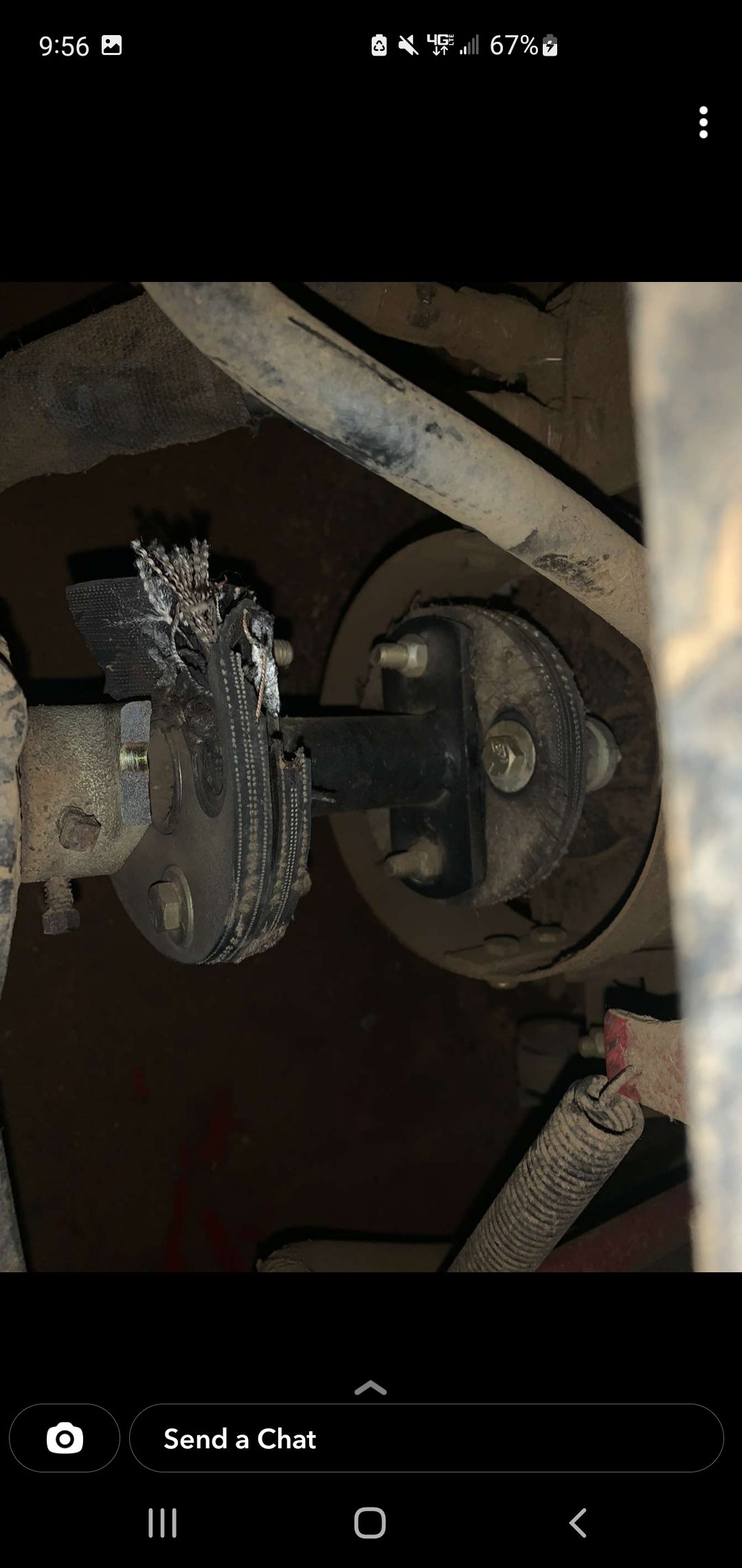

Would anyone know what this is/ how to fix this issue?

It appears to be a flex coupler, possibly driving a front mounted hydraulic pump..?? Definitely need a new yoke, and flex couple discs. If it was taken apart in the past, looks like the bolt may not have been tightened enough, and allowed to work enough to shear the bolt, and break the flange. Or, too tight, and partially twisted the bolt off, until metal fatigue took its toll, and the bolt broke.
/ Toro 328d front axle
Thanks for the info!

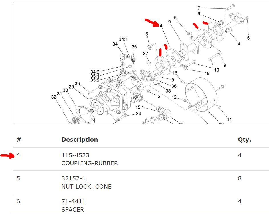

The rubber disks are in the transmission drawing:
