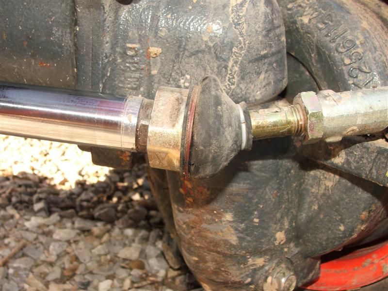

Here's pics of mine, still dirty from some woods cleanup.
Edit: Looks like the new boot has a cut, time to get out some more inner tube.:mad: Wish someone would come up with a way to put a guard on those things so I wouldn't have to think one up myself.:eek:

I have an L3830. The boots cost $10 from the dealer. When you take the tie rod off, count the number of screw turns you took when you separate the rod to replace the boot. When you assemble it back, use the same number of turns to screw it back together, then tighten the locknut. Your toe-in will stay the same. By the way...your boot looks like mine. I think they DO have replacement boots for your tractor. The boots are made to be replaced. Make sure you clean up the knuckle good and regrease, before putting on a new boot. And...by the way, better buy a couple boots since you will only tear another one up in the near future.
After tearing up a couple boots...this is what I did. I got pretty good at taking it all apart and putting it back together, again. I cannot understand why they make these tractors so delicate! They should have better protection...

Follow up:
I unthreaded the tie rod adjustment from the outer ball joint after measuring the distance from the lock nut to the edge of the machined and threaded part plus I counted the turns to unthread the tie rod.
I had an extra 26" mountain bike inner tube lying around and it is a nice tight fit over the large end of the existing tie rod boot. I cleaned everything up, worked some good synthetic CV joint grease into the joint, and used the inner tube to create a second boot over the original torn one.
Pics of finished product are attached.
Thanks to all for the hints and suggestions. Saved me $47 bucks for now and I bet this tie rod joint will go many more hours before needed replacement.
