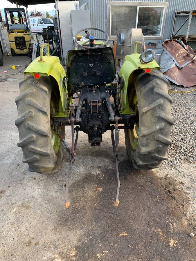

Rusty oil filters are never a good sign. It's a sign it was " stored 5 years" outside!
That Craigslist Yanmar doesn't look any worse than mine did/does! I was told the same thing, but mine looks more like 10 years outside. it isn't any prettier today but that doesn't seem to affect operation. I don't understand how someone can neglect equipment like that.
I don't like the torn shifter boot on the CL Yanmar. The transmission needs to be drained to get the rainwater out! I see its also missing the right sway chain. I hope nothing else was scavenged off it.

It's from a Craigslist ad in southern Oregon. (YM240 stored 5 years. Cranks, won't start, destroyed the starter trying. $1400). That's not a bad price for someone who wants a project to tinker on.

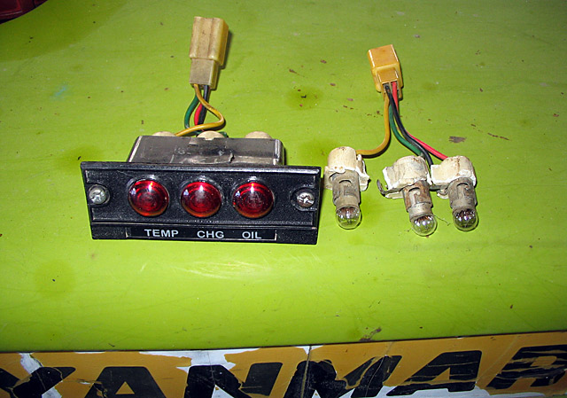

I took exactly that gamble when I bought my YM240 in 2003. The seller just barely got it started as he ran a good battery down to weak. Dashboard warning lights were dangling by my knee, fuel filter assembly had been discarded and replaced with what was likely a lawn mower filter. Both headlights bashed out. Left brake stuck when pressed, I nearly looped in a circle when I demo'ed it. Every bolt on the tractor loose, it squeaked and rattled as it rolled along. The front wheels were cracked! I can't imagine the abuse this tractor has seen.

Yanmar quality is excellent, simply catching up all the ignored maintenance is likely (not certain!) all that thing needs. If it were me I would carry over a fresh battery and fresh fuel and try to get it running to verify no major problems. Hopefully the next owner's experience will be as good as my experience with that model Yanmar.
802253-img_5916rym-dashlights-jpg.49339

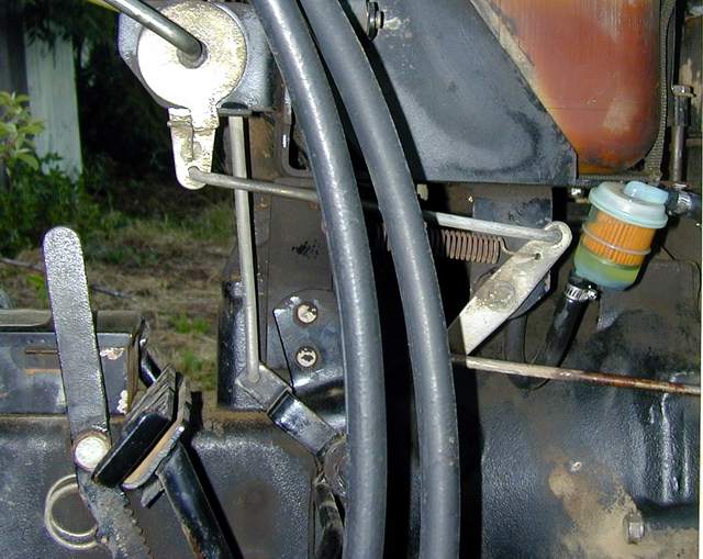

Fuel filter the good ol boy American farmer had substituted. I don't know why he discarded the old assembly - the filter element is listed by Wix etc.

OEM fuel filter assembly from the VN 'rebuilt' vendor (had wrong fuel bowl) and the correct US bowl and element from Hoyetractor. Under $50 project.

Hopefully the new owner of that CL Yanmar won't have more to deal with than I did. If he's lucky it is fundamentally sound but severely neglected and a little tinkering will put it in service.
