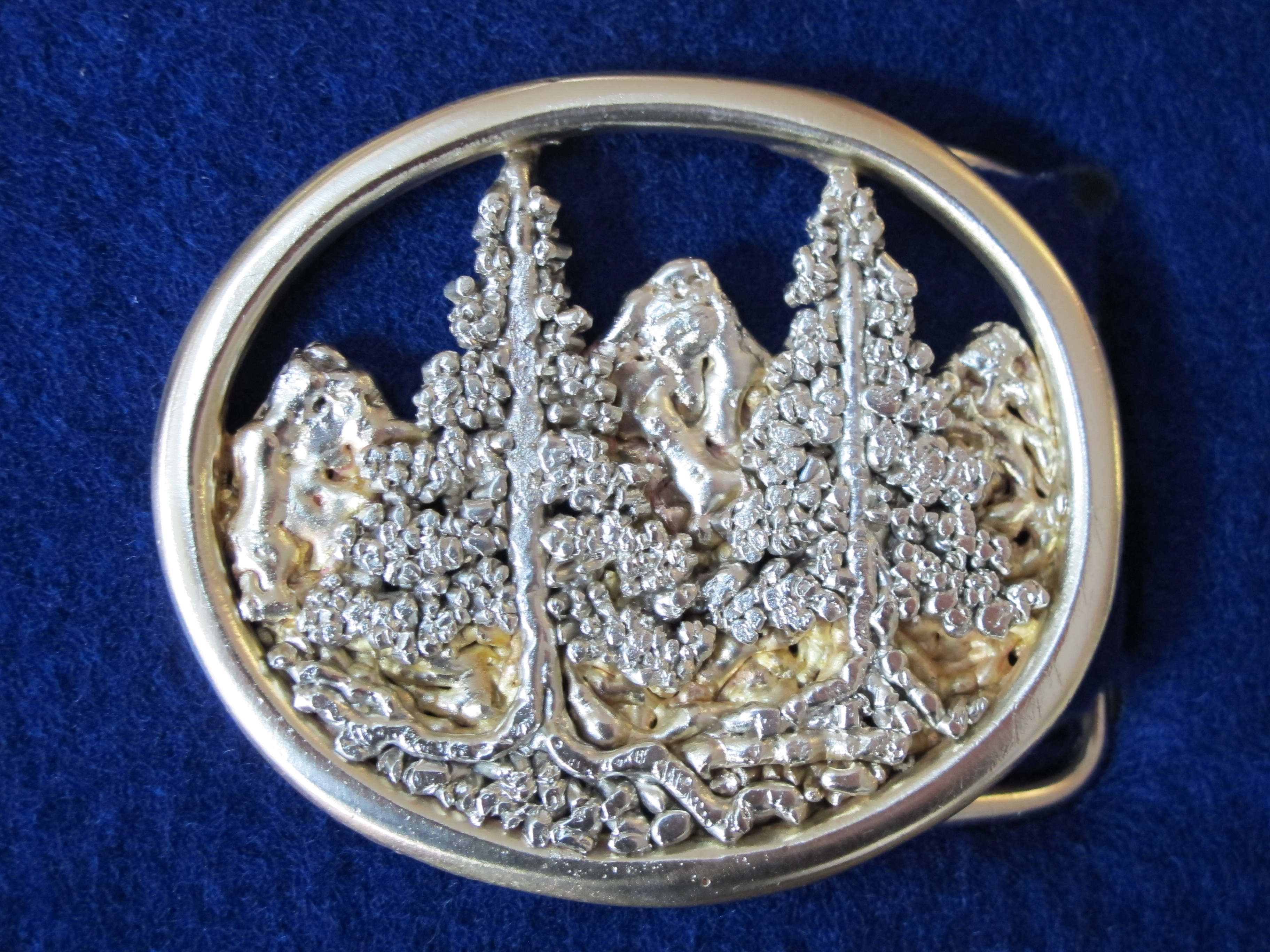

I'm pretty good with the torch and with using careful heat control in traditional metals like steel, brass, & bronze. Here's a sample that's about 1.5" tall - measured inside the ring.
The plan for next week is to play with some aluminum and see if it can be made to work as well. It ought to be fun; don't know why I've never tried aluminum or stainless before.
I'm grateful for any and all hints - and thanks for the links to the videos.

Yeah! I will say "pretty good" too! And then some.
Dang, you are an artist with a torch. :)

Looks cool, what metal/s did you use for that piece?
