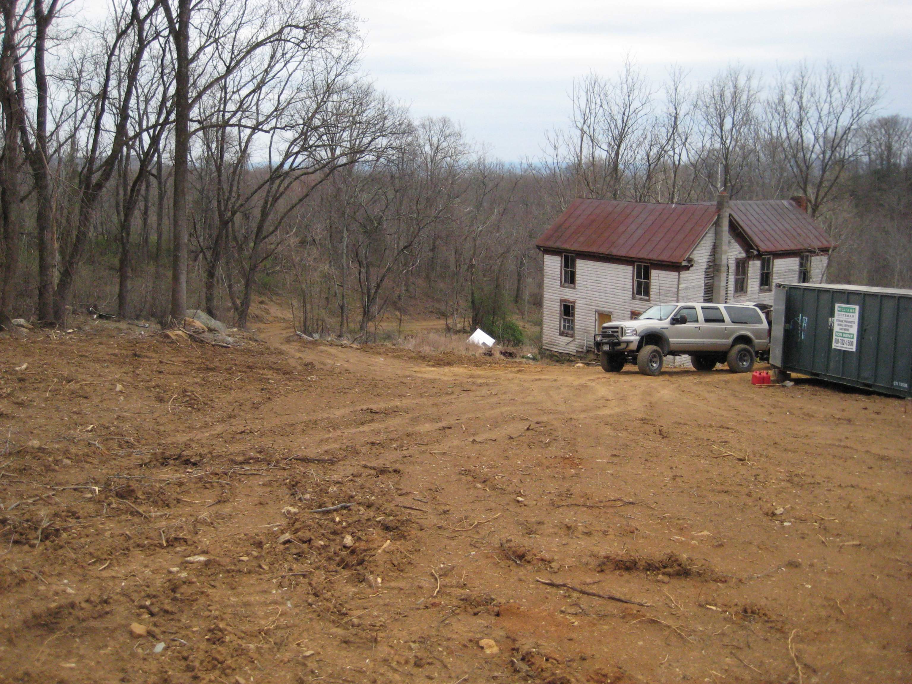

No that was a rental I used when I was clearing the property. I also used it to move my 8' x 20' shipping container up the logging road and then my access road to set it on my property. It also was handy to tow my 30' camper up to the property. I unbolted one of the loader bucket teeth and bolted a 2" receiver hitch to the bucket. It was slow going but I was able to park the camper exactly where I wanted it. My 1 ton SUV could have towed it up the mountain but parking it exactly where I wanted to might have been another thing.

Picture 3 is pretty impressive. :shocked:
We used to move loaded containers from the side the same way with big rough terrain forklifts. Just fork it from the side and run two chains to the top corners on the same side. Just make sure you're using 3/8" chains or larger.
