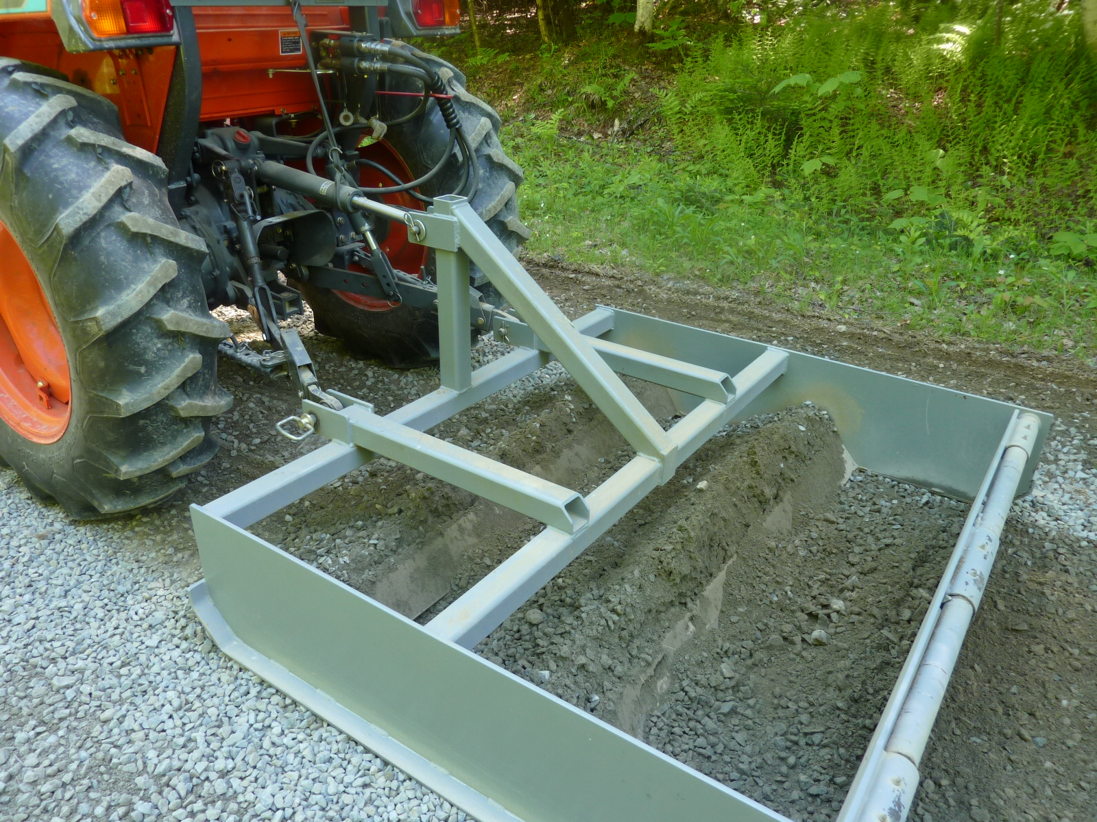

To answer your actual question Top or Tilt first. My choice would be Top. For me it is the most useful. If you are running an angled implement like an angled rake or rear blade you can control the tilt with a Top Link. Set the top link so the horizontal shaft or boom (not sure the actual name) of the blade is parallel to the road when you lower the blade. The blade will be parallel to the road surface when straight and at any angle. If you shorten the top-link with the blade angled at 45* to build a crown the ditch side of the blade will drop and the driver side (road center) will raise giving you a crown cutting angle, cutting more on the inside than the center.. Lengthen the top-link and the opposite happens.
And with a box blade it is all about top-link length.
