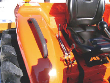

The first thing you need to install is the remotes.
Kioti has a reasonably priced remote valve package for the DK 35.
The control valves for the factory remotes will be just to the right of the seat near the position and draft control levers.

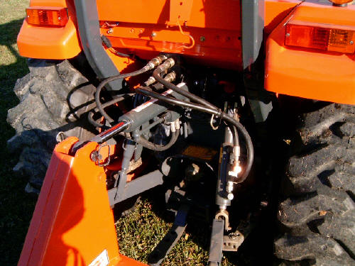

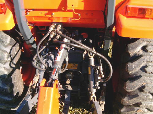

I use the CCM top and tilt cylinders w/check valves on my DK 35.
The top link was a simple bolt on (no modifications).
I drilled an extra pin hole on the clevis of my tilt cylinder to shorten up the closed length of the cylinder.

I like the placement of the two controls. I envisioned them mounting to an arm off the ROPs. Can you educate me on what a check valve does? Apparently cylinders can come with/without these check valves.
Vince: If I understand correctly, I get the remotes from Kioti and the cylinders from another source? Do I need to purchase hydraulic hoses also or do they come with the remotes? Can you tell me the dimensions of your cylinders and if you are happy with them or would change anything?

Got a few measurements..
My hydraulic top link
2" bore
21" closed length ( pin center to pin center)
I believe it has around a 10" stroke or 31" extended length
Hydraulic side link
2" bore
17" closed length (pin to pin)
5" stroke
