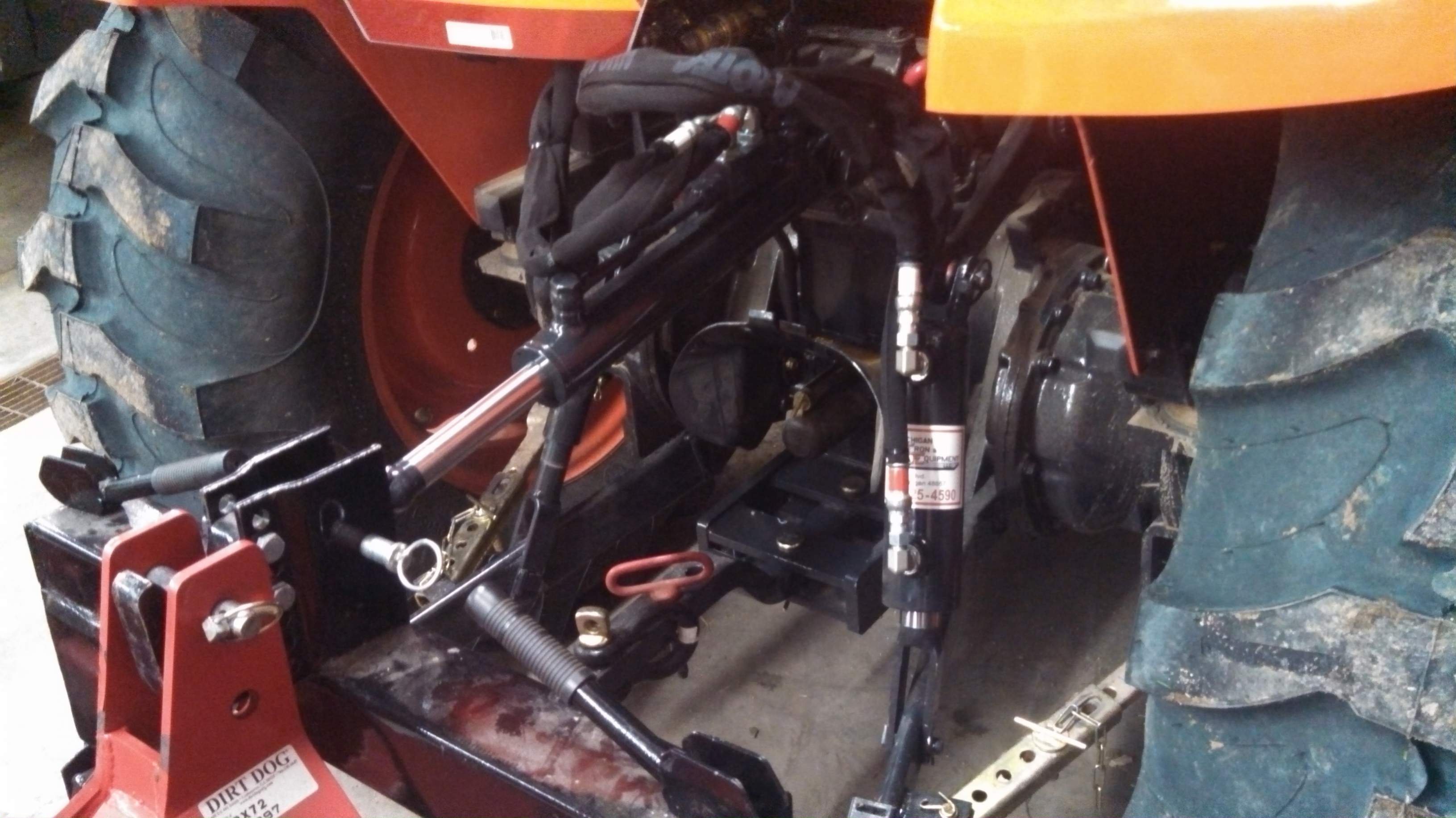

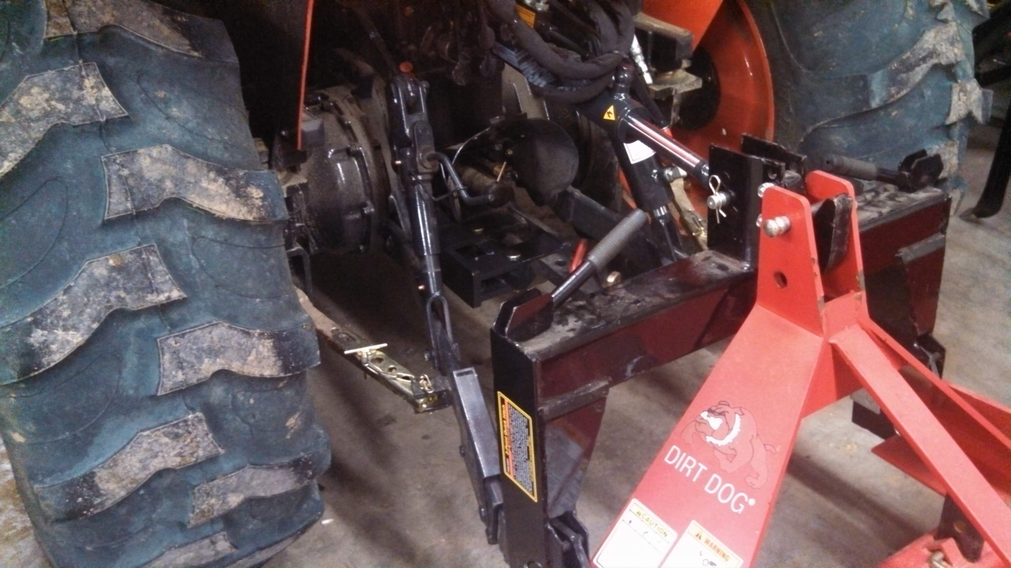

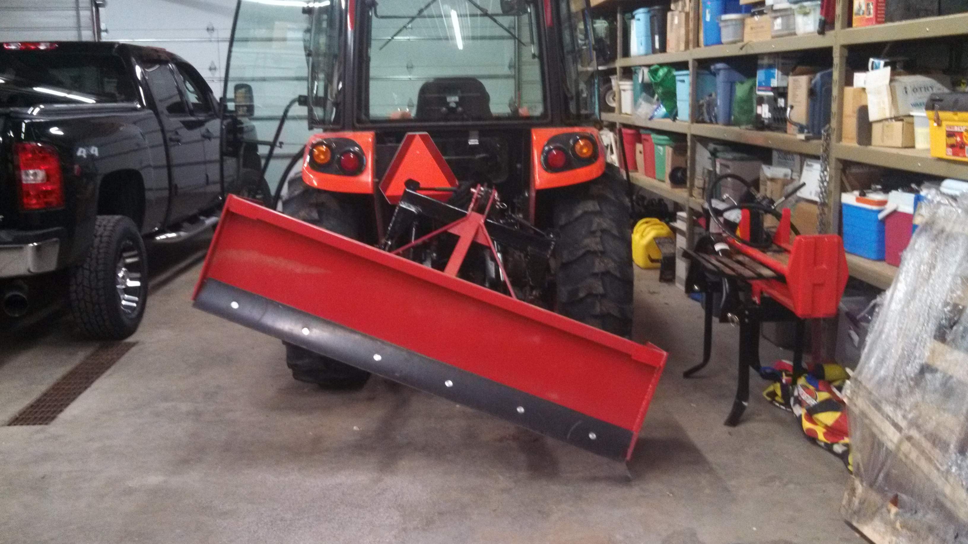

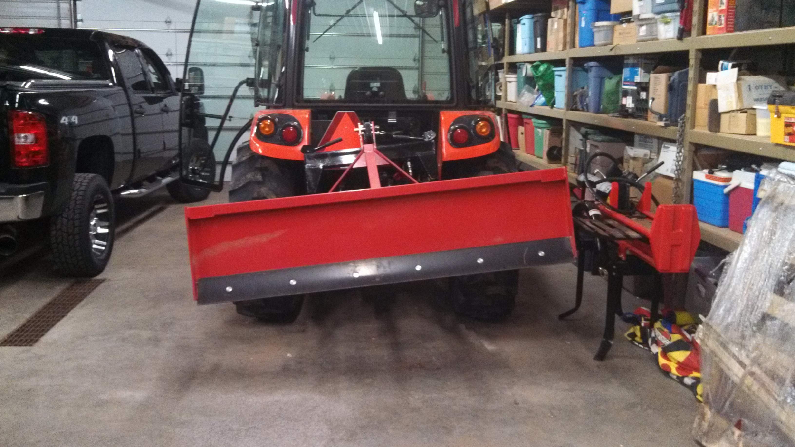

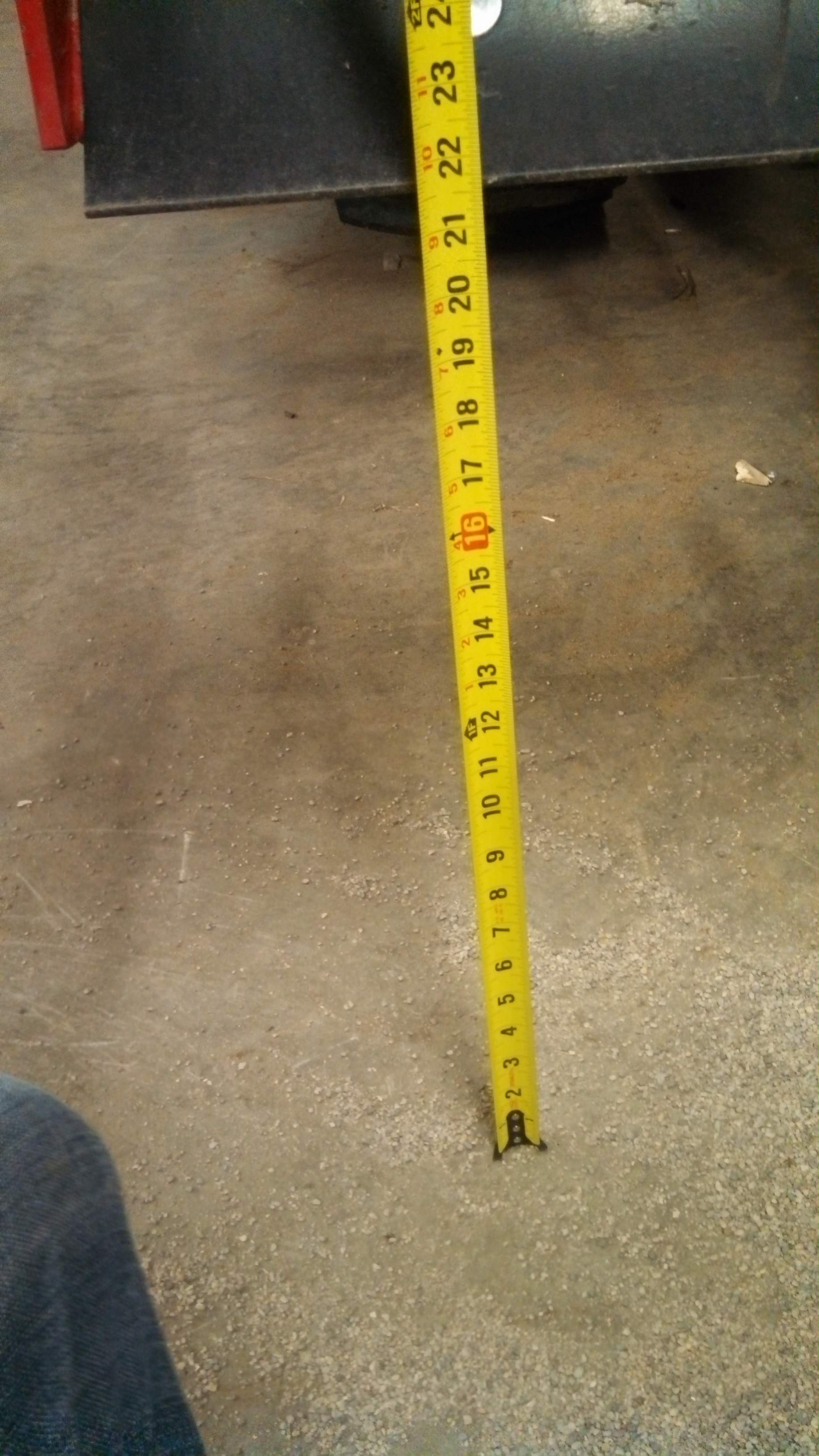

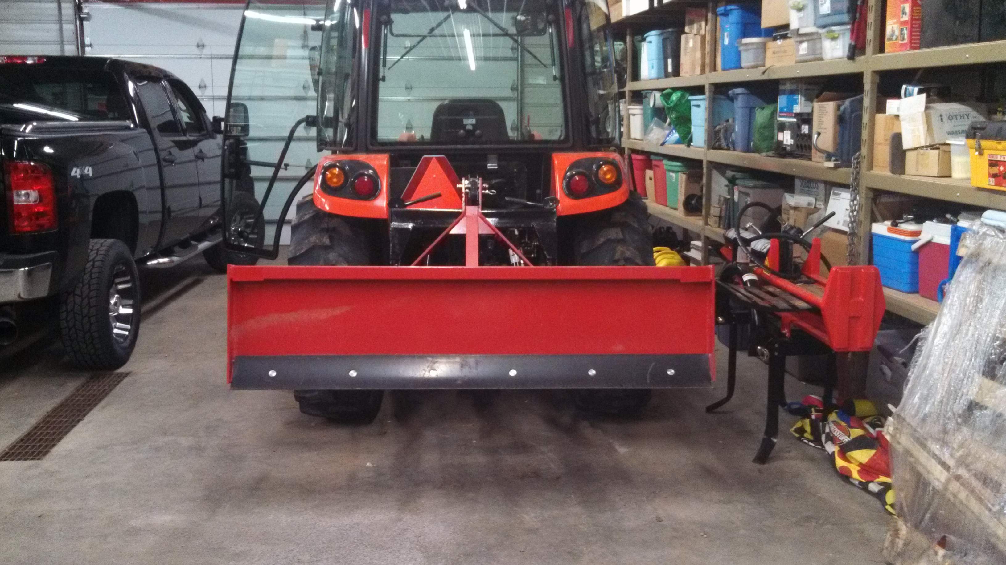

Ok, I got home & moved the right hand 3 point arm to the left side, so now I have adjustments for both sides. I installed the box blade & lowered the left hand side (manual crank) a few turns. I now have some drop for the left side, a ton of drop for the right side, and 21" of clearance when level and raised all the way up. You can get a bit more clearance just by cranking the left side all the way up, but then you have no adjustment to drop the left side. You can also get a lot more left side drop but sacrifice some overall clearance, as Brian pointed out earlier. All in all, I'm pretty happy with what I see.

I like the kit, and the only thing I would change is the top link hyd line fittings to the right side from the left side. Here's why: I have two sets of remotes in the factory bracket and what I found, by chance is the top link, when raised high enough will allow the elbow of the 90 degree fitting at the back of the cylinder, closest to the tractor seat, to disengage the lower QD on the second set of remotes. The solution, IMHO is to flip the top link 180 degrees so the hydraulic lines are on the right, instead of on the left. I haven't done it yet, but when I remove my backhoe I will try it with the lines on the right and see if that cures the fluke interaction between the QD and the 90 degree elbow on the top link.
