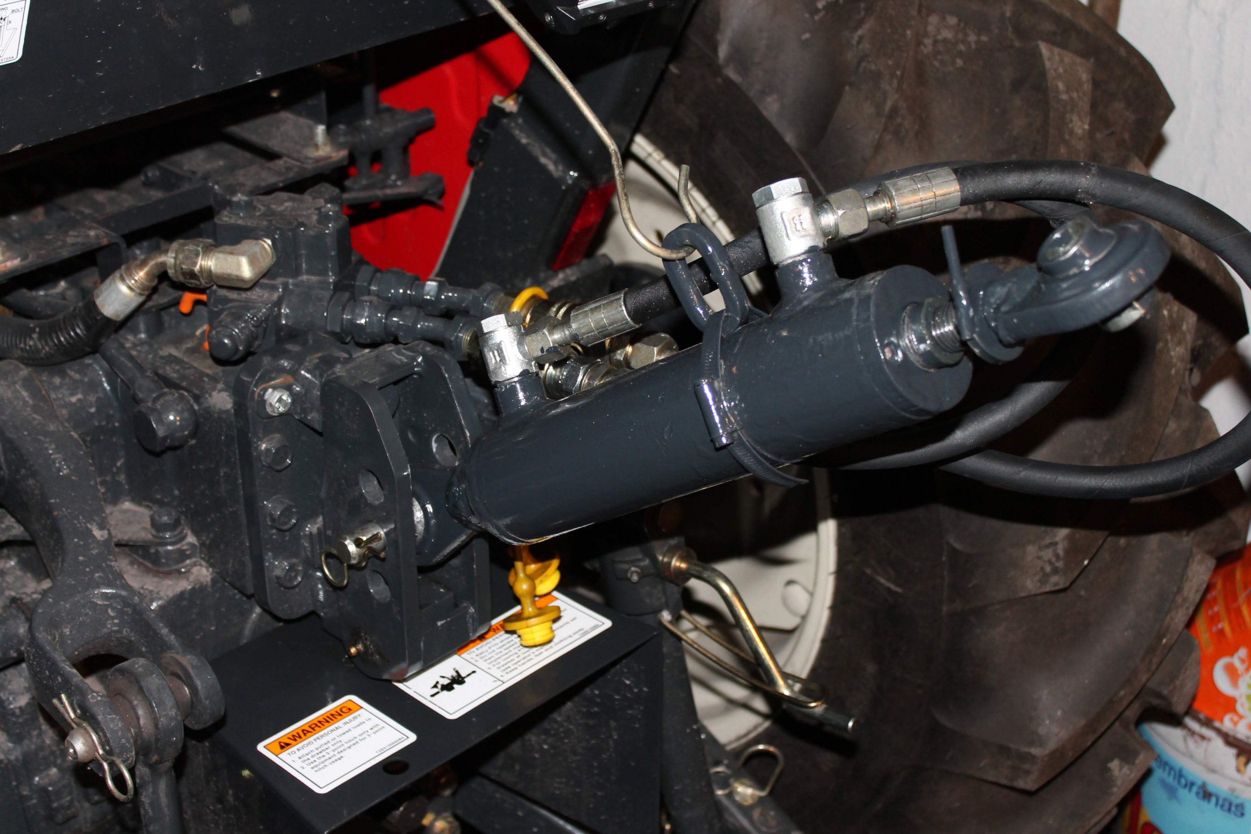

I just hang my hydraulic top link on the original hanger for the mechanical top link.
I built the hydraulic top link myself and just added a link of chain I had laying around and a big hose clamp to hold it place. I'll probably just weld the chain link on the barrel when it's time to take the cylinder apart to change seals.

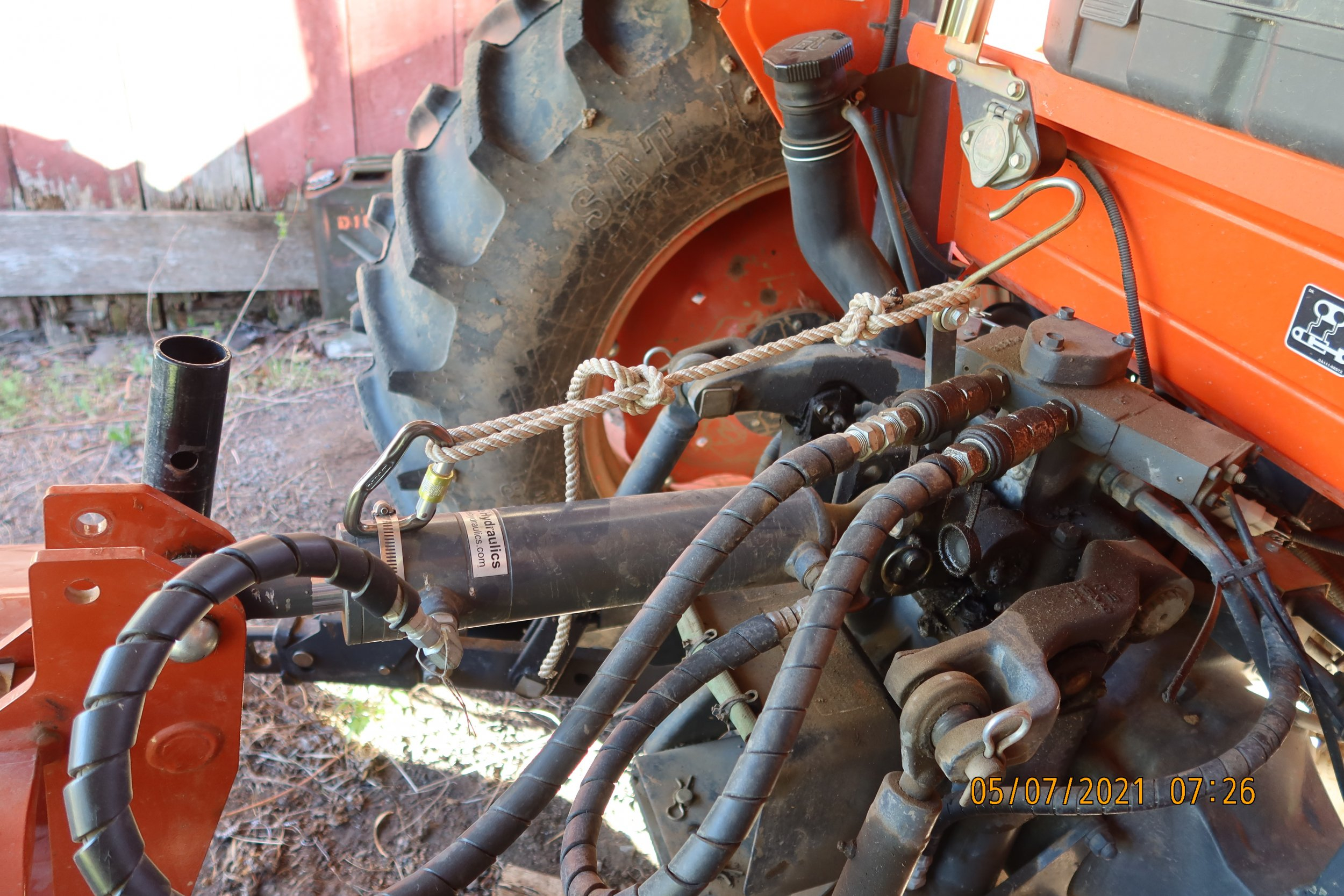

Yes - Thunder Chicken - at first, connecting the hydraulic top link was a PITA. Back/forth - longer/shorter. Then I had a brain fart. Rope around the cylinder and tie off to the clip that held the "Slow moving vehicle" sign. Hold the heavy 'ol top link up. Then up on the drivers seat - looking back over the seat - activate the lever until the hydraulic top link end slips into the connection on the implement. Just as "ptsg" has done - only with a rope.
I REALLY like the way ptsg has attached the single link to the top of the cylinder. I'm going to do that today. Pure genius.
I ALWAYS have something on the 3-point - usually my rear blade. Moving between implements and connections - the top link is held up with my rope.
   / Top Link ? #45
OK - so I had a heavy duty carabiner handy. Allows me to have a loop, already adjusted, on each end of the rope. I might have to go higher on the tractor end of the rope. So it's not such a straight pull. Time will tell.
Thanks for your picture - ptsg.
