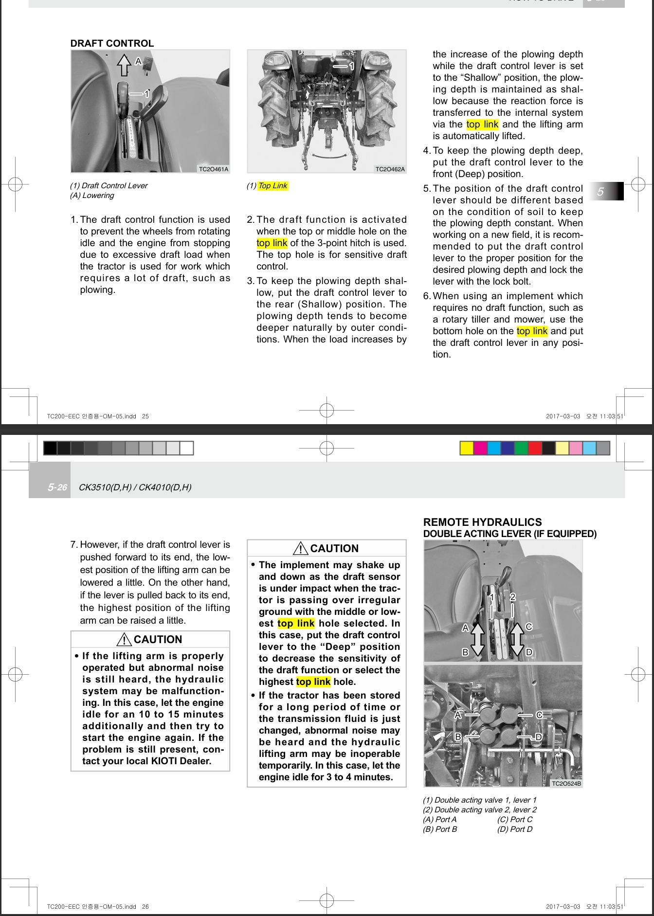

This is what Kioti says:
I understand now. Which is why I wasn't seeing any benefit of the draft control when plowing. I had the toplink in the bottom hole. Same as my tiller that I use 30% of the time, 60% for flail and 10% for plow or disc.
I need when plowing to use the top or mid hole for the toplink. I guess I wasn't ready to understand it when I read it several years ago.
Only think I have used the draft control for successfully was to stop the tiller/BH from bouncing/dropping down when on the road between plots.
So if I were to use the box blade, would the draft control help that at all? Yes equals top or middle toplink hole, no equals bottom hole.

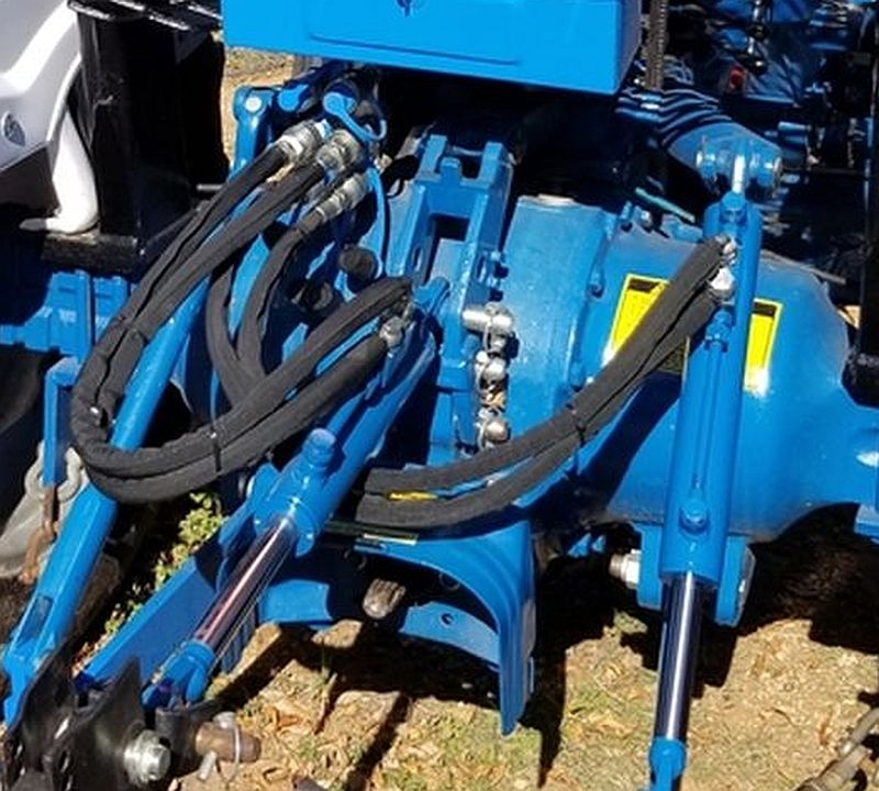

Perhaps but maybe not. My Ford has two positions. My top link is on the lowest to pick up an extra ~1 1/2" of cylinder movement because of the quick hitch. The position below that is a lock and below that is the pivot. I keep mine locked. I don't plow anymore and don't have a PHD. No need for Draft Control.
