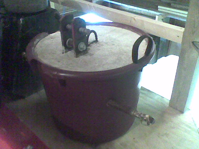

I am having my JD weight box filled with cement in the next day or 2.
Once the cement has firmed up can I lift the box out of my truck by hooking onto the top link pin.?? How big should the pin be.??

Depends on how the mounting for the top link is, and how heavy the box is. It may be possible if not too heavy. Just use your common sense! It will lean over when you lift it, but you will be able to get on ground. Why not just fill it will concrete on the ground? Use the biggest pin that will fit the whole.

The pin can only be as big as the hole. Which if it is for a cat1 hitch, then I'm pretty sure the top link pin is 3/4". Never use anything smaller than that. It might be better to cement a handle in the top for lifting. Bend a piece of heavy rebar or solid pipe into the shape of a "U". You may even want to flare the ends of the "U" outward as well. Once the crete is poured, then stick the "U" upside down in the crete, leaving a loop exposed. Make sure you leave the legs of the "U" long enough to really get down into the crete. Then you can use the handle to hook you chain to while lifting it.

You should be able to buy a 4' piece of rebar at your local home center and bend it into shape, I would use 1/2" rebar which is a commonly available size. I would do this sooner than later as the concrete needs to set for a week or so (depends on how cold it is and how thick) and could be curing for you during the holidays. You only need the concrete to cure fully if you are going to use the rebar to pick it up.

Rebar goes in 1/8" increments so a 4 is 1/2" 6 is 3/4 ...
I've picked mine up by the pin, it's at least as strong as 1/2" rebar which often fractures under the stress of such a tight bend instead of rebar hook for that one time you need to get it of the truck I'd rather see you put some pipes in for tools.
Also mine only took 6 x 80 lb bags of concrete mix, leaving about 3 inches from the top, you could mix that right in the box in 20 minutes. It doesn't have to be a perfect mix, it ain't going anywhere and your not stripping the forms :) you couldn't mix in the box if you were putting pipes in, but it is only 3 x 2 bag mixes in a wheelbarrow.

I put a 3/8" re-barb lifting ring in the middle. It works perfect. You can see it in the picture. Its welded on each end just for good measure and to keep it steady while filling with concrete to the lift pin bar.
