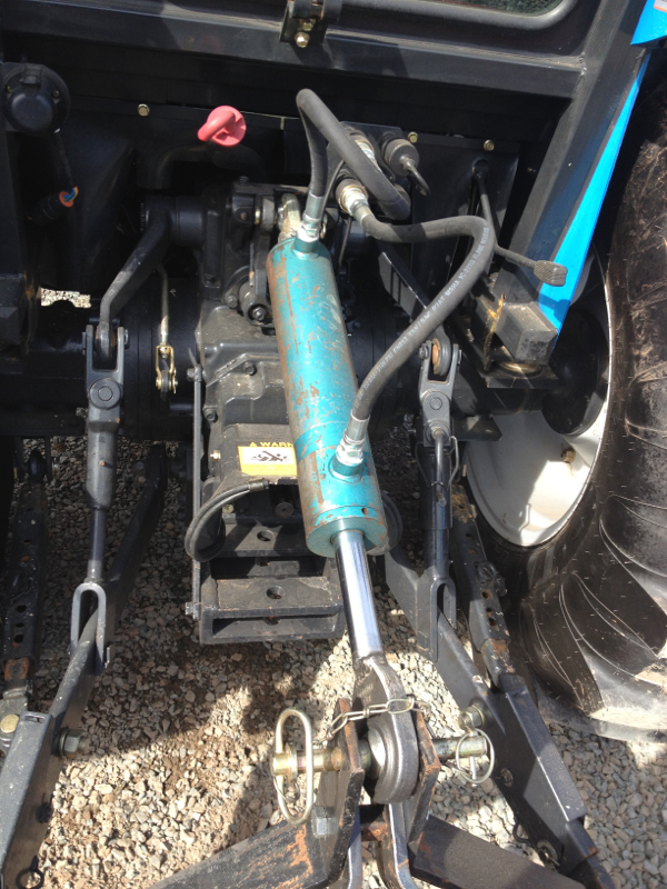

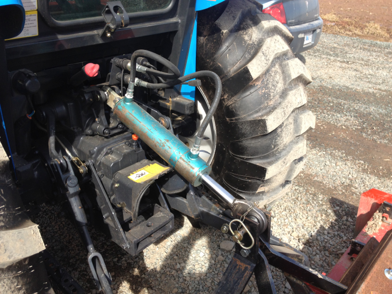

I'm getting a new Landini 1-55 this week and want to pick up a hydraulic top link for it. Can anyone give me a suggestion what length range/stroke length I should get? It should be the same as a dk55 I believe.
   / Top link for Landini 1-55
That gives me a good enough reference I think. In going to pick up a cylinder at my local princess auto and just weld on the ends. I'm going to aim for 20" retracted and a 10" stroke. After I get it done I'll post pictures if I don't make a mess of it :)
So I found a cylinder in the attic of my fathers' garage so that was a freebie! Bought some ends and hoses, then a little welding and presto! Still needs paint but works awesome!
