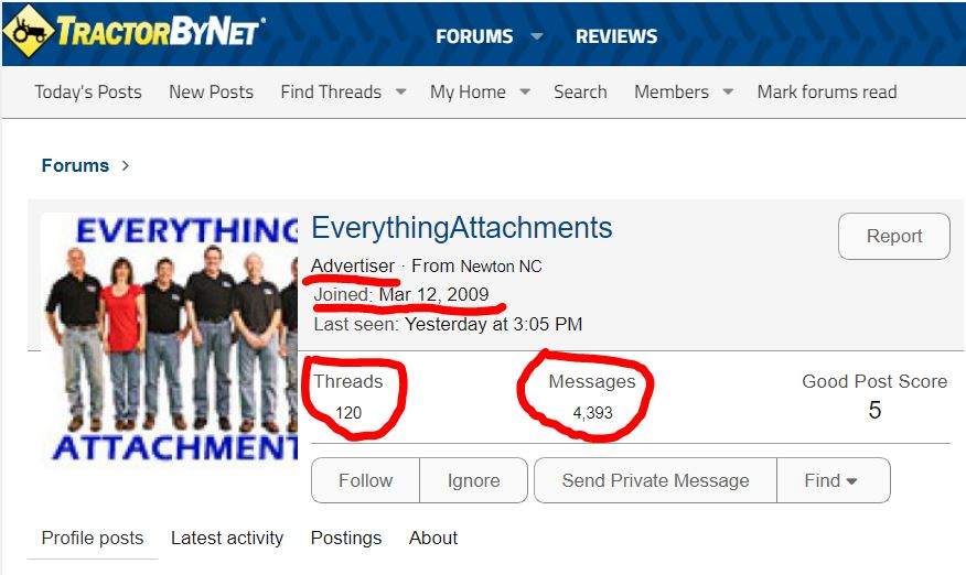

I was being sarcastic since they are a site Advertiser and very active here on TBN:
Have you ever seen threads and posts by Travis here on TBN?
Here is one: New EA Land Plane(LPGS)
