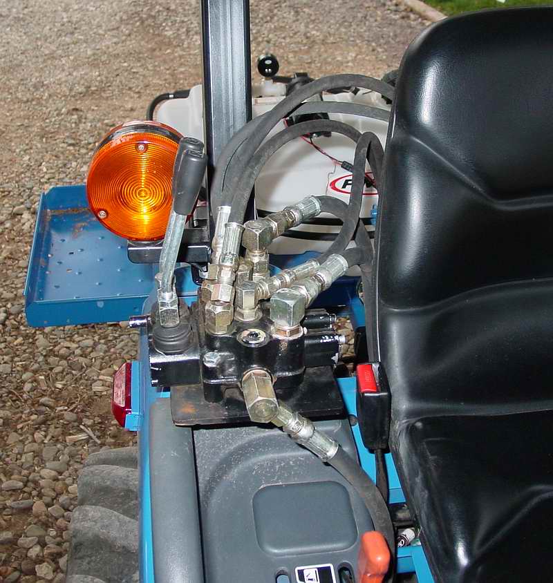

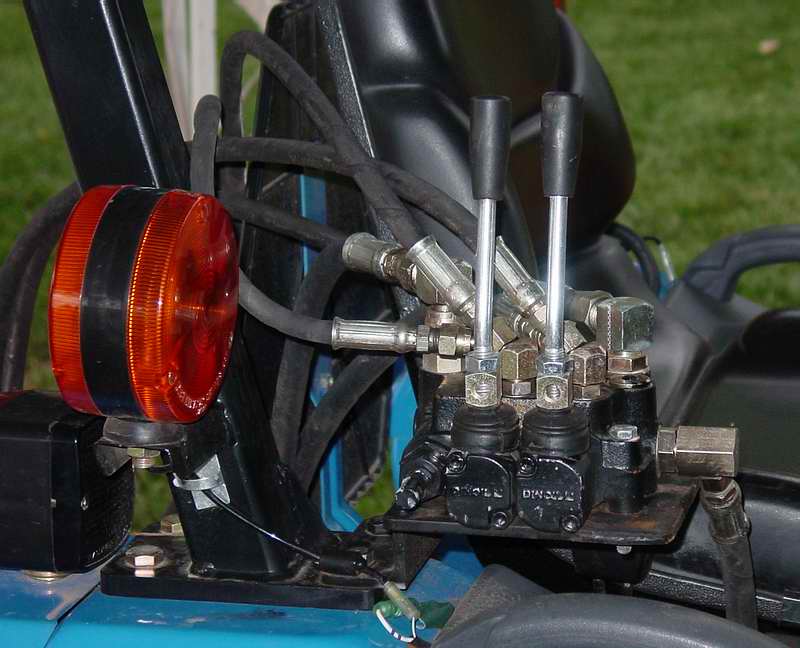

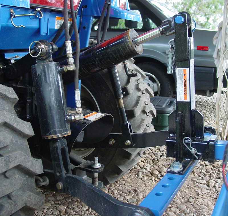

Here are some pictures of my TNT setup on a TC 24D
PIX 1
   / Top and Tilt #23
PIX 2 of 3
   / Top and Tilt #24
PIX 3 of 3
   / Top and Tilt #25
The pictures I posted show my TC 24D with TNT. I added the crank from a T33D on the other side. It comes in handy if I have to make a quick correction without having to switch the cylinder to the other side. The pictures also show the Three Rivers 2 inch receiver hitch system and my custom mounted Fimco 12 volt pump sprayer (a work in progress).
Oh and yes I would say I am in the TNT camp, in fact I graded it! I will try to post some photos of my handy work showing how useful the TNT system can be. I have created terraces from steep hillsides and I really do not see how it can be done by constantly jumping off the tractor to adjust and then to backfill jump off again to readjust. It just would not happen that way. Also here is a FYI on the stock crank or turnbuckle link. it does not have the range that the stroke of a Hydraulic cylinder gives you.
Yeah a FEL is tops over TNT but it should be right next in line to a box scraper. But then again I really think that people have different needs in different areas.
George
