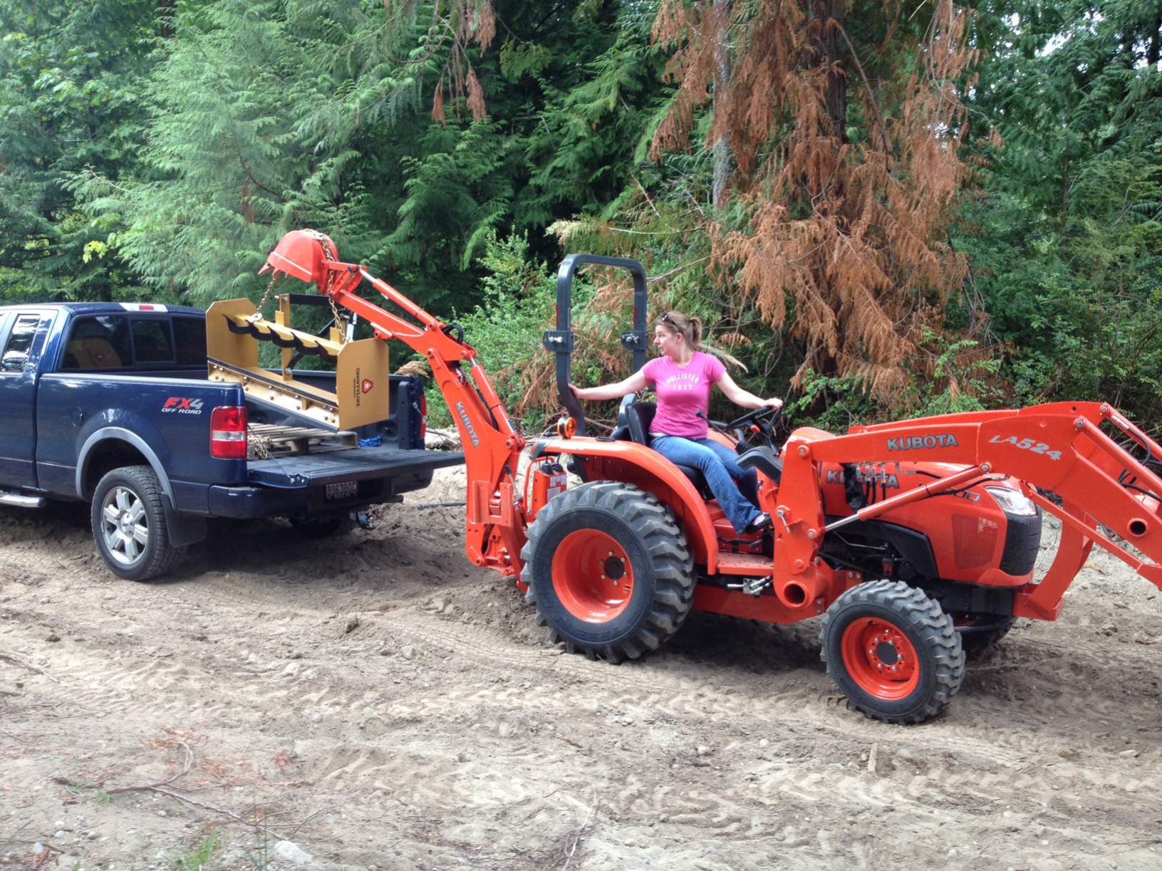

So I have been doing a lot more research for the top and tilt kit, and also for the third function on the front of the tractor, because I want to use with for clean up.
First thing is there anyone that has added solenoid control valves for their top and tilt kit??? It seems to me that it would make the cock pit area a lot cleaner. With all of the controllers that are available from Scorpion technologies, it seems to me that you could put the top and tilt controls on the front bucket controller handle also. has anyone done this??? Any pics and or advise would be greatly appreciated!!!

I did it for a guy in Texas. In fact he went with a 3 remote setup. Had a knob done for him with 3 button switches instead of the grip so that it still looked stock. :cool: If you use the grip,(which is what I would do) I suggest bending the loader control lever up to get the grip vertical, otherwise the buttons will not be easiely used in my opinion. ;)
