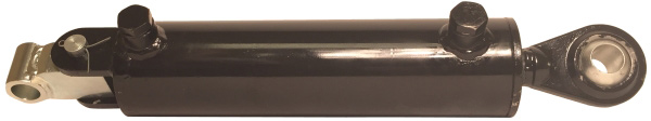

I measured my CT2025 top link lengths yesterday and it seems to me that it is sized poorly for the tractor. I took the following measurements with 3pt at about 6 because it put lower link level with tractor so I could use it as reference for quick hitch angle (didn’t have flat ground to park on):
Minimum 18 3/4”
Maximum 29 3/4” (approx because no stopper to prevent link coming completely apart)
Quick hitch 90 degrees to ground 22”
From level implement there is only 3 1/4” of travel to tilt top forward and 7 3/4” to tilt it back.
Shouldn’t this be more centred? It’s like the top link was sized for longer lower arms.
The down side is that I can’t get very aggressive with a box blade and looking to the winter I won’t be able to reduce the aggressiveness of a rear angle blade while plowing snow on gravel driving forward.
Anyone have different experiences with this? I’m trying to decide on the length of a hydraulic top link.

I normally provide an 18"-25" working length. You can only do so much with a single stage hydraulic.
Based on your 22 1/2" measurement I would say that it should be 18 3/4"-25 3/4". :unsure:
I believe that the manufacturers have a habit of using the same link for several different size models providing less than ideal working lengths. I see this on both top & side links.
I have seen it as bad as that you could get ZERO forward tilt with the top link fully collapsed. o_O

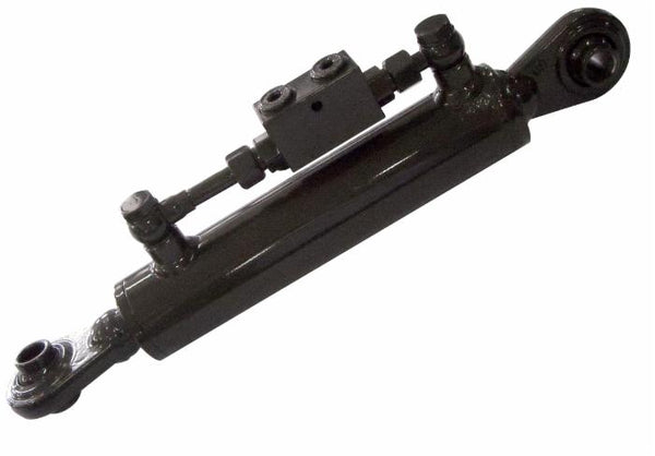

Did you end up getting one with check valves? I'd like to pick up the top and side link for my machine in the near future. What size hose did you end up using for connections?
   / Top and tilt for CT2025? #29
Just recently added the top link and I did buy one with the check valve included. It is working great so far and I’ve experienced no drift of the cylinder.

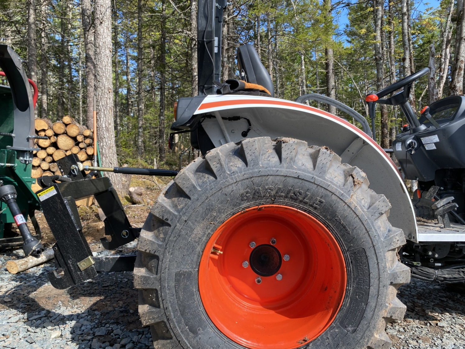

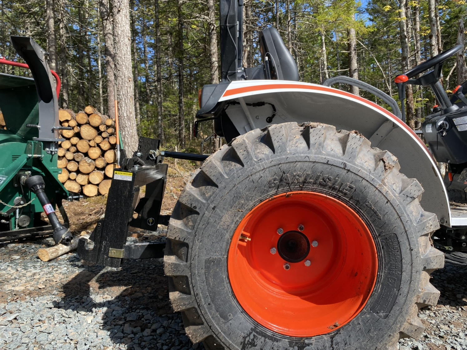

I have the backhoe and have discovered the clearance is tight and requires further customization of the tilt cylinder. I would go with what Brian at FitRite Hydraulics has suggested as a solution, but I want to do driveway grading with it sooner so I’m going to pick up a standard 2” cylinder and clevis ends and bring the parts to my ship when I join next week and attempt the modification myself.
I may end up ordering from Brian, but we’ll see how it goes.
EDIT: just realized I didn’t answer your question. The cylinder had 3/8”NPT male adaptor so the hose was 3/8” with female 90 degree elbow and swivel on one end. The other end I had made with 1/2” NPT because Bobcat’s remotes are 1/2” quick connect and need the larger thread to attach.
