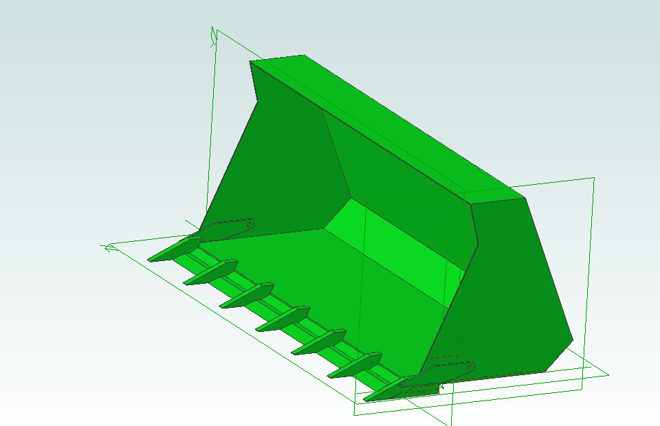

Thanks for the help guys. I'm having my own design cut out at the shop tomorrow from AR-400. This is the stuff they make excavator cutting edges out of. AR means abrasion resistant and it's tough as heck!
Here's a 90% accurate mockup picture. I took some ideas from wr long and tried to size it appropriately to my tractor.
