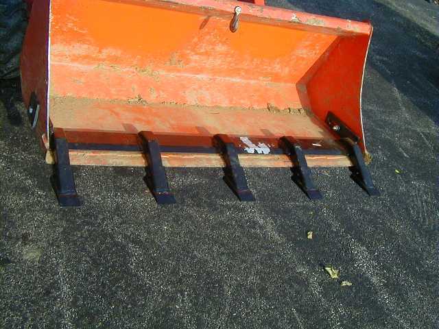

MFL,
Got the Markham toothbar for my loader and the bolts that hold the bar to the sides of the bucket are 1/2 in. no need to cut anything, just mark and drill hole. Those toothbars from Markham are HEAVY /forums/images/graemlins/laugh.gif

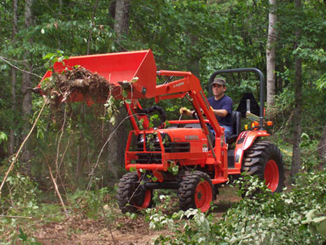

Melville,
Looks like you have all the info you need to contact Markham. Just as an update, spent most of Saturday clearing out a 30x30' space in the woods behind the house for my new storage and work shed. Cut down 11 good sized hardwoods and cleared the underbrush. Even though the serious roots are waiting on a friend with a dozer, I pulled our roots and stumps and dug out saplings I NEVER would have gotten to without my toothbar!!! /forums/images/graemlins/laugh.gif It's the difference between using a butter knife and a steak knife! All this and I hardly scratched the paint on the Markham bar. The thing is rock solid!! Hope the folks at Markham were able to help you. Keep us updated and post some pics when you improve your CUT's grin. /forums/images/graemlins/grin.gif /forums/images/graemlins/grin.gif /forums/images/graemlins/grin.gif
