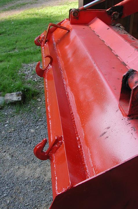

<font color="blue"> By the way, gotta pic of the 1/4" angle on the top of the bucket? </font>
Here is what I did to make the top of my bucket rival (I hope) the bottom with the toothbar attached.
I put a slip hook in the center and grab hooks on the sides. Works real well for me... /forums/images/graemlins/smile.gif

Strange...I don't think I have had a problem with posting attachments before...
Now a second try...
Well...no luck. Not sure why...maybe tomorrow... /forums/images/graemlins/confused.gif
/ Toothbar From H&H Mfg. #24
Hmmm.... That's odd. Are you sure your image is a JPG and within the limits? /forums/images/graemlins/confused.gif

/ Toothbar From H&H Mfg. #27
One more try on that photo...it is a jpeg and is about 68K in size...
Note: it was a software conflict at my end apparently. I closed some other stuff that was running and then the picture posted OK...

Bill, I'm kind of surprised that you're letting that much rust stay on your loader. You always seem so meticulous about how you build things that I would think you'd have removed that rust and repainted it. I know it's not a big deal, just surprises me. John

<font color="blue"> Bill, I'm kind of surprised that you're letting that much rust stay on your loader. You always seem so meticulous about how you build things that I would think you'd have removed that rust and repainted it.</font>
John, I don't think it is rust. I think it is grease...I'm guilty of putting a lot in and not wiping off the extra that comes out...I think this is true, but if not..."That's my story and I'm sticking to it!" /forums/images/graemlins/grin.gif
By the way, use is the best way to take the rust off from what I can see. My toothbar was rusty after the winter, but now it is the nicest shiny virgin steel color one could imagine... /forums/images/graemlins/smile.gif
