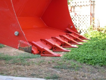

Just finished my first welding project with my new Miller175, toothbar for my BX22. Welded the shanks to 3/8in steel plate. The shanks have a lip which fits over/below the front edge of FEL. The teeth were a press fit on the shanks. Got the shanks and teeth from local Kubota dealer. Finished off with some Kubota orange. Works terrific.

How much did all your teeth cost, the ones on the bar /forums/images/graemlins/smile.gif

Total for shanks and teeth was about $60. I bargained them down a little...they had a LOT of dust. The steel plate was a scrap piece from local steelyard for $12. Angle iron at ends was garage scrap. Total came in at about $75. Fits just as good (or better IMO) as the $300 rigs. My neighbor got one at tractorsmart for his 2200, tried to return it when he saw mine.

Do dealer's usaully keep those teeth in stock? For that price I would build one too!
Do they have parts numbers?
   / Toothbar for BX22 #6
I see the two bolts, one on each side. Is that the only thing holding it into the bucket?
I guess I was wondering if it was removable or not.

Hambone...the toothbar is held by the two bolts on each end of the FEL, plus the "lip" on each shank. Makes for a pretty snug fit. I welded the shanks to the steel plate while it was attached to the FEL, to minimize bowing from the welding. And, yes, it is removable.
Dave, I got the shanks/teeth for mine from Dorning in Ontario Ca, near the airport. They had a large selection.
