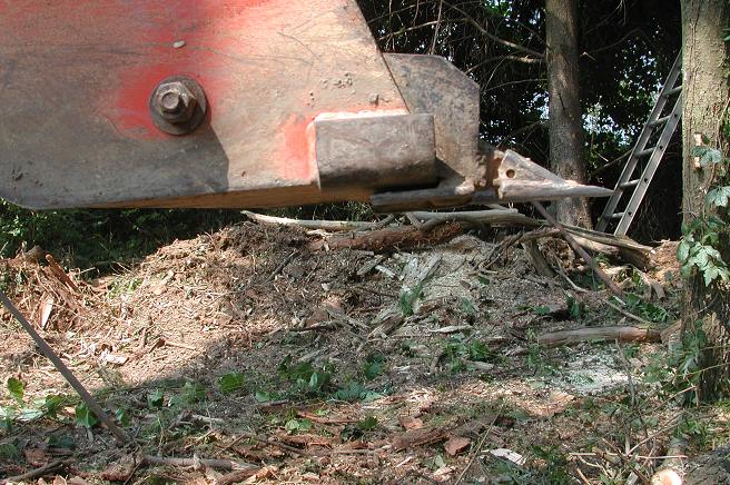

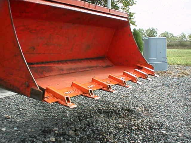

Just finished my first welding project with my new Miller175, toothbar for my BX22. Welded the shanks to 3/8in steel plate. The shanks have a lip which fits over/below the front edge of FEL. The teeth were a press fit on the shanks. Got the shanks and teeth from local Kubota dealer. Finished off with some Kubota orange. Works terrific.

Total for shanks and teeth was about $60. I bargained them down a little...they had a LOT of dust. The steel plate was a scrap piece from local steelyard for $12. Angle iron at ends was garage scrap. Total came in at about $75. Fits just as good (or better IMO) as the $300 rigs. My neighbor got one at tractorsmart for his 2200, tried to return it when he saw mine.

Hambone...the toothbar is held by the two bolts on each end of the FEL, plus the "lip" on each shank. Makes for a pretty snug fit. I welded the shanks to the steel plate while it was attached to the FEL, to minimize bowing from the welding. And, yes, it is removable.

Rich , don't want to tell you some bad news but, Your teeth should be level with the bottom edge, so they can cut and lift into the bucket. There on too much of an up angle /

<font color="blue"> Your teeth should be level with the bottom edge, so they can cut and lift into the bucket. </font>
Here is a side shot of my toothbar...the teeth are essentially like DieselD says...only a very slight downward angle. for all practical purposes level with the bottom of the bucket.
I think the reason for this is that if you have a level indicator on your bucket you know when the bucket is level the teeth are level too.
I imagine teeth angled up would be much better than teeth angled too far down, since you can lift the rear of the bucket to make angled-up teeth dig in. Whereas angled down teeth would be very aggressive and could not be leveled becaue the rear of the bucket would hit the ground...

Danny...I agree with you, level would be ideal. As Bill notes, with the teeth angled up it just takes a little practice to account for the angle between the bucket and tooth. I think its a fairly easy mod to level the toothbar, some steel stock at the rear of the plate and elongated bolt attachment holes should do it.

I have been wondering about a tooth bar and decided to build one to see if they are worth while.
I used 1/4" X 1.5" for the bar, 1.5" angle for attaching and a 1/8" X 1.5" leading edge, 1/4" X 1.5" X 3" for the teeth and some 1" square heavy wall tubing for the shanks.
All the metal was left over from another project, so I will have to guess the cost, A 20 foot piece of steel strap is only a small amount higher than a 10 foot piece which is why I have left overs. I am sure the cost would be under $20.
The result works fine, Very worth while tool, not as nice looking as some but convinced me of the value of a tooth bar.

That looks great! do you have any pics of what the bottom of the bucket (with tooth bar) looks like?
