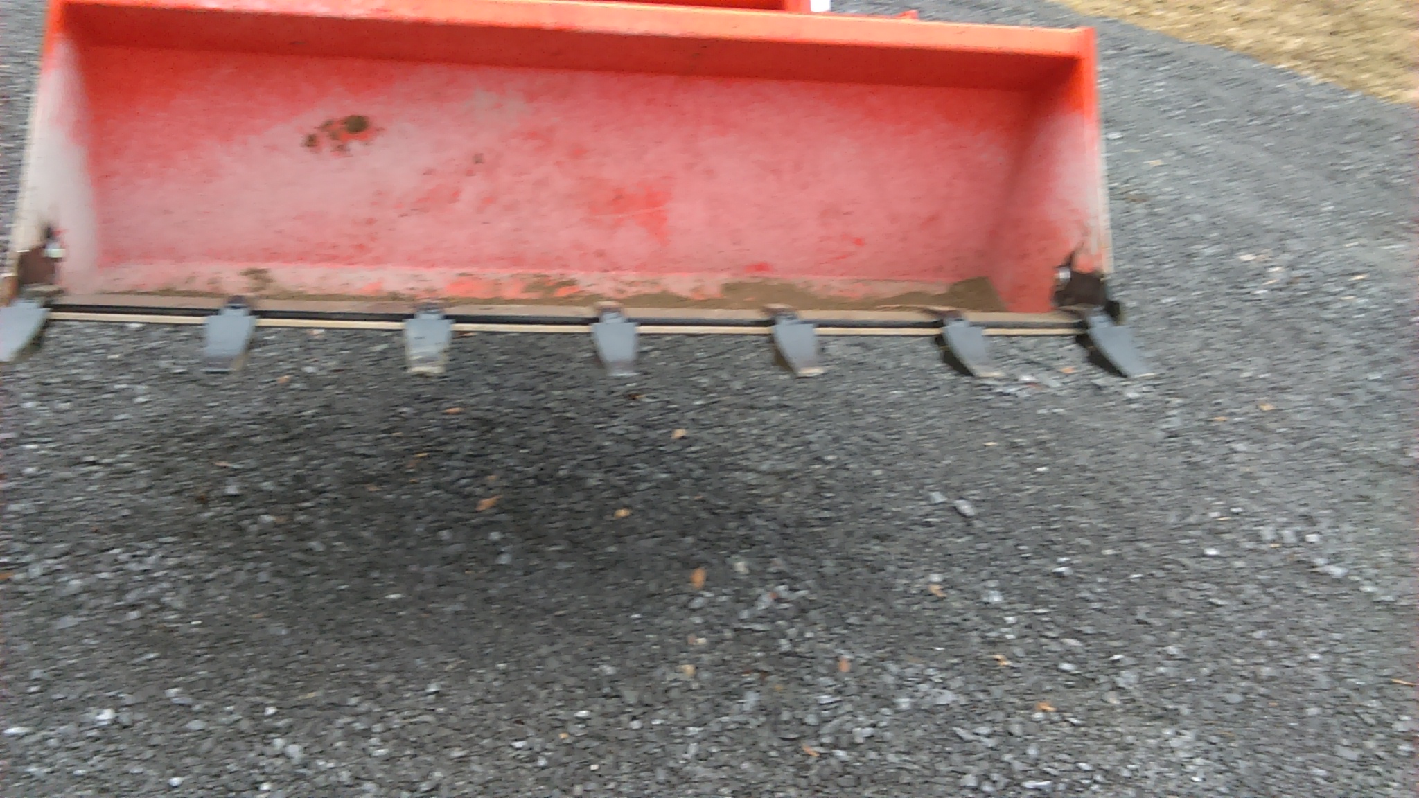

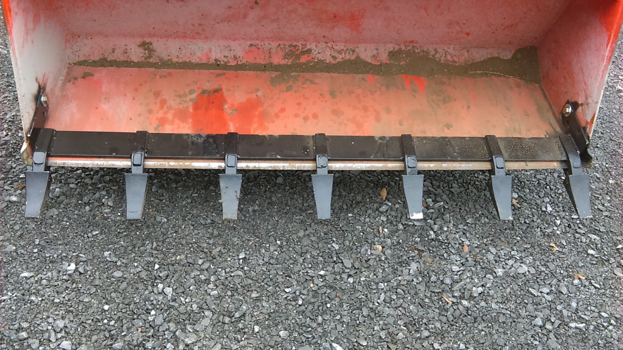

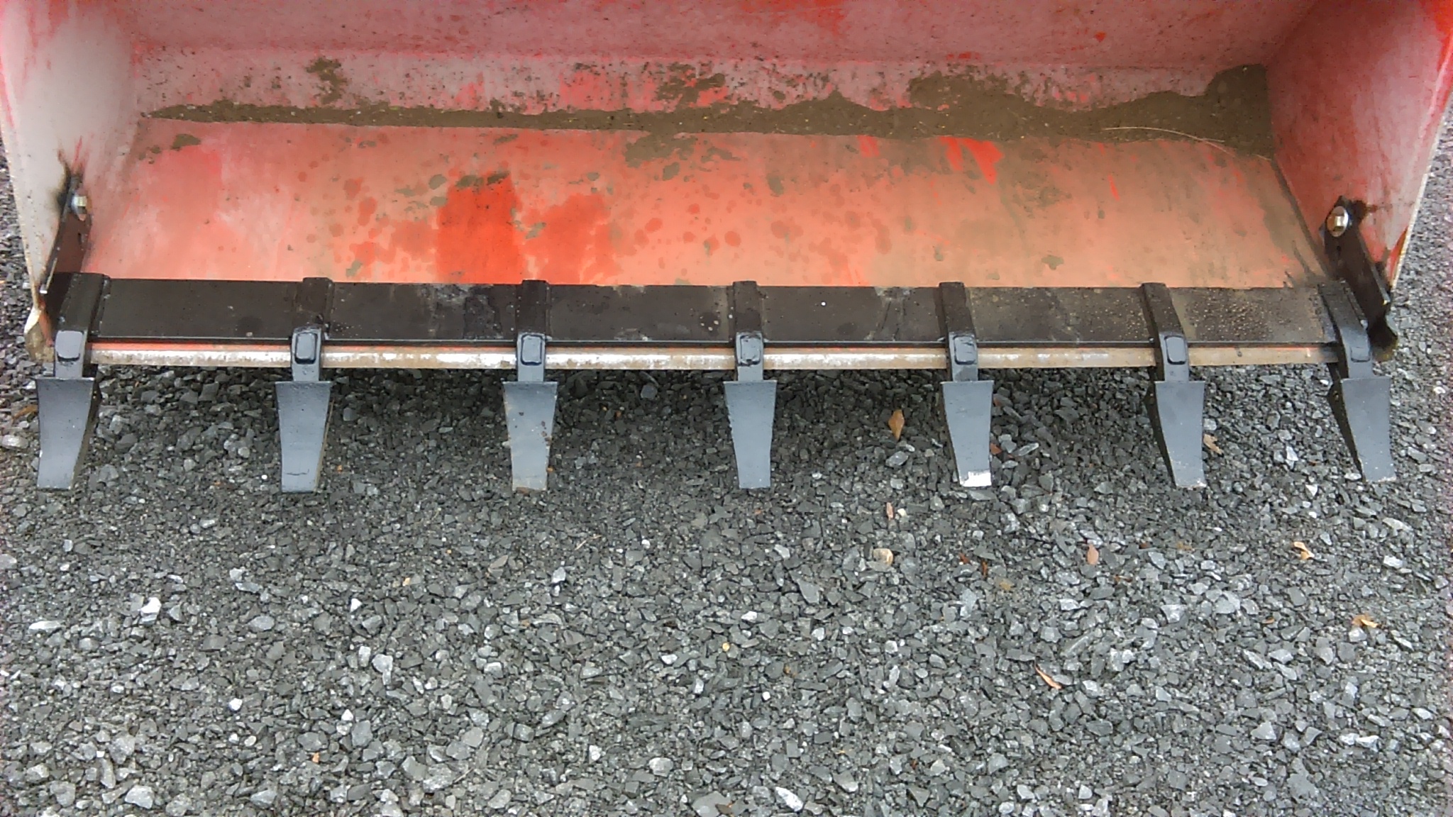

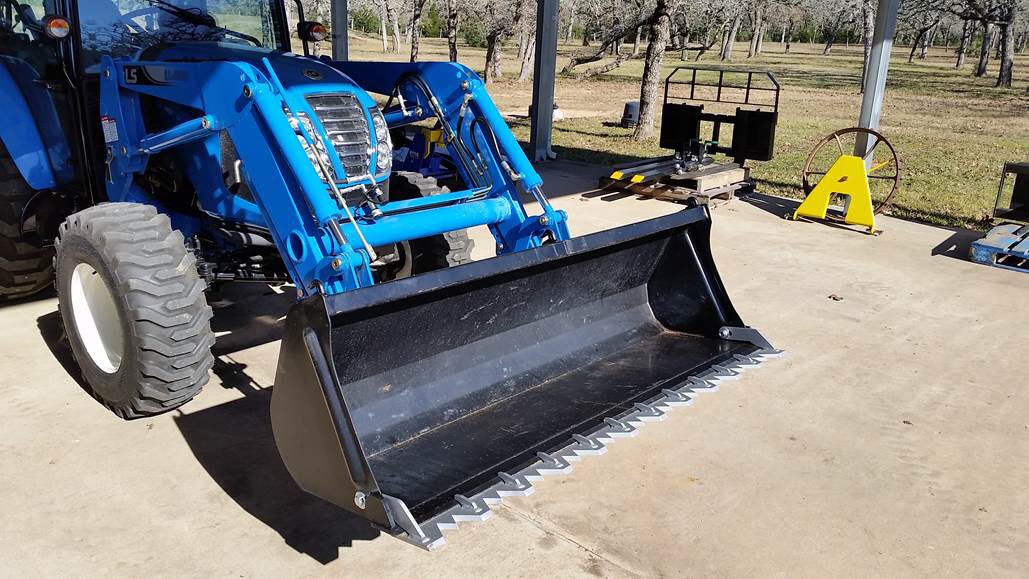

here's the titan tooth bar. I don't know how it compares to the WR Long, but it seems more HD than the one on my Yanmar. I have no idea where the dealer got the one for the yanmar, But the teeth on this Titan tooth bar are much bigger, and the entire tooth bar is much heavier

I got my Titan toothbar in late Dec.,haven't even taken it out of the packaging. A 5 footer for my TC33. It's been too darn cold to mess with it. It looks like you only have one bolt on each side, is that all that is needed because of the way it hooks on to the cutting edge?
I think one bolt per side is all that is needed.
I have a different brand tooth bar on my other tractor only has one bolt per side and does fine.

My Piranha Tooth Bar has a single bolt on each end, holds fine. I do a lot of back dragging with it and it’s still solid.
