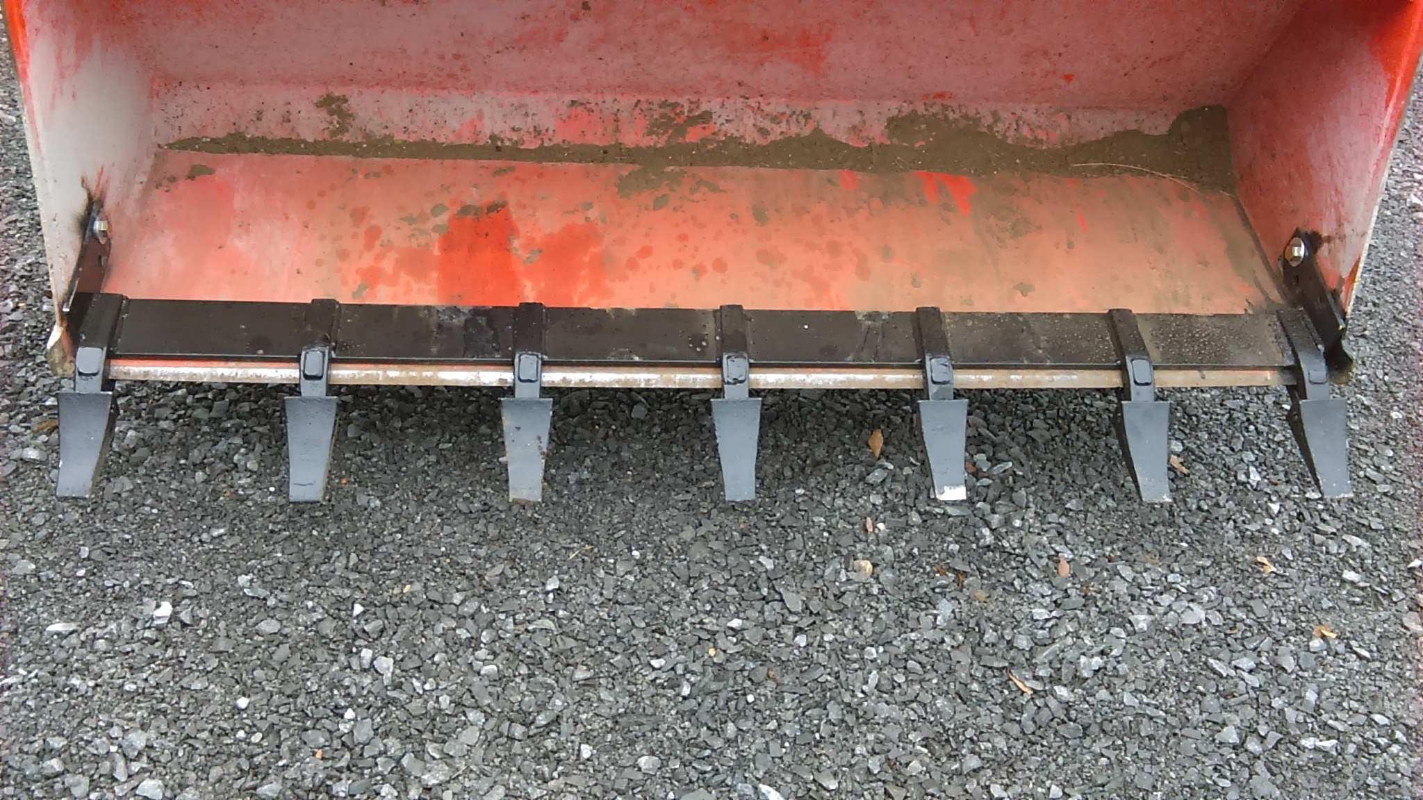

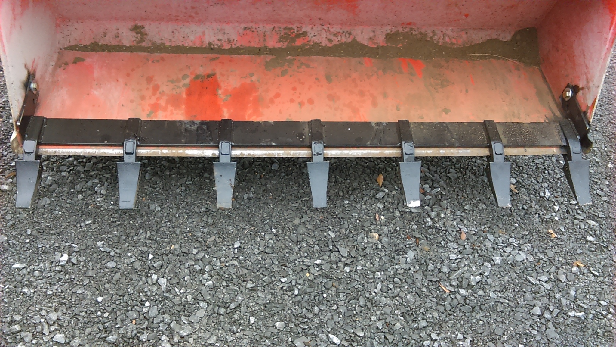

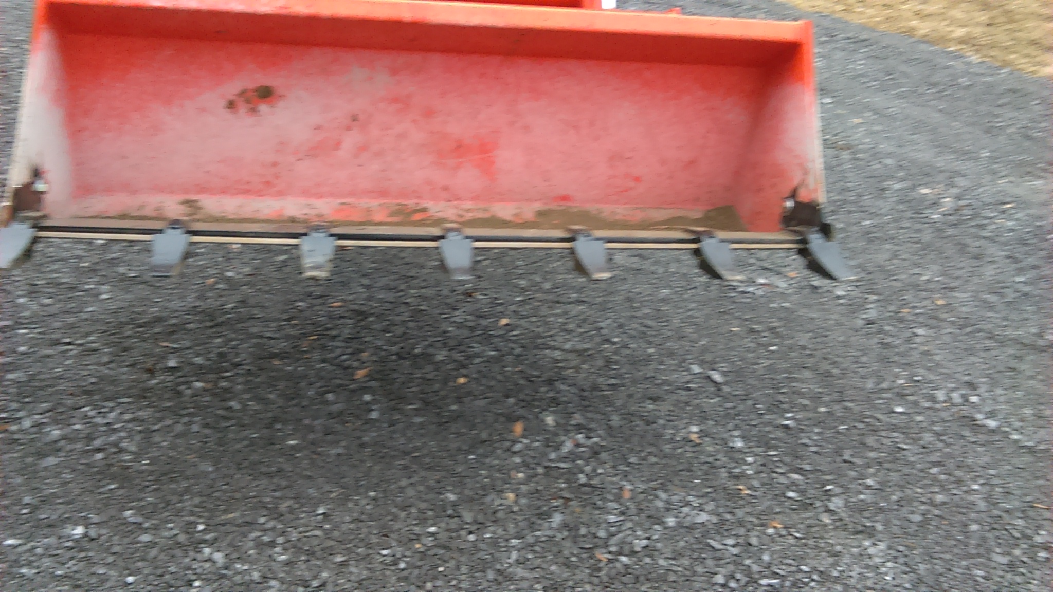

A couple of weeks ago, I ordered a tooth bar from Titan Attachments.
I have been out of town for the holidays.
Got back in today and installed the tooth bar.
The tooth bar is a little longer than the inside of my Kubota 72 inch bucket. But, that's the only one they offer. So, I had to cut some off the end and re-weld a tooth and mounting plate back on.
Not a hard job since I saved some $$ over other brands.
This thing is much heavier duty than the more expensive 5 ft tooth bar on my yanmar.

Got Photos?? When I was looking at them a long time ago, the photos didn't look HD, more light duty.
   / Tooth Bar
I didn't get any. I got back in town and after unpacking, I got a late start.
I will take some and post them for ya

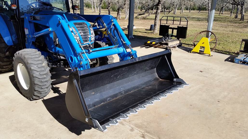

I got my Piranha Tooth Bar about 2 1/2 Years ago and it has never been off of my bucket since I installed it.

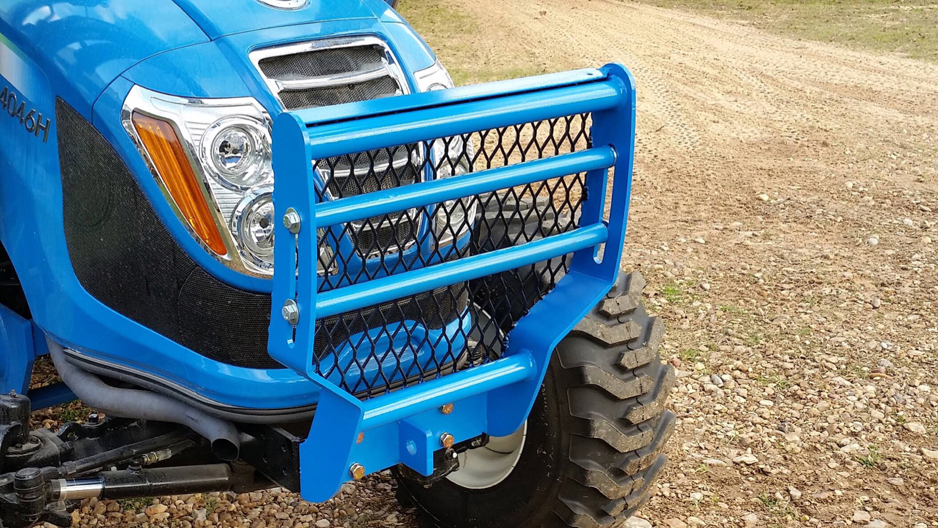

I just upgraded from prior LS XR4046HC to an XR4155HC. I just swapped out buckets as old bucket had the PTB and 3 hooks in place. No sense in starting all over for some fresh paint.
I also kept my already modified grill guard.

I got a Titan toothbar for my 5' bucket. I had to add a few inches of shim plate to fit my bucket. Nice heavy duty looking teeth. It did well pushing off-season kudzu off a trail. Also moved a dead deer out of the way of another project. I had to take it off to move the manure pile to the composting pile. It took 5 minutes to remove.
