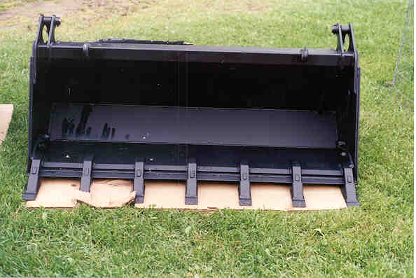

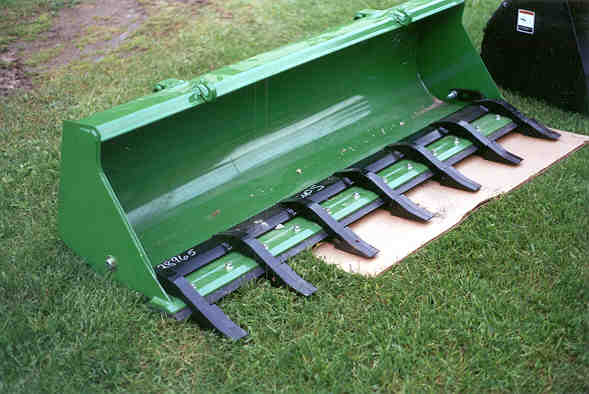

I recently purchased a CK 20 with a KL120 FEL with a 54" bucket with separate tooth bar and the toothbar looks to me to be for a heavier duty bucket. The bar itself is 2" shorter then the bucket and fits real bad on the cutting edge of the bucket. My dealer says to add some washers to each side and it will work fine cause the tork is on the edge of the bucket any way. I don't buy it. I have some pictures of the bar on the bucket but I don't know how to downsize them to post them but can email them if you ned to see them, Thanks Jim

See the attached pic of what a toothbar on a HD bucket should look like. Your dealer is telling you a tall tale. There shouldn't be a gap of 2 inches. Maybe, a quarter or half inch but not 2 inches. The toothbar should also fit snugly on the cutting edge without any significant wiggle room. If I were you, I'd take that toothbar back to your dealer and make sure he orders the correctly sized one from whatever vendor he buys them from.
...Bob

   / Tooth bar #3
...and here's a better front pictoral view of a properly sized toothbar on my 4 in 1 bucket.
...Bob

   / Tooth bar #4
I was going to post my pics, but those already here give you the idea. A 2" gap sounds like the wrong toothbar. I like having my teeth right on the outside of the bucket. The bucket's cutting edge should fit pretty well into the notches on the back of the teeth (not gapless, but at least 2/3 of the slot's depth.)

   / Tooth bar
Thanks for the pictures that helps alot . Thats the a toothbar is supposed to look like. The gap I have is unexceptable.( 1" on each side and a terrrible fit on the flange) I think the ordered the wrong bar and paid a $112.00 for shipping and dosen't want to eat that again. What gets me is that he knew how bad the fit was and still is trying to get me to take it. I will give him a chance to make the problem right before I slam the dealership too bad. He has been good up to this piont and deserves the benifit of the doubt.If I could figure out how to get a picture on here I would show you fit I'm talking about. Jim
