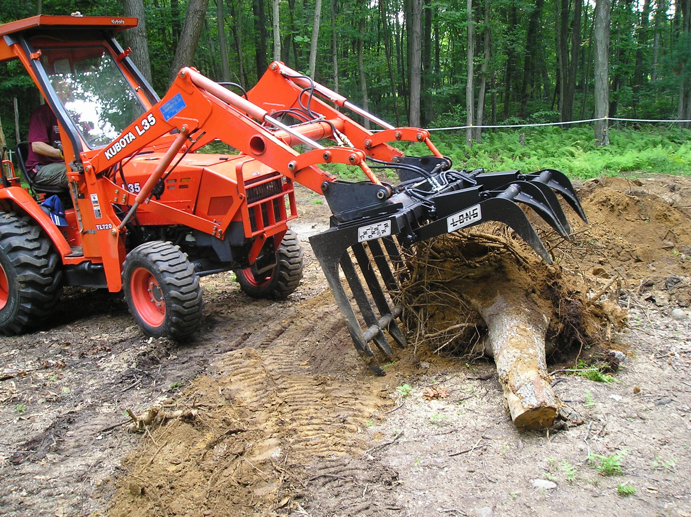

I'm guessing your 3 ton tractor will be more useful for this type of work with a toothbar.. but for brush cleanup I recommend a grapple.

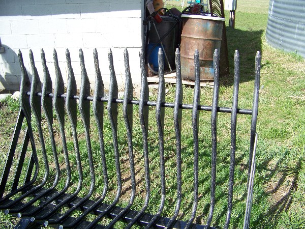

Clear fields....How big are the trees? Is the logg'n outfit going to pull stumps too? Many times such an outfit can pile brush and pull stumps also, saving the wear and tear from your unguarded tractor from sticks in radiators and such plus ruined tires.... You may have more than just the residual brush left to deal with to make into a clear field. Unless you gunna have a stump ranch:laughing: Or mabe you are just going to seed it for a food plot, in wich just exposing some soil between stumps may be an option:confused:
A tooth bar is a "good" tool to pile limbs/brush with. Careful angling of the bucket should yield a decent raking action. The "teeth" of the tooth bar are kinda short for serious brush gathering/raking. Check the search option on the anbo brush grapple or markham I believe has a popular brush bucket/ grapple.
I used my rock bucket 'pic below' last spring, AFTER a dozer with a brush rake pushed a hedge of 80 year old vine maple and juneberry off for me. It worked rather good but was constantly having to watch for jill pokes "sticks" heading for hydraulic hoses and lines, radiator, engine compartment and tire sidewalls. Tractors are poooorly guarded against such threats.
