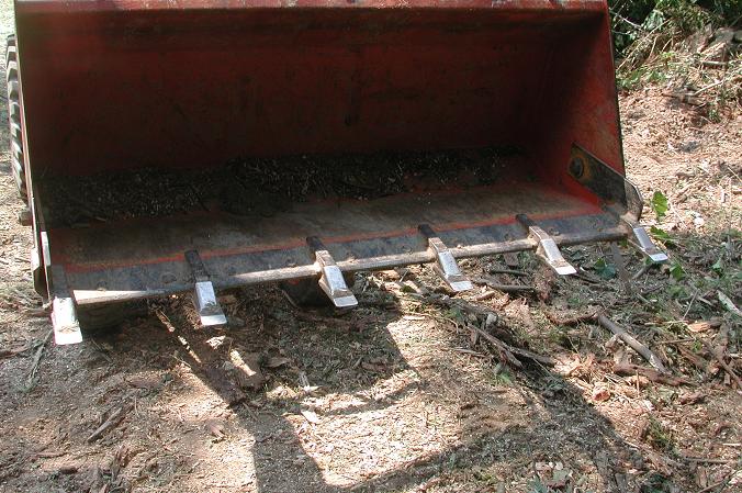

I'm a big fan of these toothbars...
Click here...to go to the web site...
The unique thing about this company is that their tooth bars are V shaped and totally cover the cutting edge. That makes for a very strong lower lip when the toothbar is installed.
Mine goes on or off in a couple minutes.
I love it and would not want a different type, even though the others seem to work just dandy.
With this toothbar I never fear bending my lower lip...
For digging, any toothbar is better than no toothbar though... /forums/images/graemlins/smile.gif Just dumb luck on my part that I ended up with this particular brand, as that is what my dealer was selling at the time...
I've attached a pic of what mine looks like after a couple years of hard use ( well not THAT hard, but pretty good use...).
PS...54" bucket on Kubota B2910.
