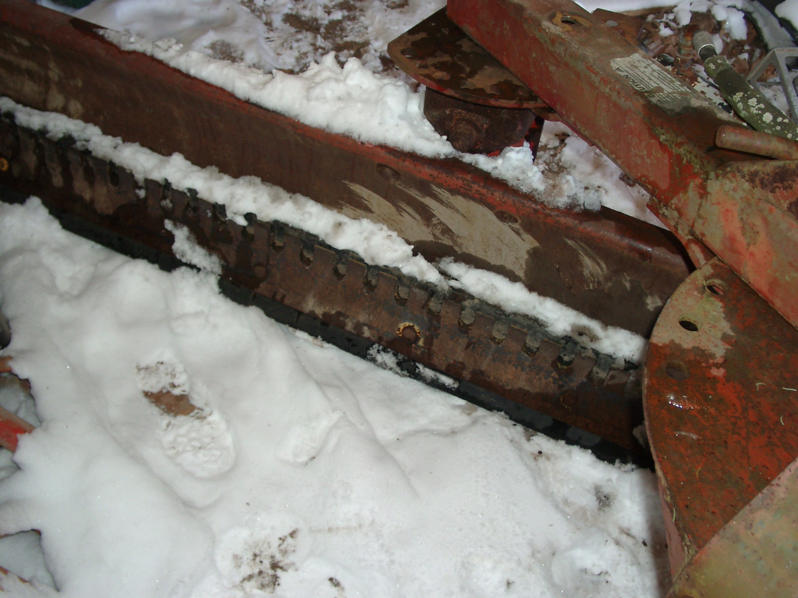

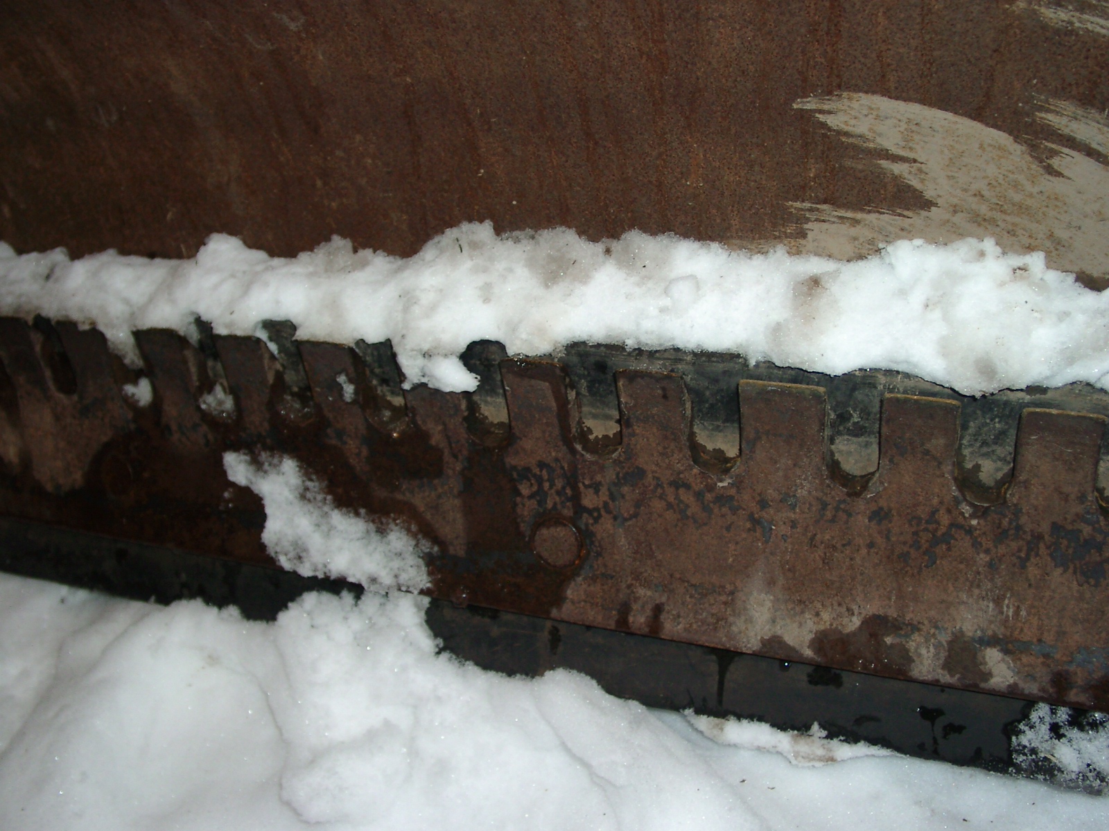

Gordon,
I purchased the edge from a highway equipment supply company that I used to work for. Try to find a Bucyrus dealer & they should be able get one for you.
The serations make it very aggresive at biting in, especially if you have Top-n-tilt. Sometimes it can be adjusted to aggresive & it will bring you to a stop quickly from digging in to hard. I have ripped up a half mile of road in the mountains in a couple hours that I was not able to with a standard edge. the pictures show it mounted upside down because I use a rubber edge for the snow.

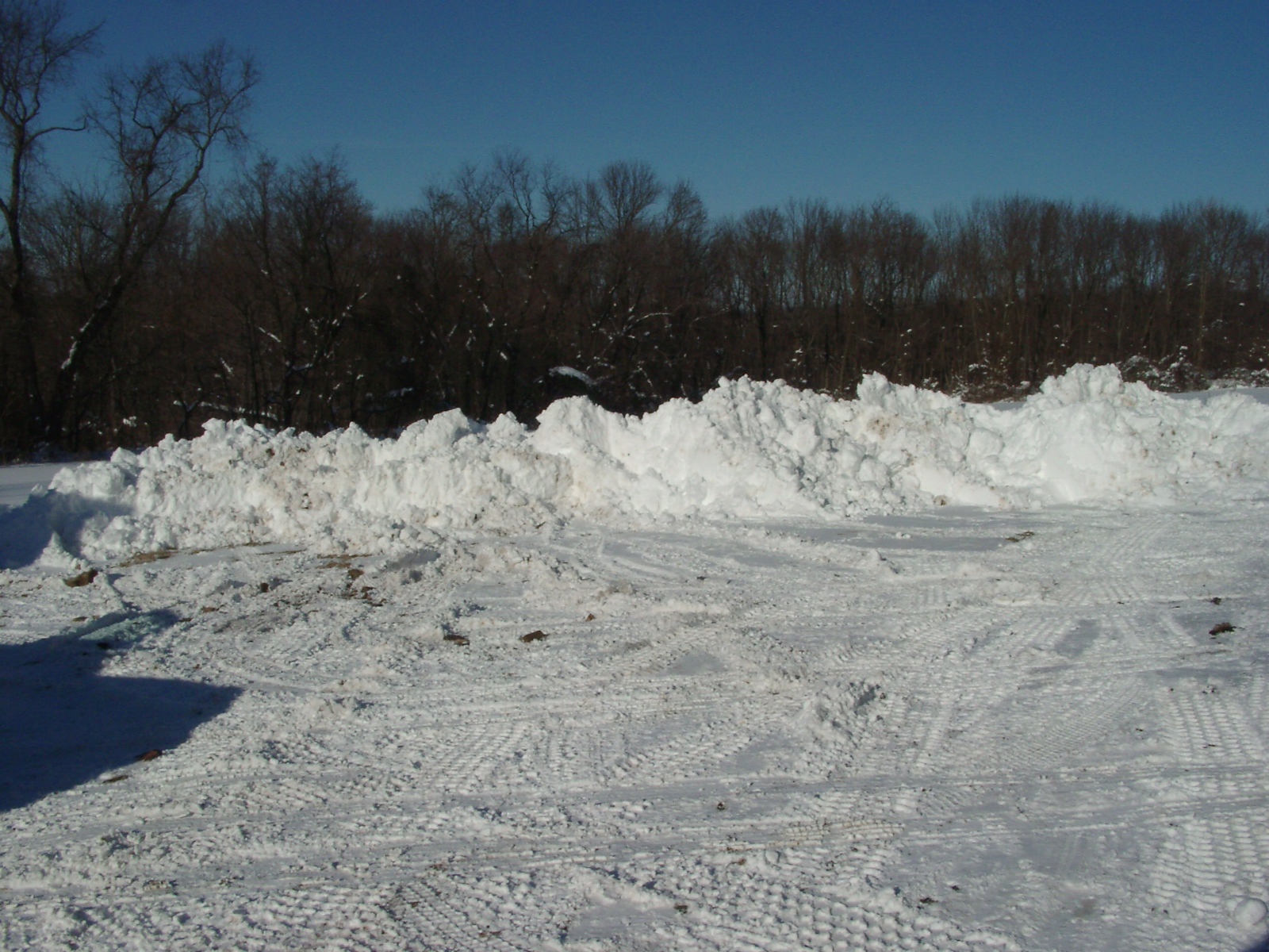

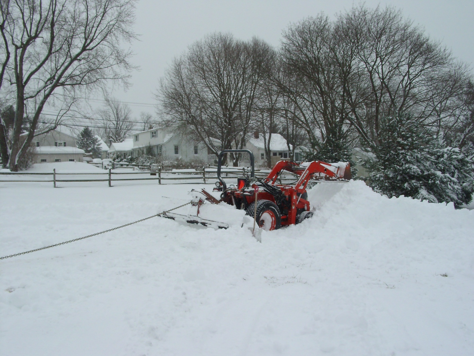

That "white stuff", you want it you can have it. I used to like the snow, but now it's just work.
Didn't lift the grader blade before pushing into the pile & some small piles along the drive.
