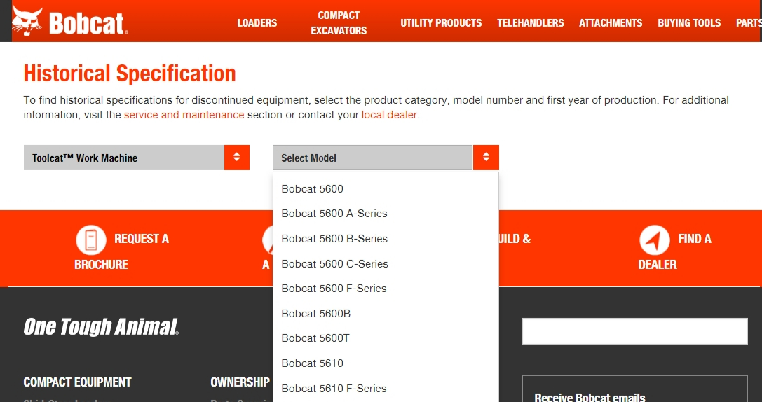

May 30, 2018 / toolcat letters/ years #2 Xfaxman Super Star Member Joined Feb 8, 2013 Messages 13,322 Location Guthrie, OK Tractor Toolcat 5610 G - Bobcat V417 - TORO+Loader Found some info here in the Toolcat Forum and saved it: Bobcat has a historical Page: Bobcat Historical Specs - Bobcat Company My experience is a 2013 5610 Series F and a 2017 5610 Series G: http://www.tractorbynet.com/forums/toolcat/270965-toolcat-5610-f-5610-g.html?highlight= Last edited: May 31, 2018
