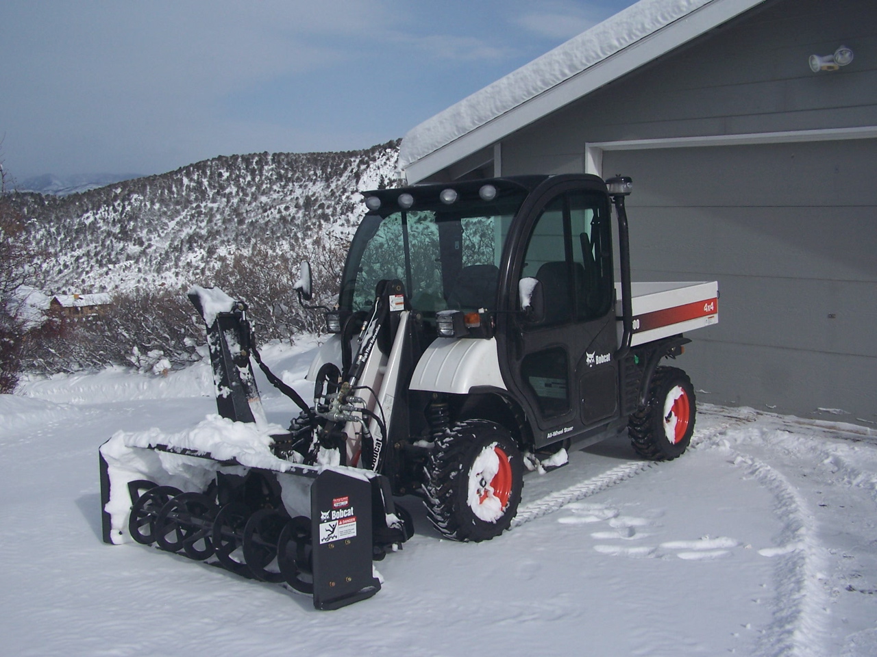

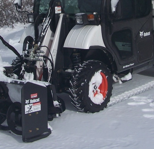

I ordered the Toolcat from the dealer with the taller tires. Stock tires were 27" and the larger are 29". They're the AG tires on the same rims. At the time I bought mine it cost an extra $250.
I have an 84" Bobcat Snowblade and I have no issues with it at all even with heavy wet snow on steep slopes. It makes quick work of a lot of snow. Where I live, I run out of room to push the snow and have to resort to the snowblower to blow the snow over the built-up windrows or blow the piles back out of the way to make more room.
Here's a pic with the 72" SB200 on the Toolcat (click on it for a bigger pic). I don't have any pics of the Snowblade on the Toolcat.

Thanks. So the rims are the same, but the tires are taller? So obviously, just a taller sidewall? Your rims actually look taller than the rims on the TC I'm demoing right now.
Reason I ask is because if I buy a used TC with bad tires, I assume I could simply replace tires with taller tires?
That could be a big plus for me.

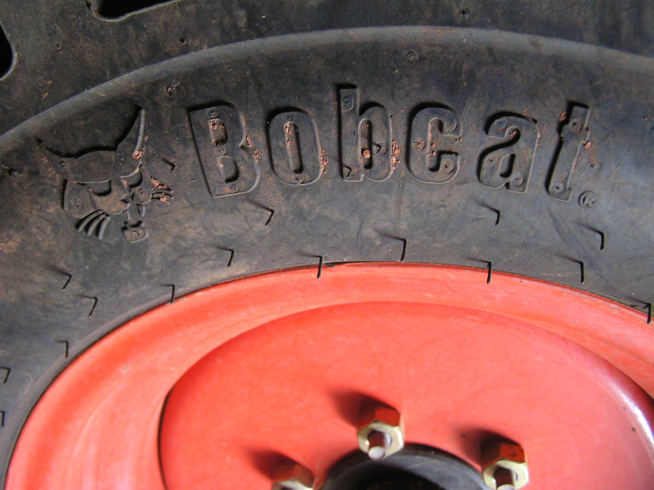

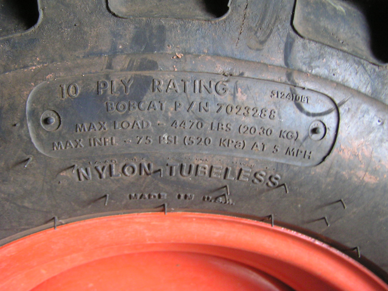

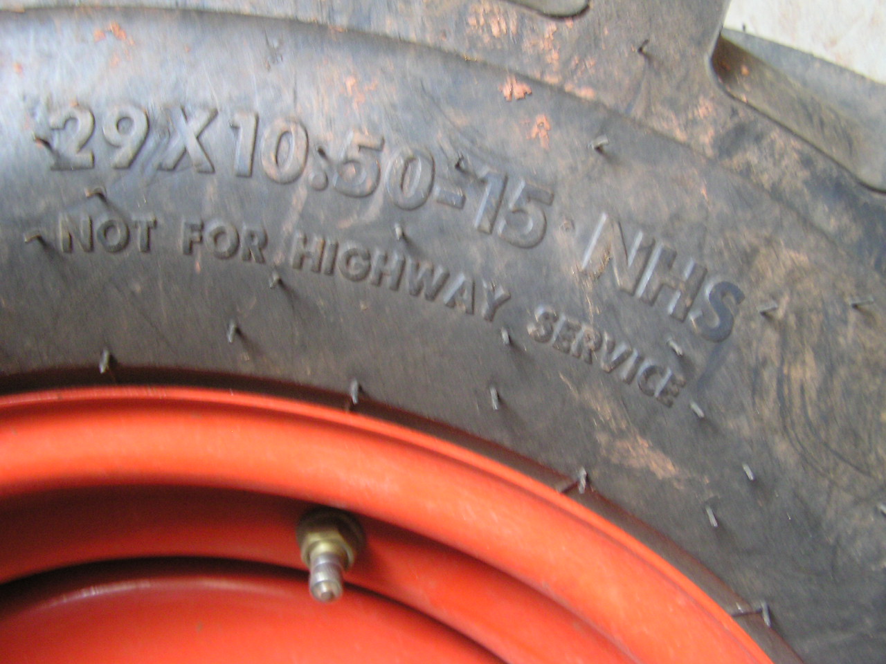

They are not AG, R1 tires. They are R4 tread Industrial tires. This is copied from the Order sheet
Factory Installed 29 x 10.5, 8 PR Trac TiresM1003-R05CO4 1 $250.00
The same tire is on my wife's 5610.
I was disappointed they were not tractor tires. :thumbdown:
/ Toolcat demo #11
Your right Xfaxman, thanks for the correction. Their R1 and not AG tires and mine are the same 29" x 10.5 x 15" (rim) as yours except mine appear to be 8 ply and not 10. I too was wanting the AG tires but wound up with the R1's.

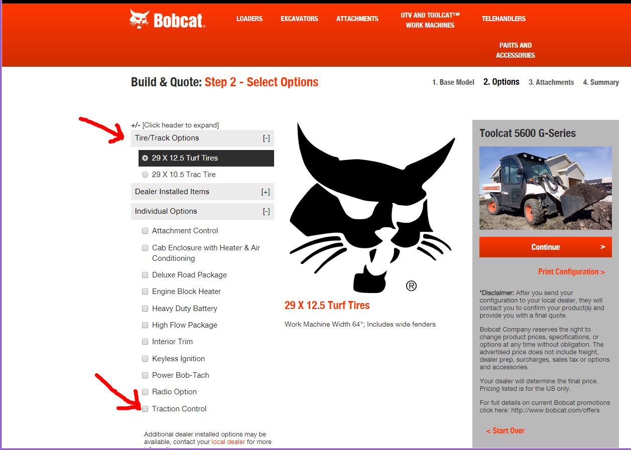

is the traction better with the 29's vs the factory 27's ? im looking at both ag tires
I think the traction would be the same, since it is the same R4 tread Industrial tire. I don't see the 27's listed on the build sheet now.
There are no Ag tires, unless it is a new option.
They are listed as "Trac Tires", but that is not Tractor Tires, must be "Traction Tires". The other tire is Turf Tread and wider.
See this post from above: Toolcat demo
Be sure to order the traction control:
