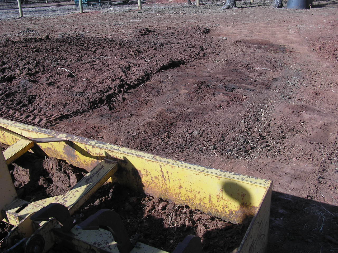

Put the 6' box blade on the V417 to move the top of the terrace into the low spot:

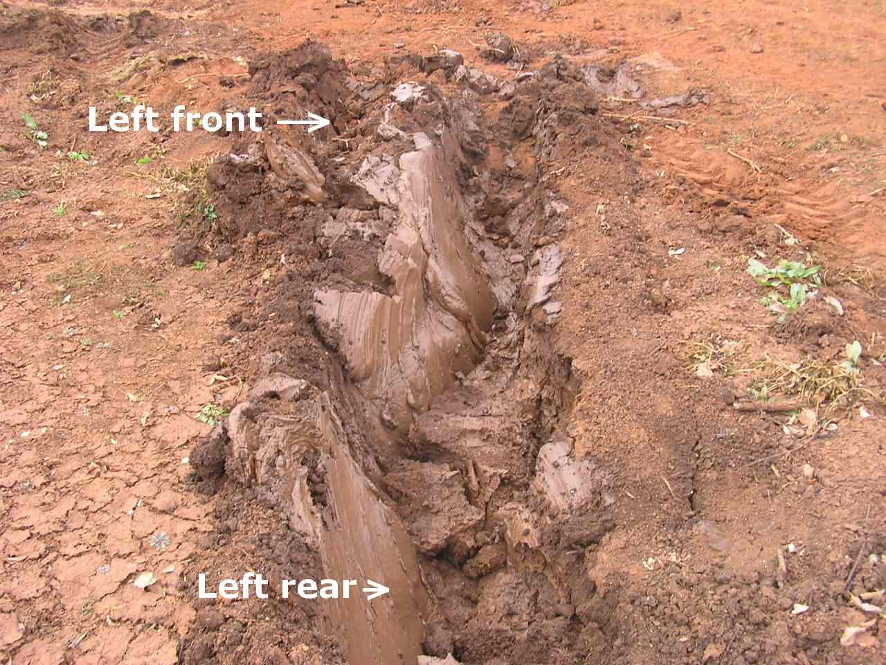

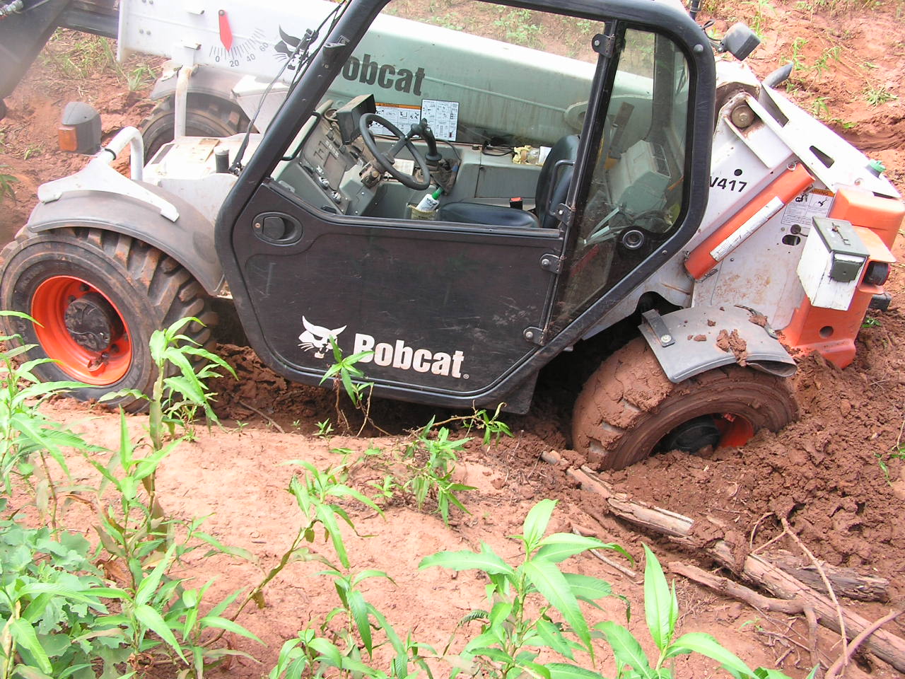

Because of the extending boom. This shows mowing across a silt filled creek.
This is what happens if you drive on silt:

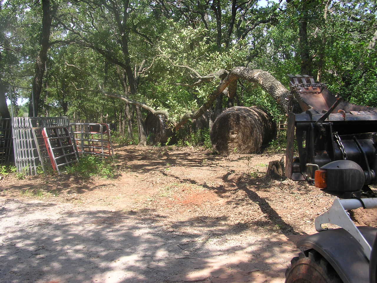

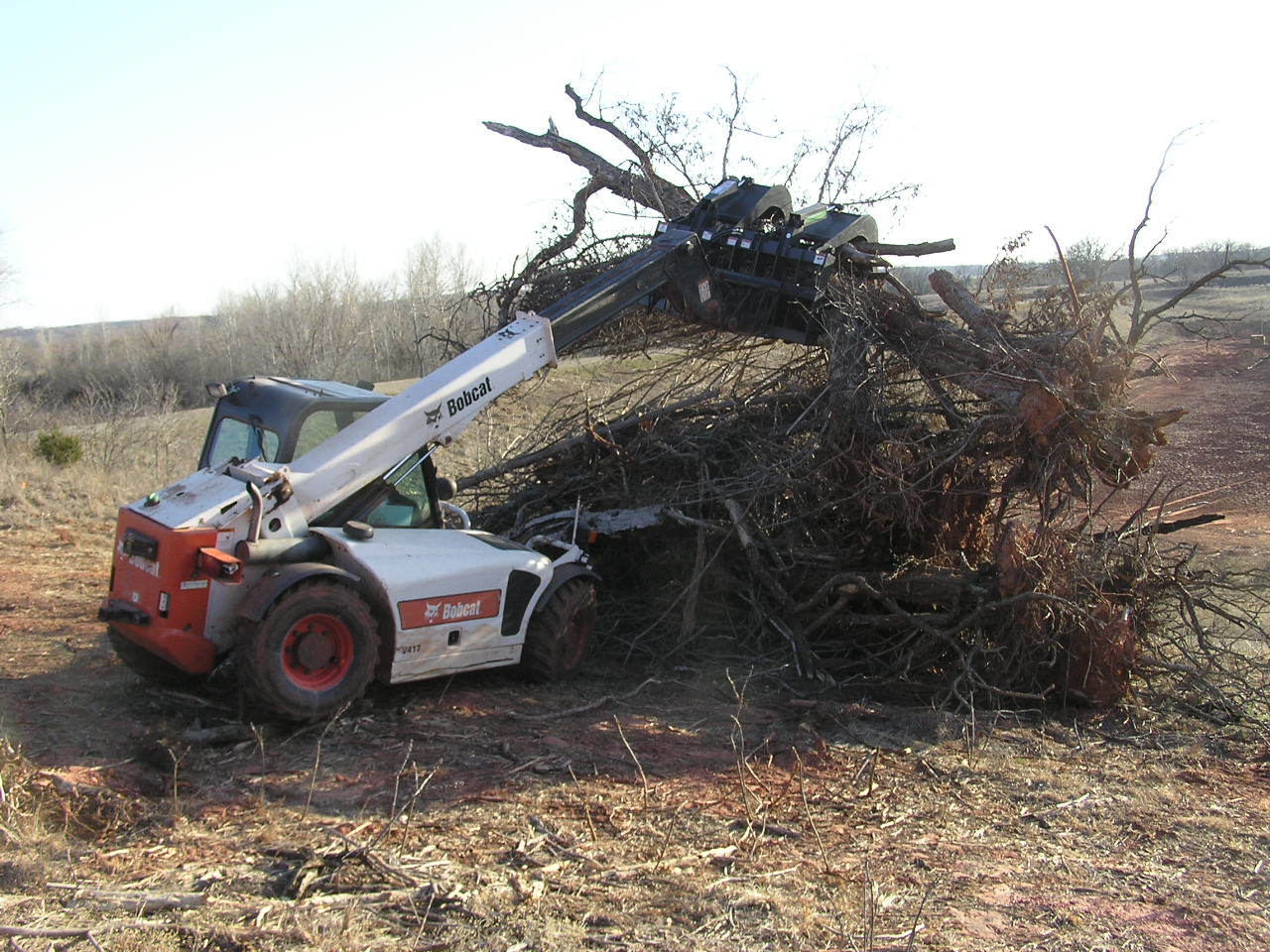

Put the Monster Grapple on the Toolcat to pickup some previously pulled cedar trees.
At the first one:
The view from the seat:
Grapple down and closed:
Grapple and tree up:
View from the seat approaching the next one:
Grapple down and open:
Drove forward and curled down the grapple:
Grappled:
Took them to the brush pile:
Opened the grapple and curled it down:

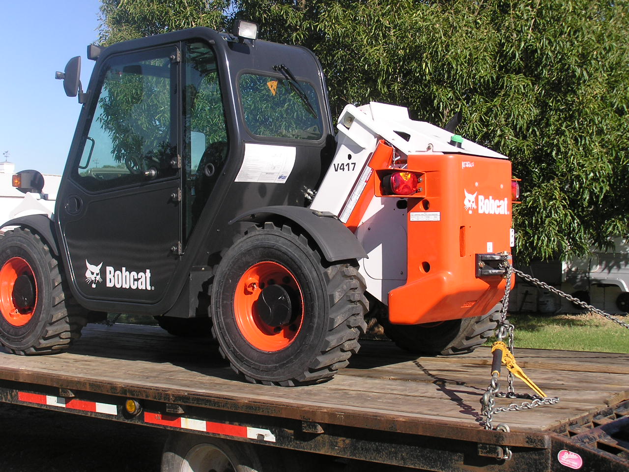

Just pickup up my new V417 yesterday. 5 hour drive to get it. Dealer claimed it was the last new tier 3 in USA. It was difficult to find a V417.
Have not seen anything from you in a while, need an update on your V417 please.

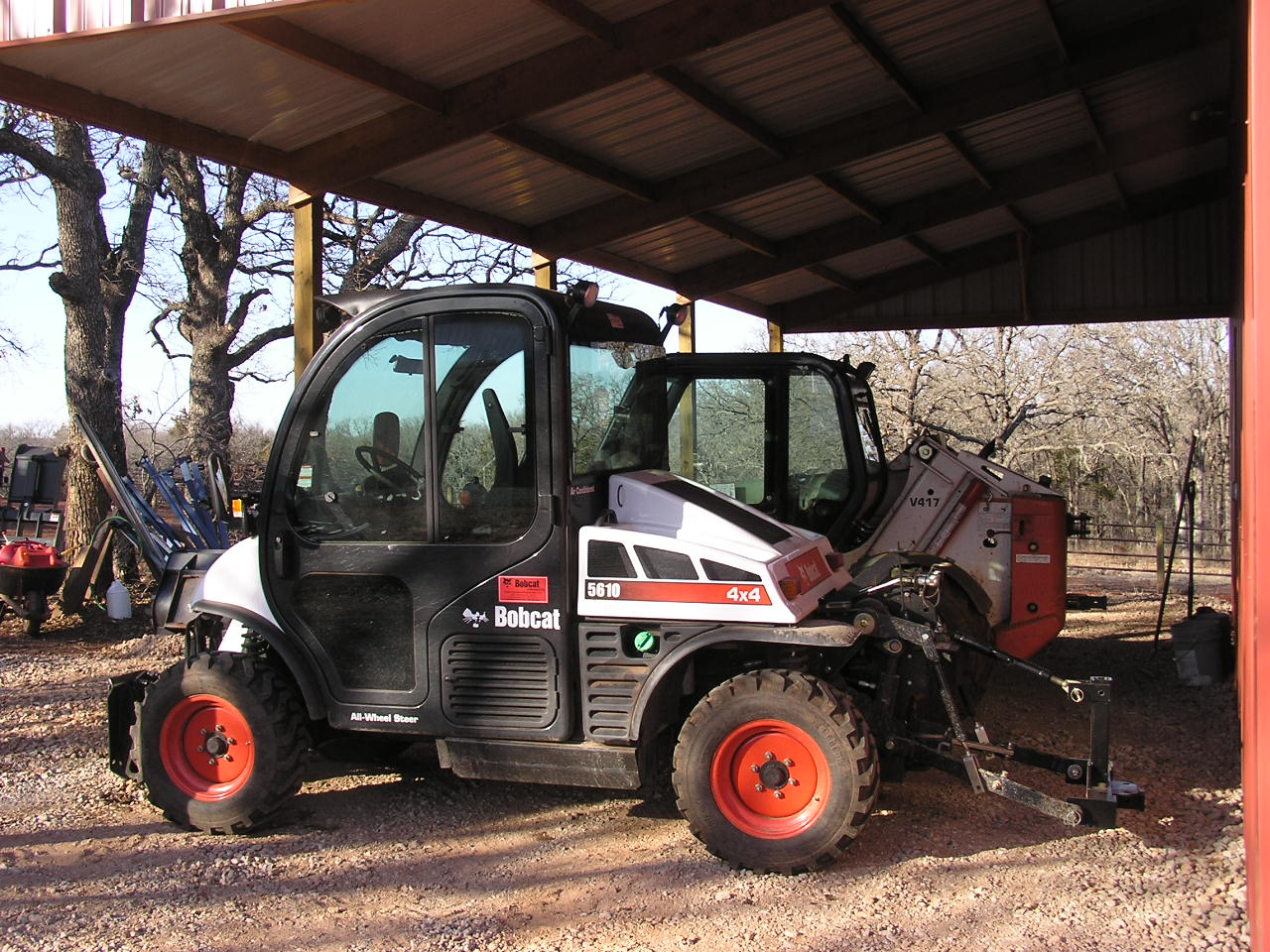

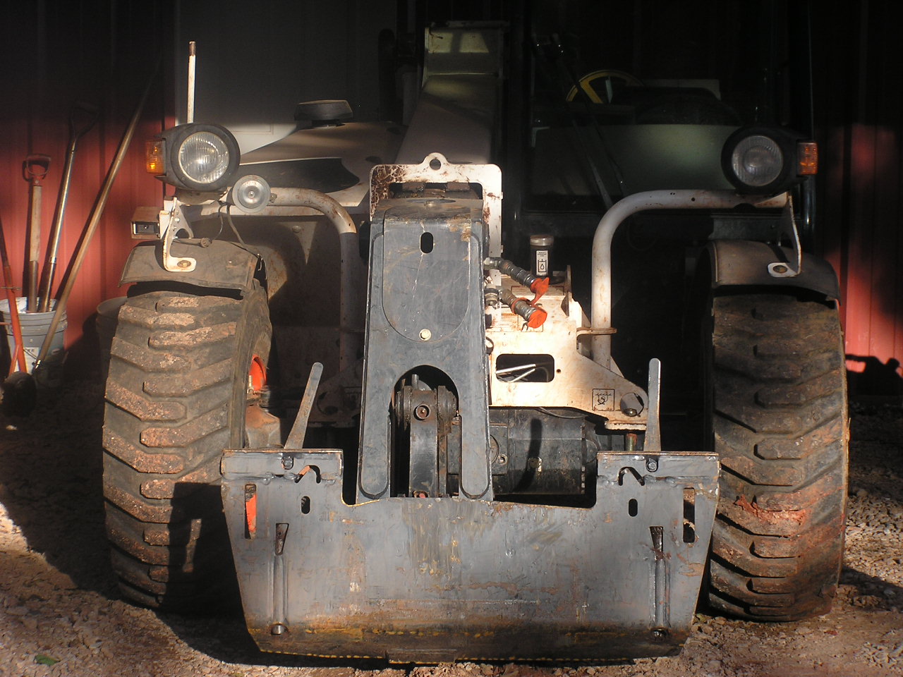

The SSQA to 3 point adapter on the Toolcat:
On the V417:
Made a new dolly for it from an old shelf:
Drilled through the 3/4 inch plywood, used 1/4 inch bolts:
Here it is with the Omni Transformer 3 point hitch attached:
Picked them up with the crank up lift: See it here: Crank Up Counterbalanced Workbench / Lift
Set them down on the dolly:
Now I can roll it to the storage area:
