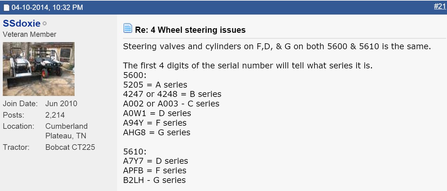

#81
2014 :thumbsup:
   / Toolcat 5610 F and 5610 G Series Pictures #82
OK, thanks. So I can begin looking for a used G model.

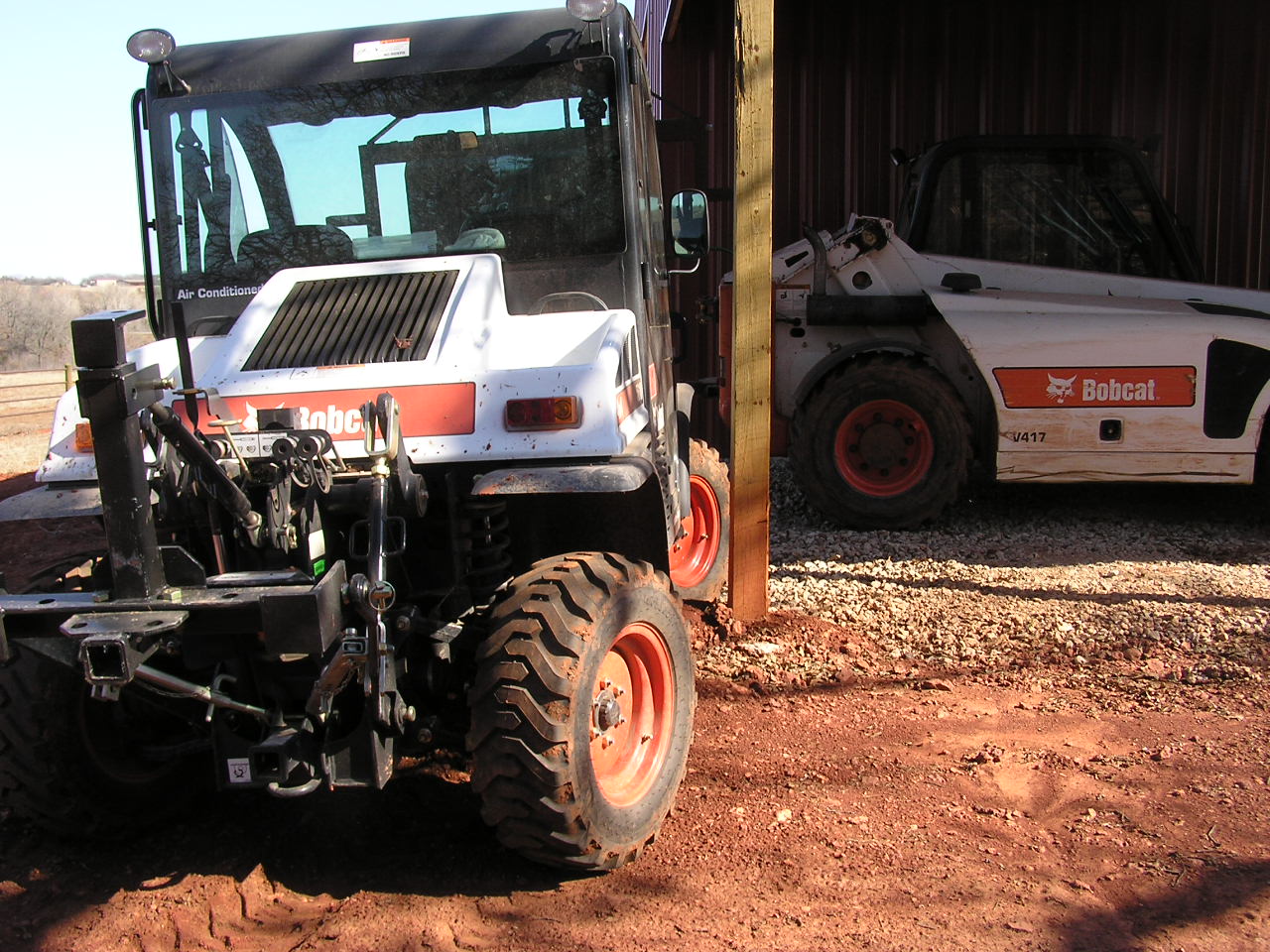

Yep, make sure that it has the traction control switch on the dash. :thumbsup:

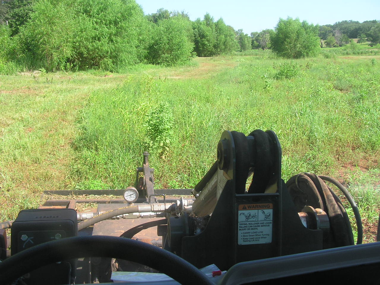

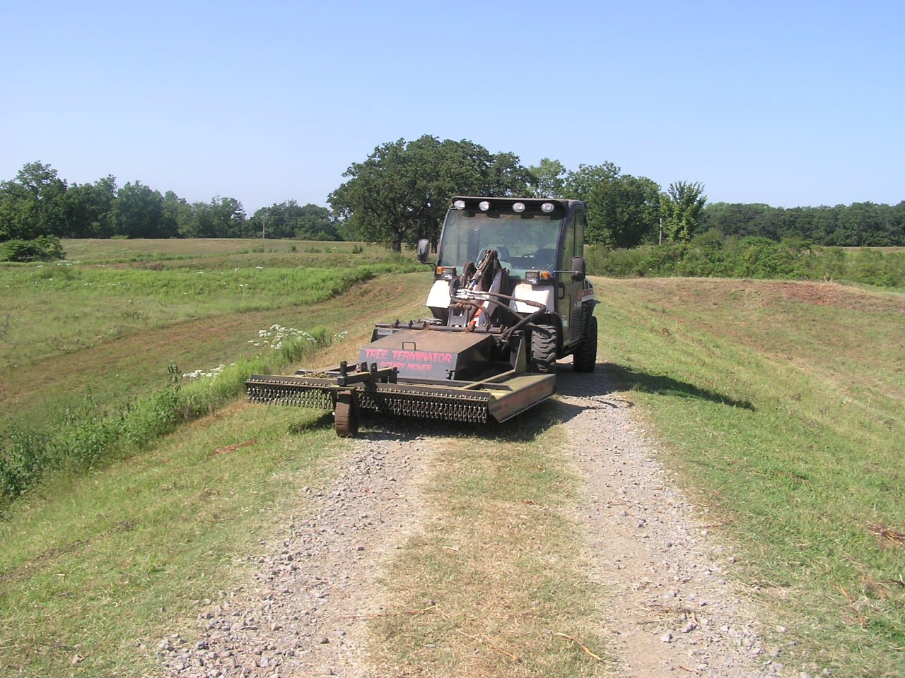

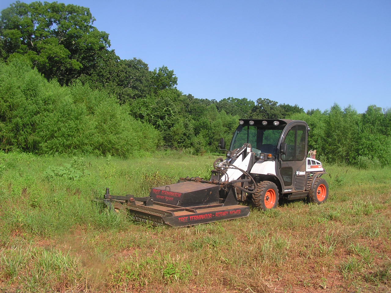

Using the 7' brush hog at the edge of the pond:
The view from behind the steering wheel:

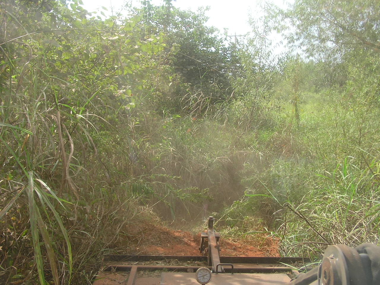

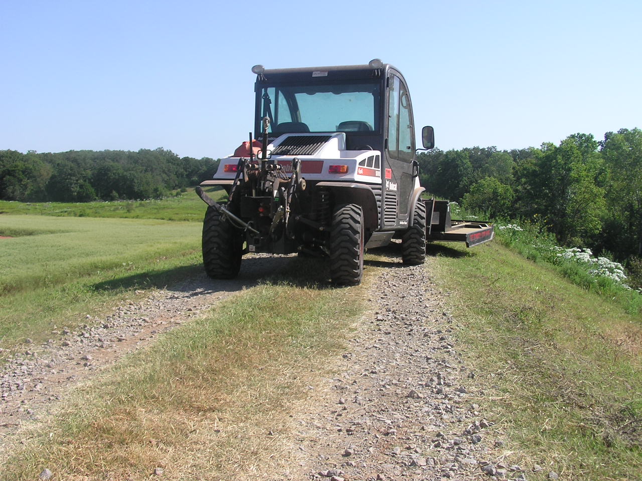

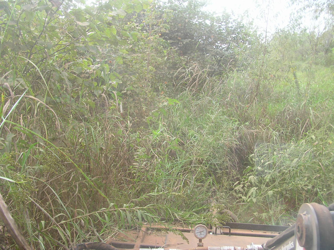

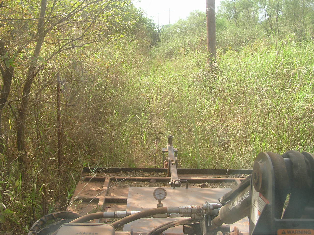

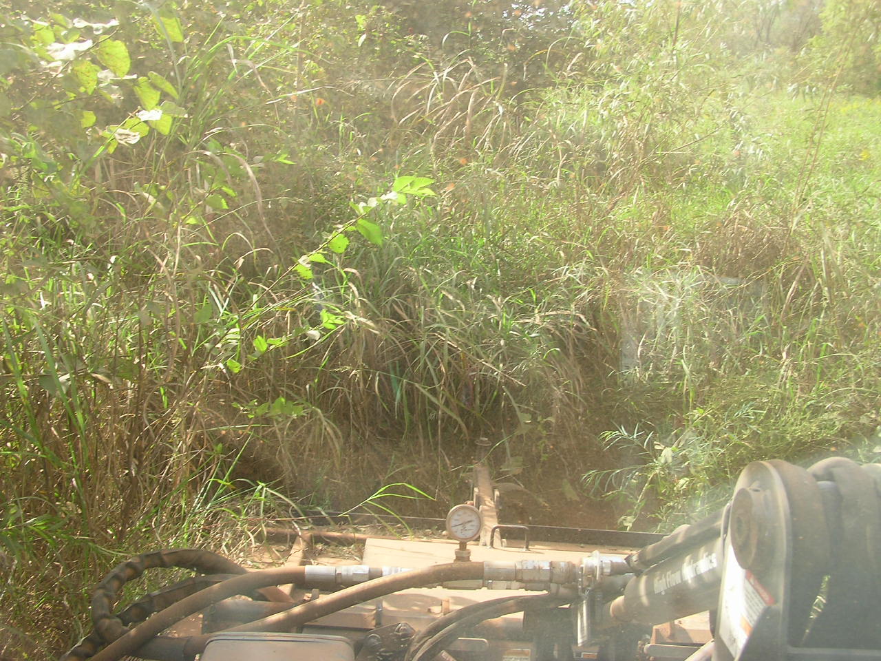

Brush hogging the fence line at the road, next to the power line:
There is a deep ditch right in front:
the mower is out over the ditch:
Backed up:
Backed up some more to show what it looks like as you approach it:
That might keep a lineman from falling into it. :thumbsup:

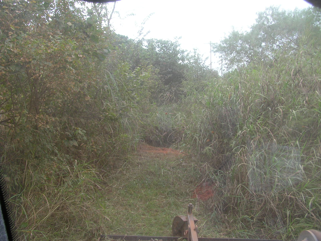

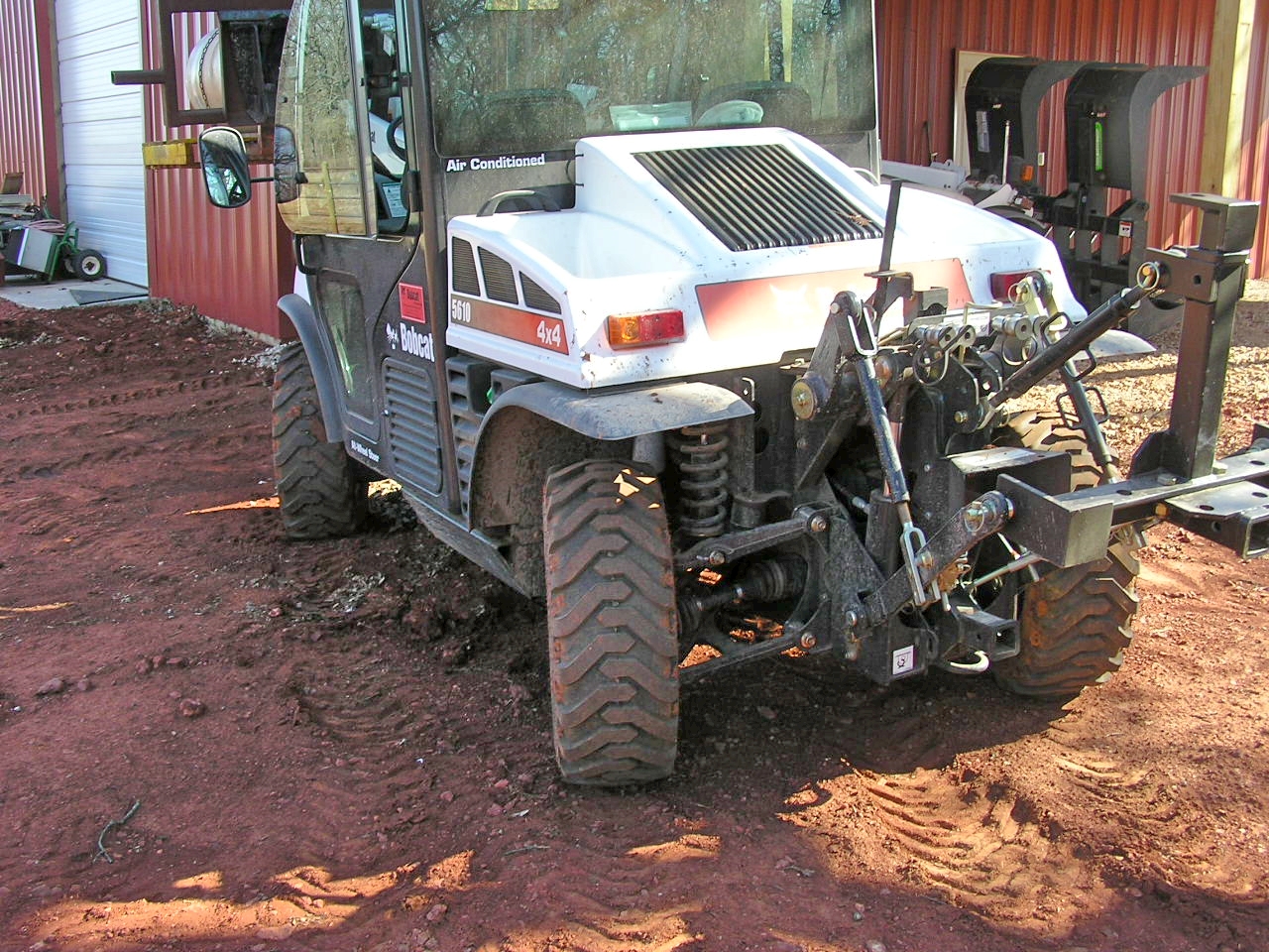

I love those tool cats. When you get a chance, could you give us the occasional update on it?
Time for the occasional update.
Toolcats don't have a Crab Steer switch like the telehandlers do, but you can do a manual crab steer.
In All-Wheel Steer, turn the steering wheel to set the needed angle of the rear wheels. Then switch to Front-Wheel Steer and drive it away from the fence you were against. :D
When mowing along a tree lined area, I offset the rear wheels to cause the deck to mow farther over, keeping the cab farther from the trees.
This is what it looks like moving straight forward with the offset:
